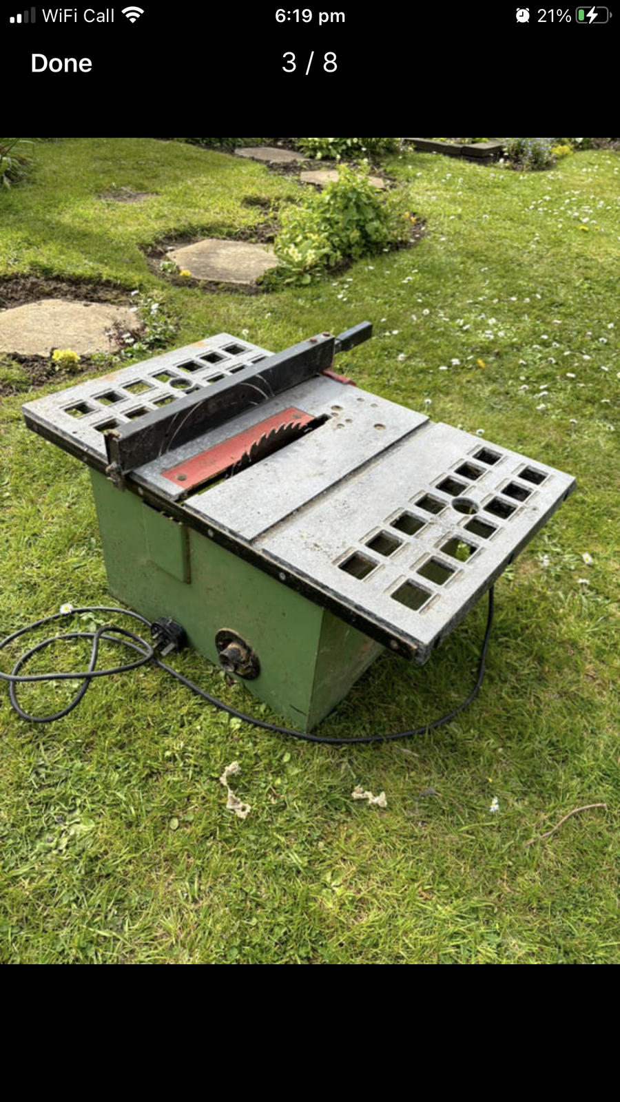

Okay, this saw was made in 2001 I think, maybe 2000, either way I brought the saw cheap offline, and it’s missing some “key” bits.
These bits are discontinued, or so it seems, so I am after your knowledge to see if I can either find what I need, a way to overcome this or to see if third party hardware will work.
I am after wrench for changing the blades. I have removed the old one, and replaced it, so not in a hurry now, but would like to have these for the future, thinking they may be even harder to find years down the line. I have looked online and found No. 17 on this website is not discontinued but out of stock. Either way can I get one for say a dewalt saw that would work with mine?
For the discontinued items, I am after a mitre gauge assembly, a riving knife and a manual. I believe I can buy a third party mitre gauge, and I know I can get a riving knife made both at home or professionally, but where could I find a manual for this old saw? Are there people who get these old saws and restore them, if so would they have copies of manuals? Do you know of such people?
If you know anything that could help, that would be great.

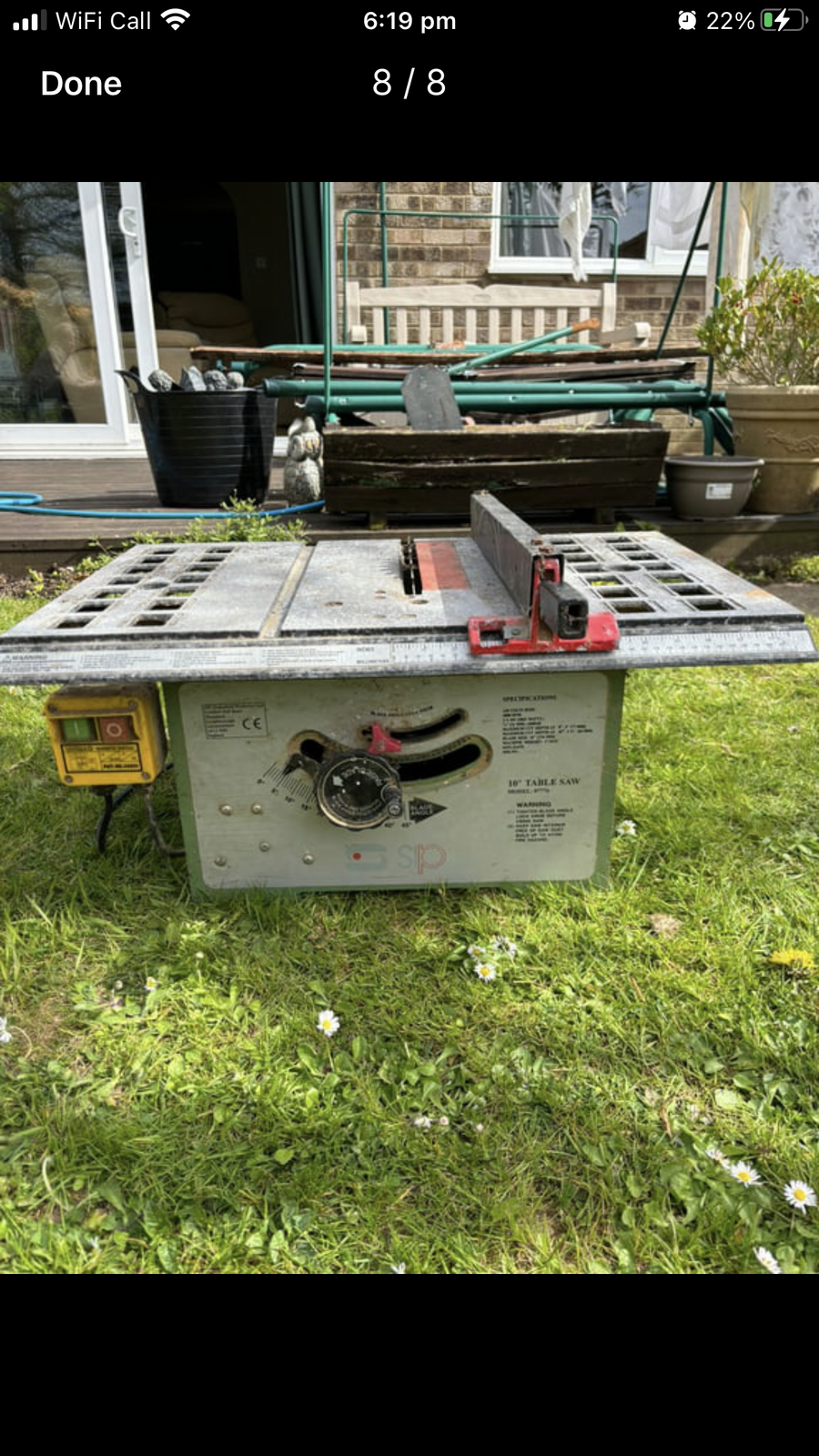

Oh, the housing for the saw is a little rusty, not great original green colour, I plan to remove rust, prime with a rust protection, then spray paint it blue, should I try and remove all the internals, or box and tape so the saws motor, brackets and wiring won’t get paint on? Should I re spray the table saw top or leave it? Also, the power safety switch, should I change it over from one seen below in the pictures, to one of these ones… https://www.ebay.co.uk/itm/232617574439 - I just did a quick google search for the type of switch I mean, not looked into one that will fit and install into the saw?!?
Cheaper, easier and safer to just stick that one back on Marketplace and buy another that has all the bits. It has no guard either, whoever sold it was glad to get shot of it and didn't care or know they were selling a death trap. It's a false economy buying these things without the bits, been there, done that.
As an aside it seems to me that anything older than about 20 years and you'll really struggle to find the manual.
Okay, I will leave the top free of any paints. I will just do the body of the saw.
I am just after the 2 main accessories or spare parts really, I have access to everything else needed for safety, I do have a few blade guards that would fit.
Switching the power switch over would be for safety, otherwise would not need to do this, it past basic pat testing.
I know I can buy a replacement mitre gauge, and I know I can get new and/or custom made riving knives I was just wondering if you knew of anyplace that did this that you could recommend.
I am trying to find owners, past owners and places like auctions, for the manual.
The switch you found is not an NVR switch.
NVR is No Voltage Release, meaning if the supply voltage trips off, when the supply returns the tool dies not start up again by itself.
That switch is likely more dangerous than the switch you already have.
Suggest you make sure you fit an NVR switch.

This is why I am trying to make the saw the best safety equipment I can, I don’t need to change the power switch over, but I am doing so, so it will be easier to turn off in an emergency.
I may have disabilities, I do take high pain medications, however I only ever do the dangerous type of DIY when I have a clear mind, pain is under control without taking the high strength pain medication, and I am fully supported by my mum, with one of my sisters available.
I am trying to take as much precautions when it comes to my status with additional safety from the tools required, so I don’t have a manual, the saw is old and doesn’t have modern safety precautions, however I am able to add these things onto the saw so it will be as safe as it could be.
I only need or I have missing is a riving knife, a mitre gauge/bar, a manual and the wrench/spanner’s to change the blades. I do have a blade guard, I am changing the switch over to a quick turn off.
SFK
Thank you for the heads up, this is not the switch I am going/or was going to use, it was just an example of a quick google search to show what type of switch I am after.
