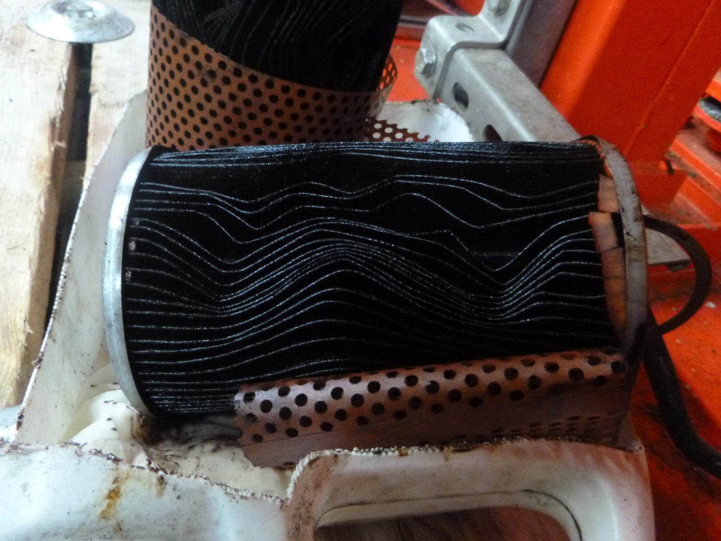

only if there is water in the oil/fuel.
here is a blocked fuel filter we had at work, all 3x engines have a pair of primary fuel water separators (10 micron) and 2x of these secondary filters, and all have only run for 50 ish hours (1 hour run per week).
the fuel pump suction caused the blocked filter to collapse and tear away from the metal end caps.
Blimey. I am assuming my pump wouldn't have the power to cause that. Also the boiler seems to be fairly efficient at cutting out when there is a problem. I've gone from cursing it for cutting out to thanking it (or the engineers who built in the safety features).

lol, yeah this wont happen on yours as you say it has a safety cut out. the above was from a lorry engine.
