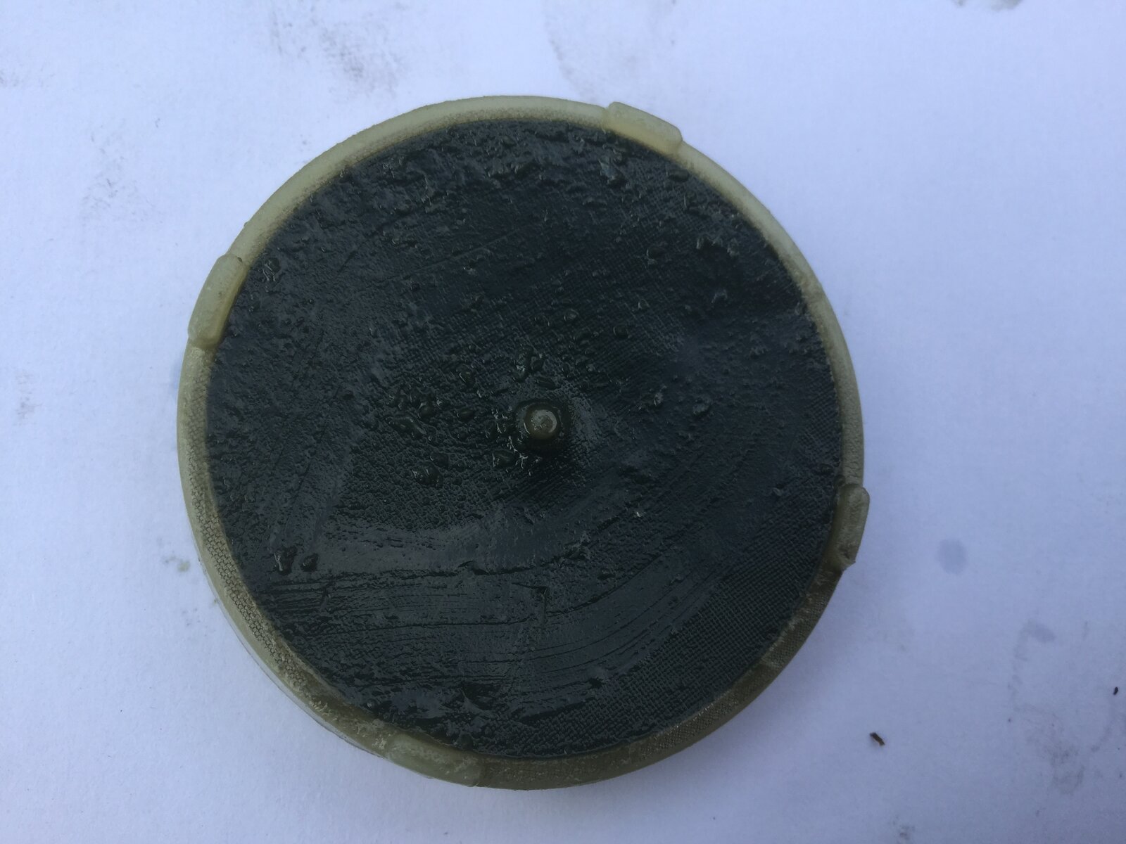

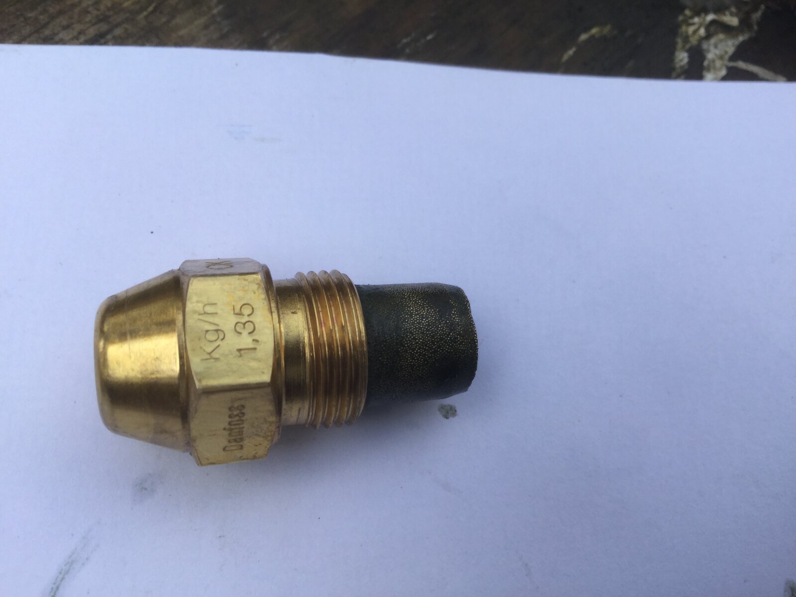

This is for information, in case anyone ever gets the same thing happen to them. I took off the new nozzle, and took out the strainer from the new pump, and this is what they looked like:
That looks like algae to my untrained eye. It was so impacted on the pump strainer I had to shift it with a thumbnail. The new pump only went in two or three weeks ago and the new nozzle only two days ago.
So I need an additive that kills algae I guess.
