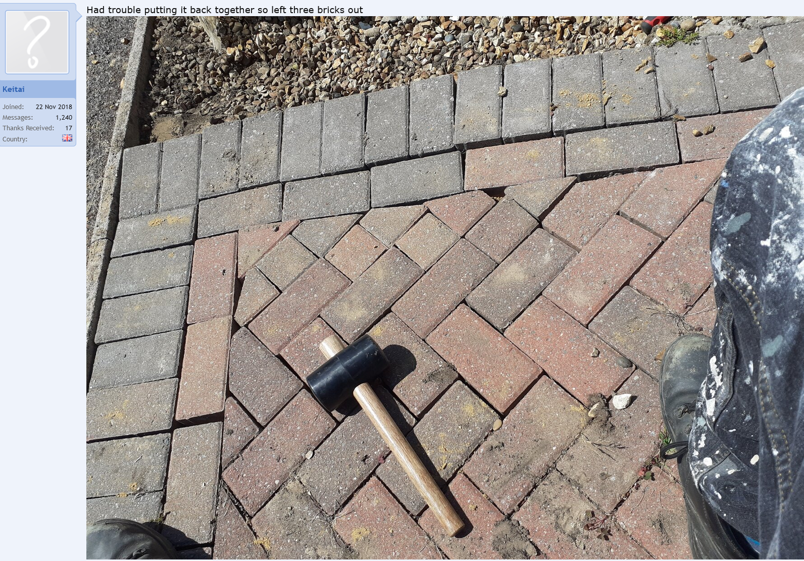

Look at the thread of the block paving he done, he made it worse!

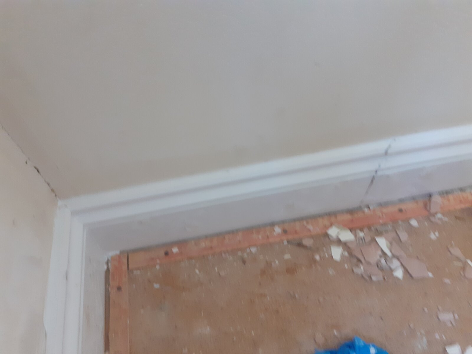

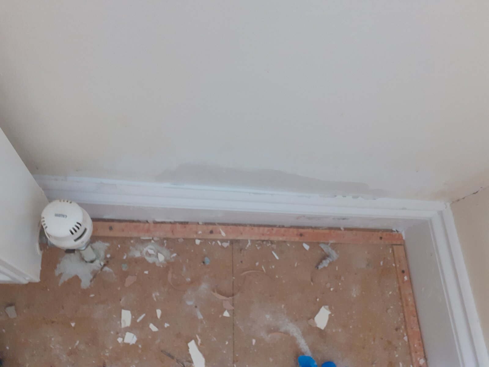

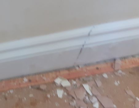

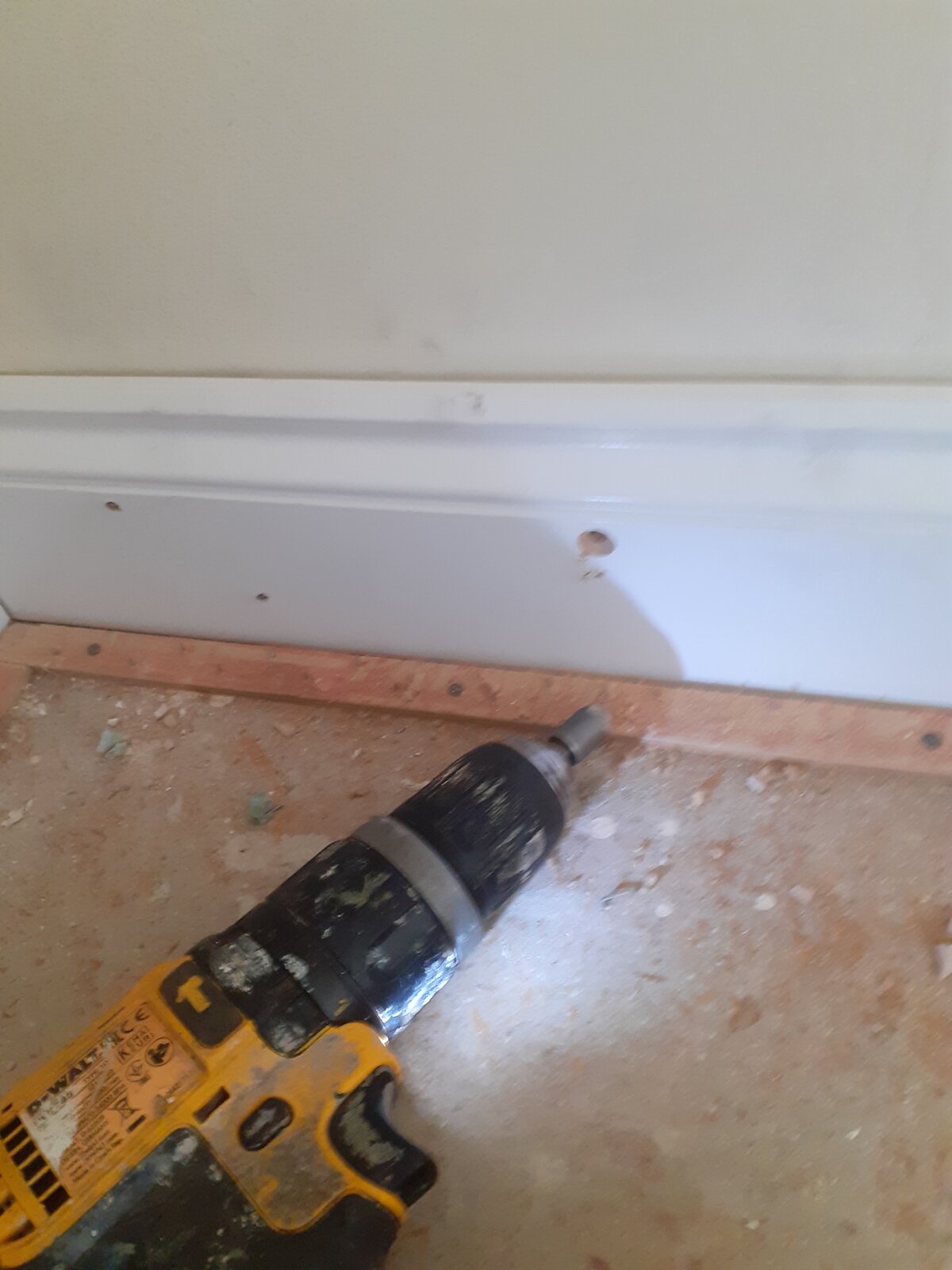

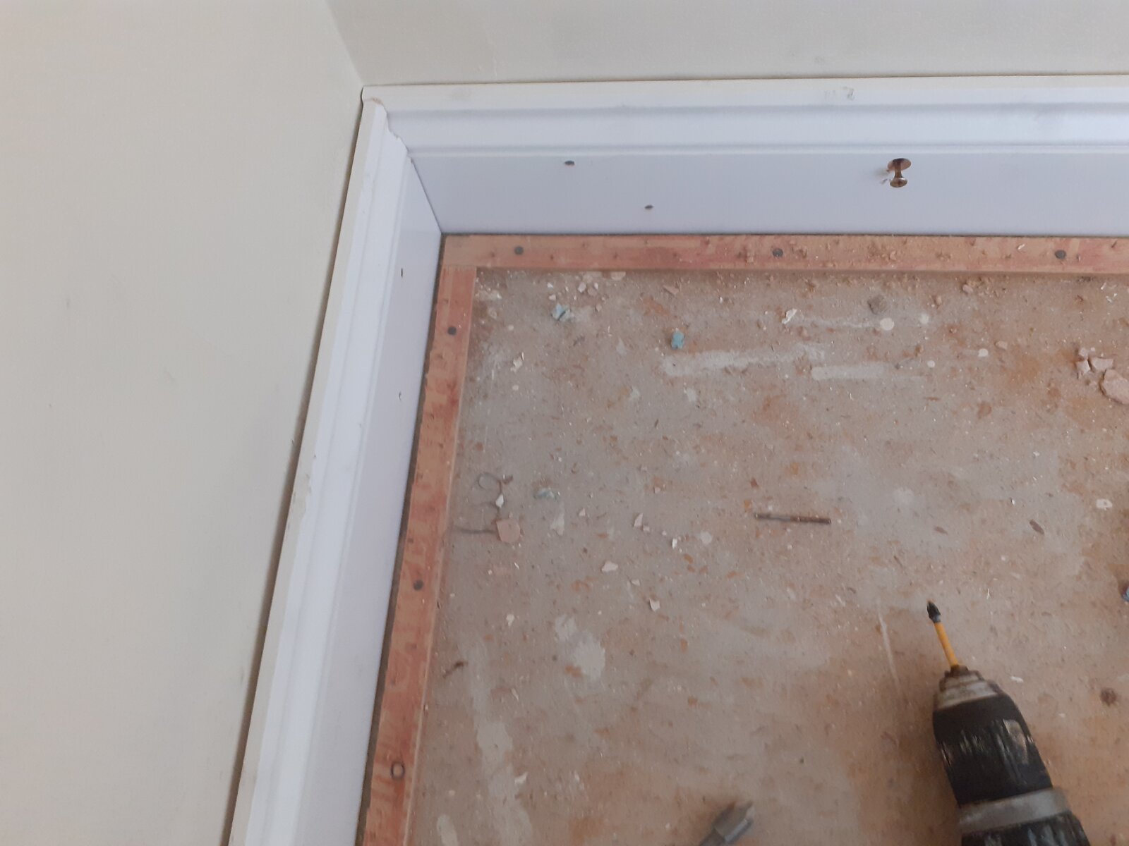

I plugged and screwed the skirting and it pulled it in except one wall on plasterboard and I just used lots of caulk on that.

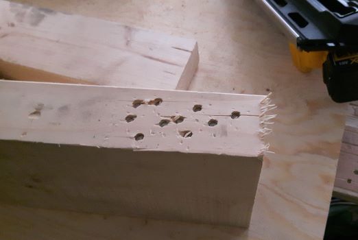

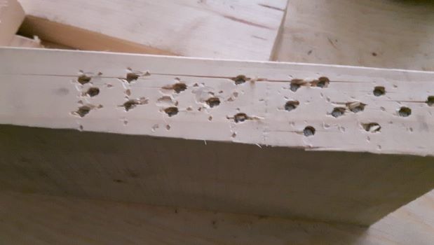

Do you seriously think I'd have kept a 1st fix gun for 5 years had it not been able to sink 90mm nails? Below are test results made using a run-in gun sinking 90mm ring nails through CLS into layers of 18mm spruce plywood, first in sequential (one shot) mode:
followed by a bump fire mode, same 90mm ring nails, same sort of timber:
Note how each and every nail is sunk well under in both tests. Now tell me that a DCN692 can't sink 90mm ring nails.
I wrote a fairly comprehensive review on the DCN692 5+ years back, precisely because I was hacked off with reading or hearing BS opinions ot the tool from sm**heads, and I still stand by what I wrote then. There are also references in that review to the DCN660 I subsequently bought. I never did get round to writing a review for that, though...

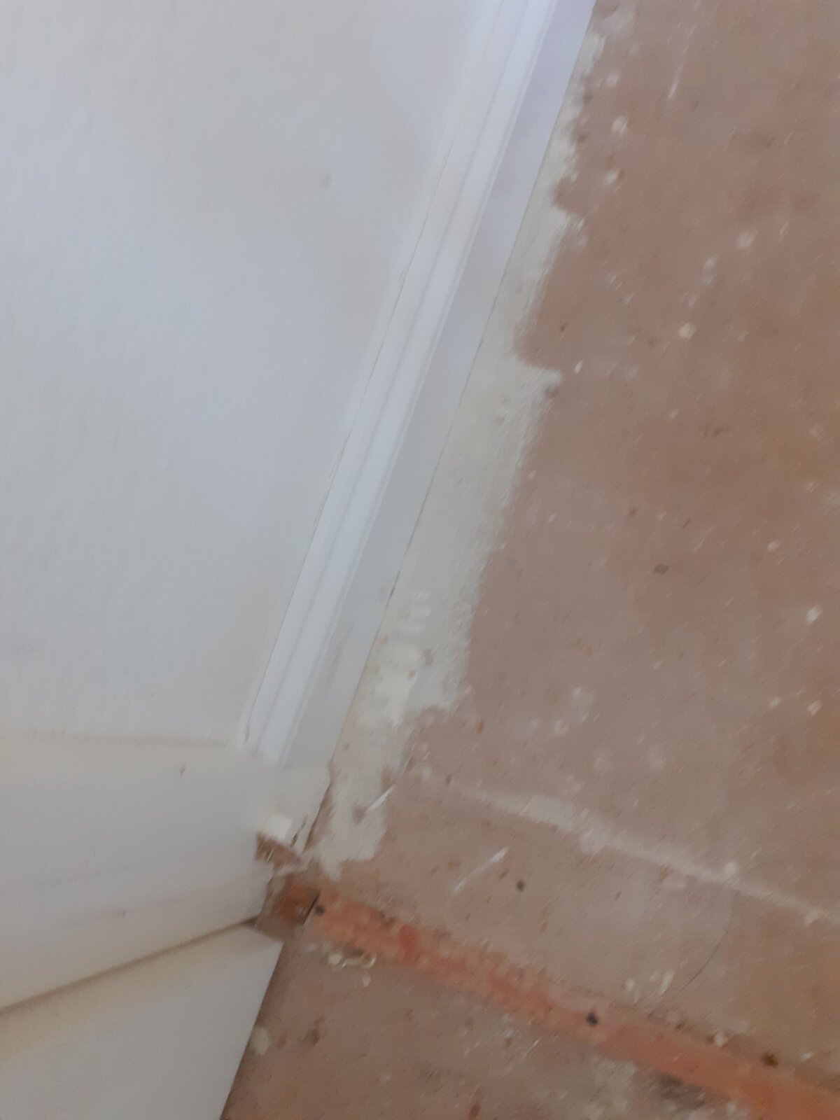

As an example`of work, take a look at this thread; TBH I've had 2nd year apprentices who could have done this job and known when to ask questions about the various gotchas (like that architrave the wrong way round, etc) if they weren't sure - but they'd have known to lift the carpet nail strips before starting (because leaving them in place is a health and safety hazard, plus it limits access to the bottom of the skirtings for fixings into the sole plate, as well as making it difficult to ensure that the skirting is bent/scribed to the floor, if necessary). They would also have done me neat, closed-up middle of wall mitre joins with no gaps (ever heard of Mitre Mate, or even just PVA glueing and nailing the mitres and sanding afterwards?) which didn't require a ton of filler, and they'd have put me TWO screws in, one above the other (a single screw as you have done isn't guaranteed to hold the skirting plumb or limit cupping)
This is extremely basic stuff that they get taught by the end of year 1 when they are with someone competent. And on the issue of site work a qualified man may have to put in 40 or more metres of skirting a day, including scribes and joins. Do you think you could do that? And do it well enough to get paid?
I notice you didn't ascertain what the wall was made from. FYI in order to get a fix you need to ascertain if it is dot and dab onto masonry (so long screws and plugs) or a stud wall (on which case locate the studs and sole plate). Caulking because you can't find a stud to fix to is a fail on an NVQ test.
Finally those screw holes need to be filled with 2-pack wood filler, mixed on a scrap of skirting/plywood/etc and applied with a flexible stopping knife. Once set hard (maybe 1 to 2 hours) you sand it back with a small sander such as a 1/4-sheet orbital sander, because you cannot hand sand 2-pack. Also see you bodged the filler around the architrave joint...
