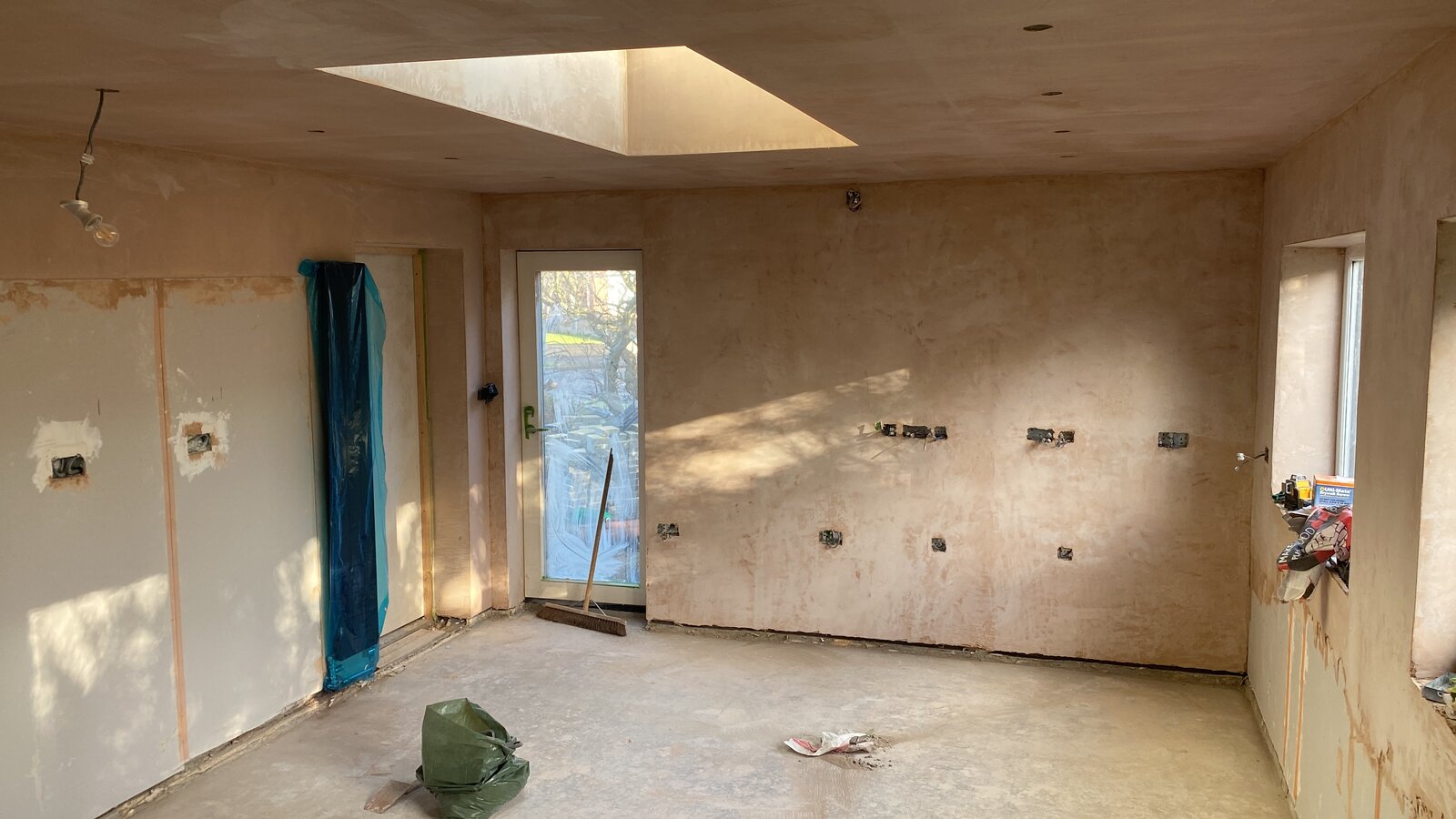

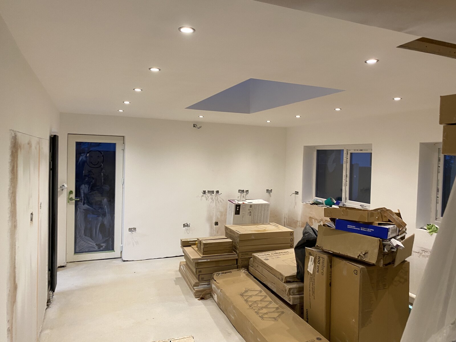

Time for another quick update. The time is now around December 2021, in fact I know I plastered the first wall in the kitchen on Xmas eve (much to my other half’s disgust!).

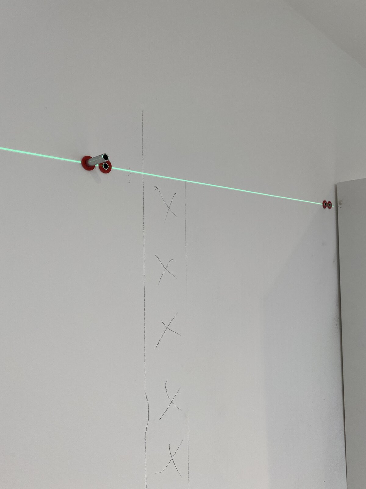

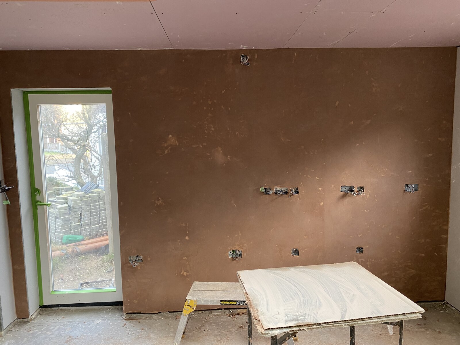

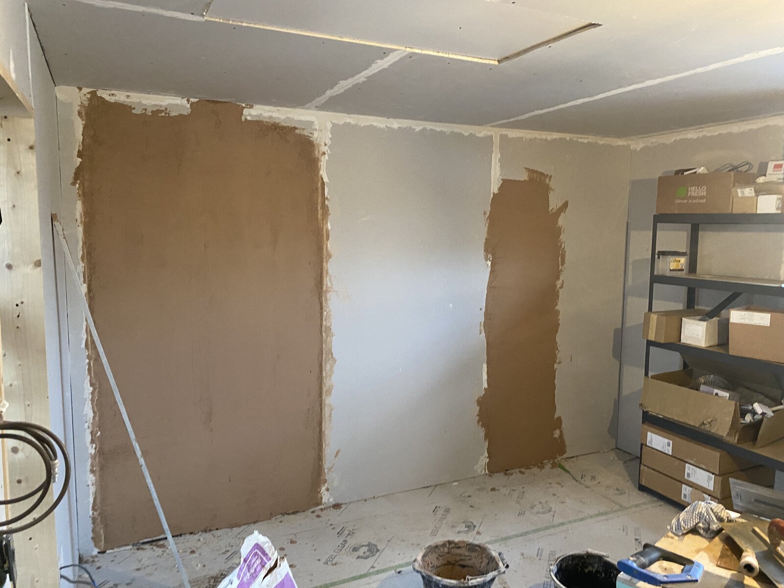

Turns out that despite using a big spirit level and ‘seemingly’ knocking every PB in plumb and level, the walls really weren’t level. In future I’d definitely use the expanding foam adhesive (I used it in the porch). Despite the extra expense, it’s worth it to reduce the mess and hassle of PB adhesive!
Not wishing to plaster wonky walls, a fair bit of bonding coat was used to level up using a straight edge, as you can see with the example below.
Then the finish coat went on, different wall I know - this was the first wall I did. I’ve plastered a bit before, and while it’s not perfect, with a little rubbing down it’s fine (and cheap).
Pushing on with the rest of the kitchen plastering, I have always hated doing ceilings so I bought myself a couple of extra tools - a 3ft speed skim, and a super flexible trowel. Both stainless steel Ox products. Both are amazing and really helped, especially the speed skim with I use on every wall now!
I didn’t plaster where the cabinets were going, to save me time and plaster!

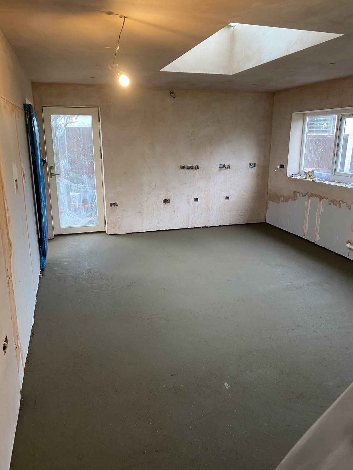

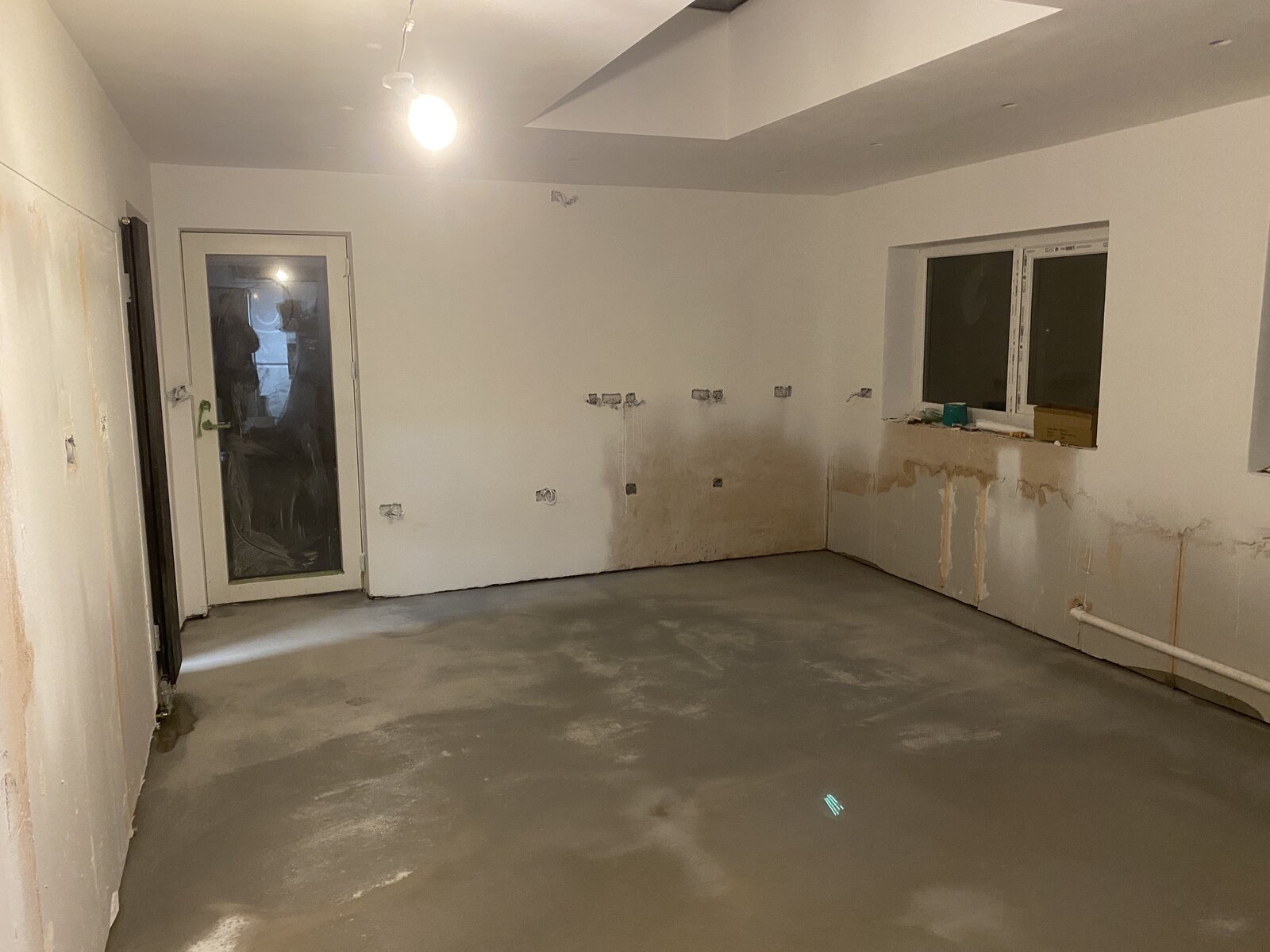

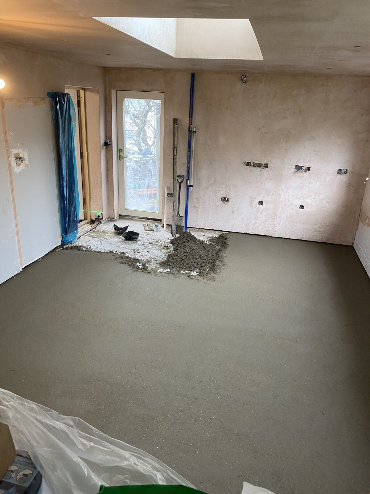

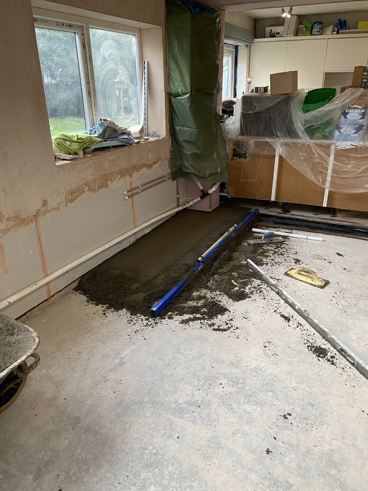

Next job was one I was dreading as I’d never done it before - screeding the floor.
I did lots of research online about quick mix/liquid screed, and I also got a couple of quotes for pros to come in and do it….everything was north of a grand. My local aggregate company could deliver the screed (3 ton) for £375, so I went down that route….
In hindsight, a helper on this day would have been great, but it was only me alone so I barrowed in 2.75t of screed and laid it myself too. Got myself a 2.4m Darby to help…
Working myself into the corner…
and finally, job done.
It was a full on day with the barrowing as well, but I was done by 4pm.
There were a couple of bits I wasn’t happy with in the end, but I decided I’d top it off with a self levelling screed anyway.
I did quick mist coat and two coats of k&b white paint and the room, then the self levelling screed and was transformed. I’d also purchased a Wagner paint sprayer, which once you work out the paint to water ratio, is a great way to paint a space very quickly.

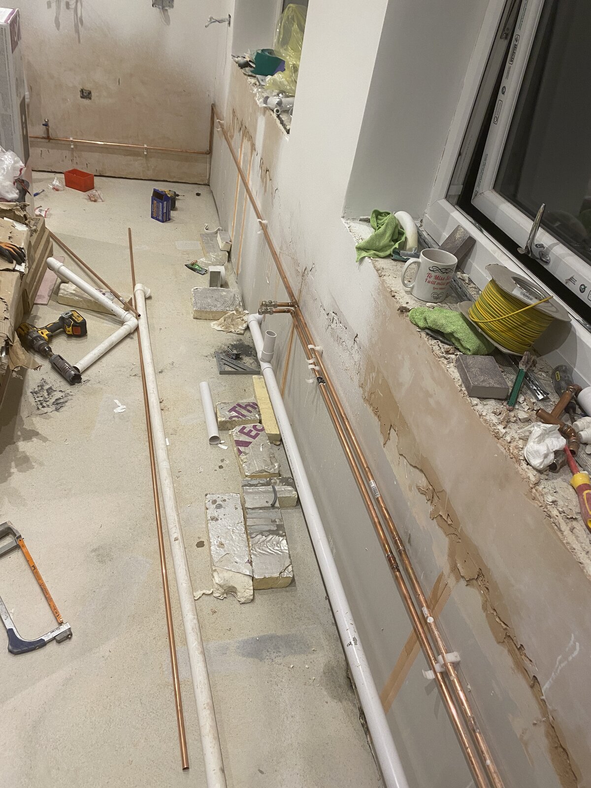

A few final bits of plumbing was done now the boiler was in situ, and then my very careful measurements were followed to cut the holes where the spots would go.
Finally ready for a bit of flat pack :D
Plaster, screed, self levelling screed and tools came to about another £1k. So total spend to date, £73k.

You're making great progress. Regarding the bonding coat of plaster how thick can you/did you apply it at the thickest point?
Blup
Blup
Thanks :)
To be honest, it wasn’t terrible with the bonding but clearly some of the PB didn’t align at the joints or there was a dip in a bit of the board.
To the eye they were straight, but there straight edge never lies! I’d say mostly the dips were 5-10mm that I filled. Any less just got plastered!
As I mentioned, I used foam for some of the PB when I did the porch and that was soooo much easier. I’d never use PB adhesive again now.

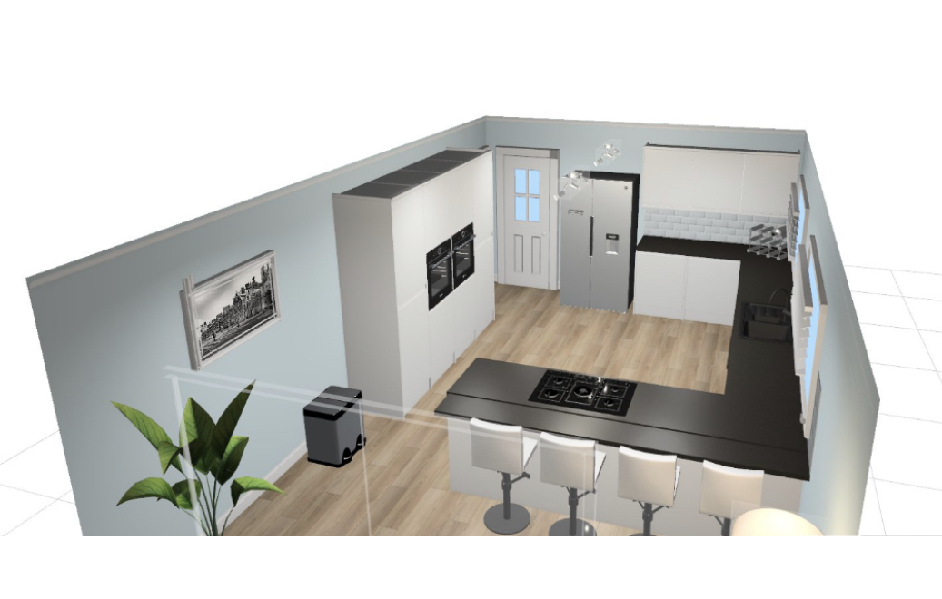

Fast forward to January sales 2021 and I stride into b&q confident I’d be needing my kitchen soon and wanting to take advantage of the Jan sales discounts. I think the kitchen designer liked me to start with, as I knew exactly what I wanted so the design stage was quick and easy.
However, she didn’t like me quite so much when it came to ordering as the £9k kitchen design above turned into less than a £3k order when all the doors, hinges, and appliances were removed.

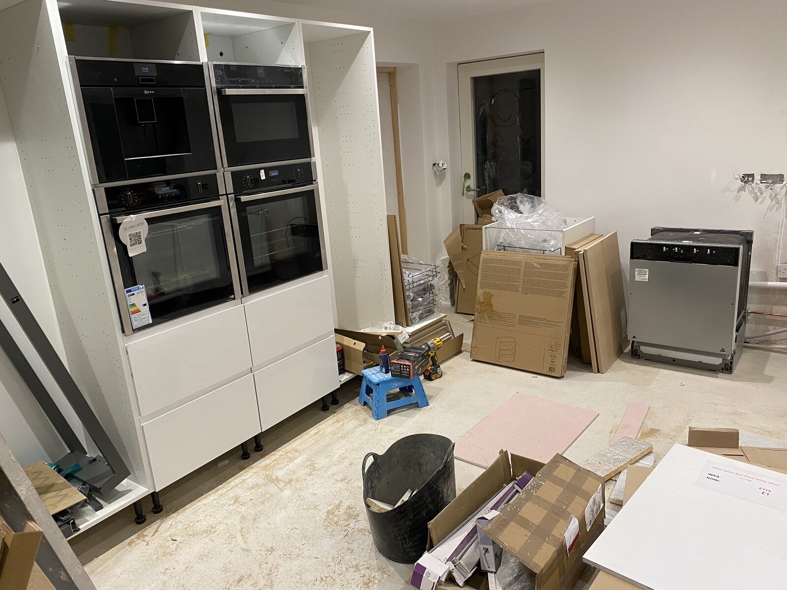

Clare likes a bit of flat pack, so with some help from her we quickly threw together most of the units.
I’d not realised you could get different heights of larder units, and we changed our design a bit to have 4 appliances (rather than 2) which meant I needed to drill my own holes for shelves in it. The microwave and coffee machine are a little high, and the top cupboard is small, but we accepted the trade off in order to have two deep draw below.
In the end, I needed to order all new handless doors for the tall units because I didn’t have the right ones from my original stockpile of doors. The new ones have a slightly different handle depth, but as the units are separate from the rest of the kitchen you don’t notice.
I’d also planned to have the integrated dishwasher and washing machine next to each other as per the above (dishwasher in situ), but at least with the appliances we bought you could not have the waste pipe behind the machine and have it flush with the doors on the rest of the units. The waste needs to go behind the next cupboard unit…same for the water connection too really. Therefore I needed to do some rejigging of pipes, and in the end the dishwasher got moved nearer the sink (under the window).

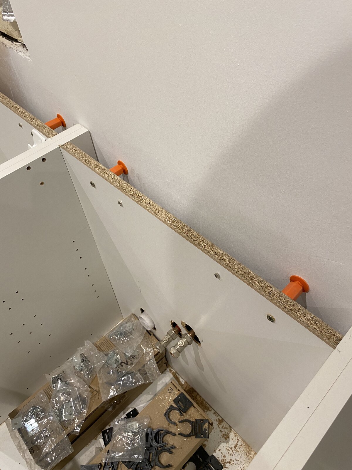

In fitting the cabinets, I used a load of corefix raw plugs (with reinforced metal tubes) to get through the plasterboard and into the blockwork). However, that was a fail because you need to use extra long screws to bridge the gap behind the cabinet and the corefix screws are only as long as the rawl plug. As they’re quite a narrow bore I couldn’t find any suitable longer screws to use.
In the end, I just used 200 x 6mm left over from the roof and buzzed then straight through the cabinet, PB and straight into the thermalite without any plugs. With the cabinet spacers, the cabinets are solid, so job done :)
I did use the corefix for the wall cabinets, and they’re great for that purpose. Be sure to mark out when your wires are!

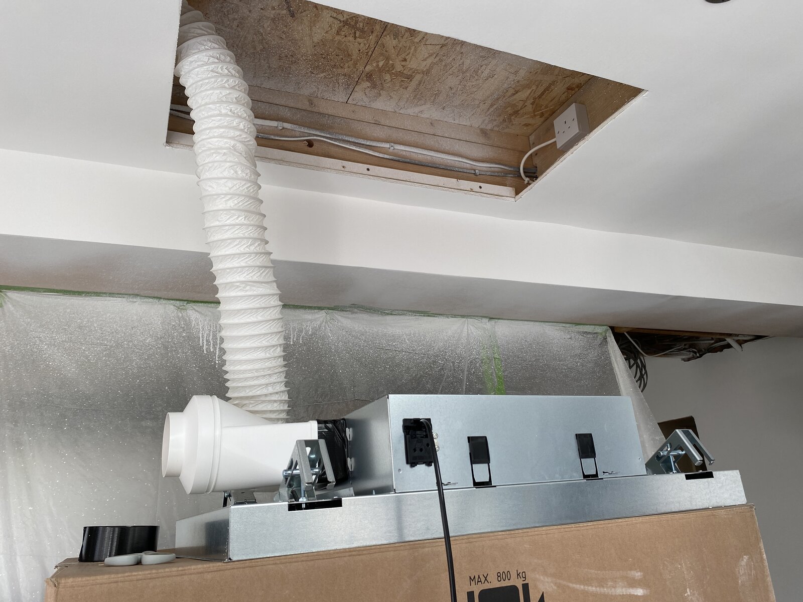

I’d also left a gap in the ceiling for the flush extractor fan. This had required some precision measuring as the lip that Neff put on the appliance was only 3mm so not much margin for error. I had made the opening slightly undersized so I ended up shaving a little off, but better that way round than the other! It was ruddy heavy, but here it is about to be hoofed into position.

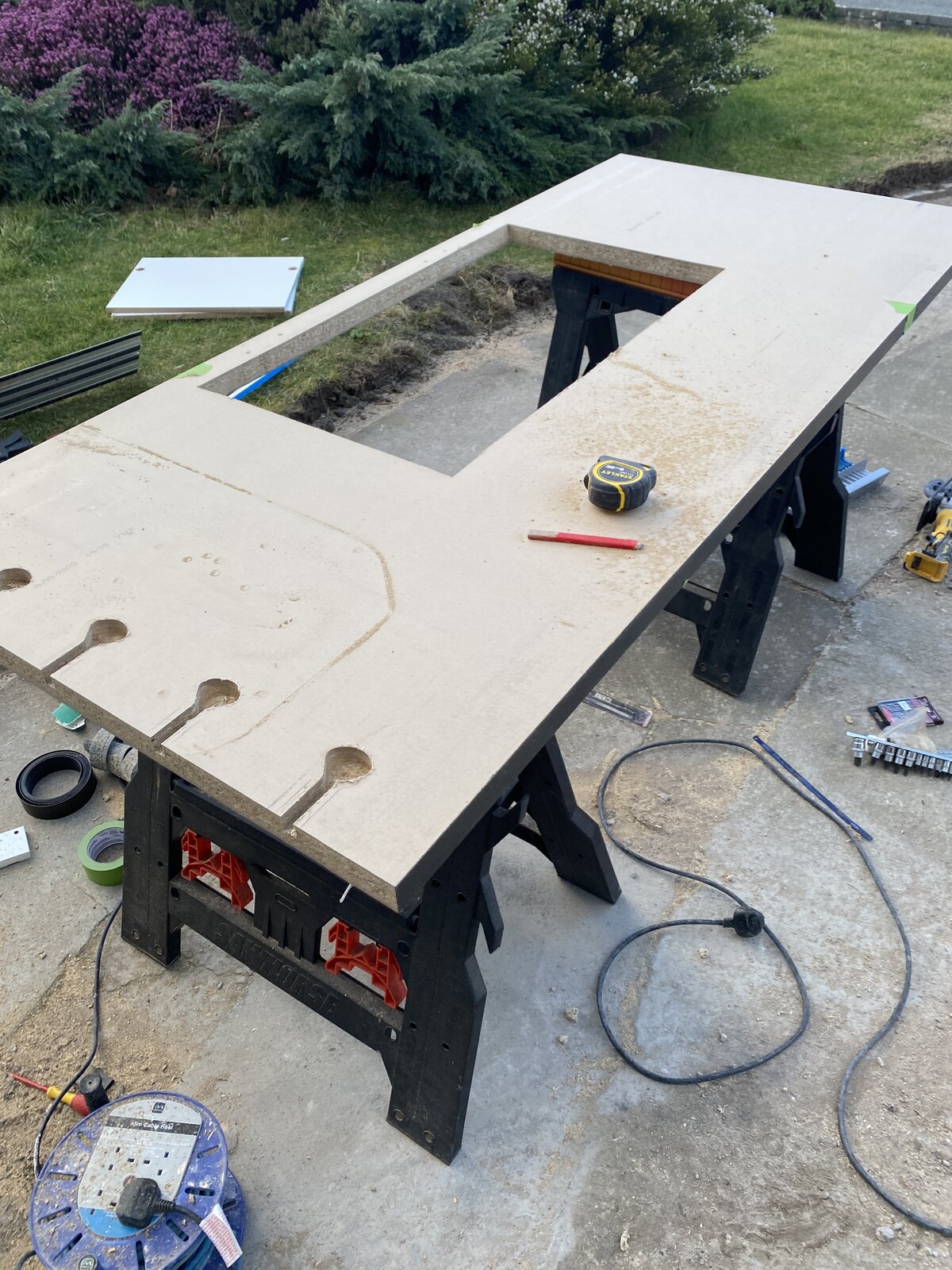

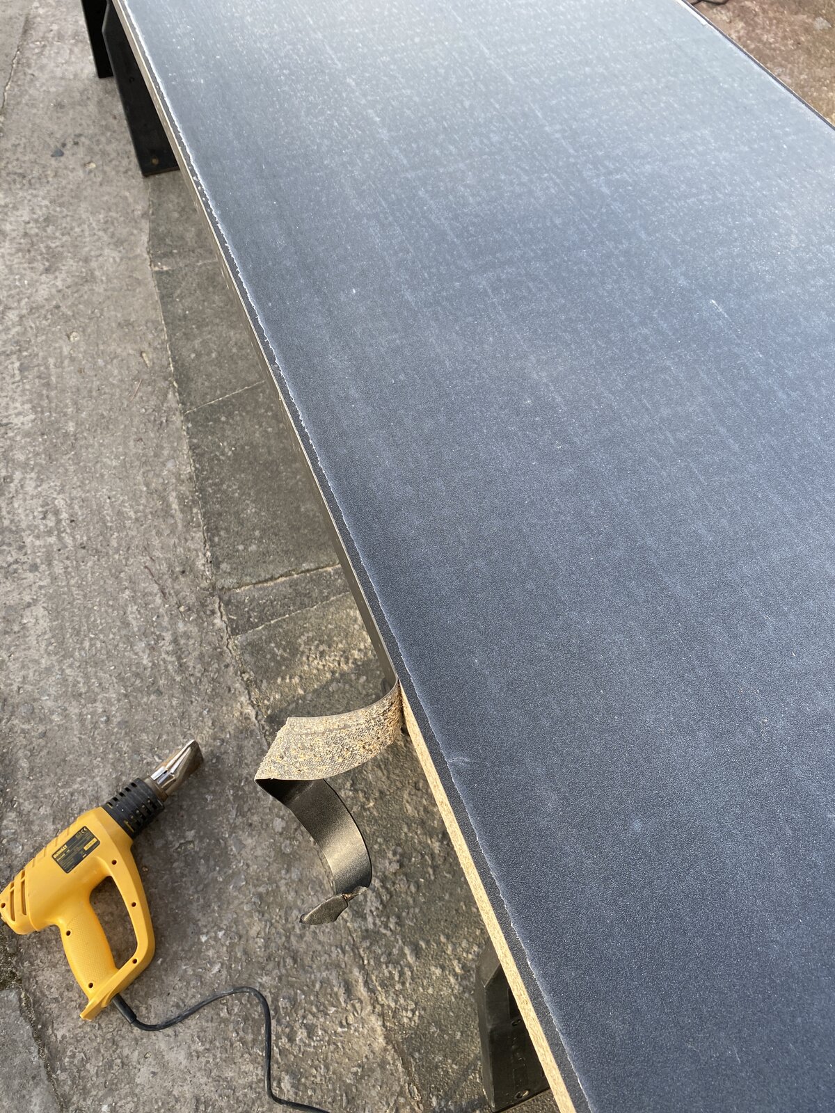

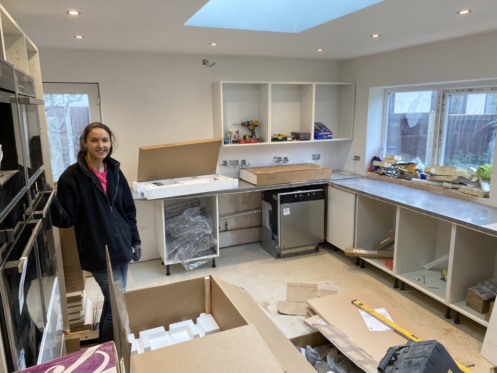

Next were the worktops. I opted for laminate ones as we may not stay in this house long term so didn’t want to extra expense of granite.
The square edge worktops look smart (in my view) and the real bonus is for corners you can just peel back the edging (using a heatgun) and only need to route then for worktop bolts underneath rather than those male/female cuts.
Then the scary part was all the cuts etc on the breakfast bar for the hob and the connectors. I found using masking tap the mark everything up was really helpful. Also cut with the nice side up to prevent chipping the laminate.
Needless to say there was a lot of cardboard for recycling from all the kitchen units and applicants. I actually did two runs to the tip like this!
Kitchen still isn’t finished as I need to do the floor and the tiling, but we’re using it now.
