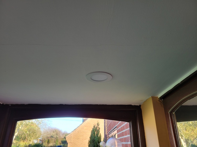

i have these in my porch ceiling and they are nice and bright and virtually the thickness of the plasterboard

FYI this is what I have in the porch , I think they were 3w and the cutout was about 70mm easy to get the driver into place and to access the cables

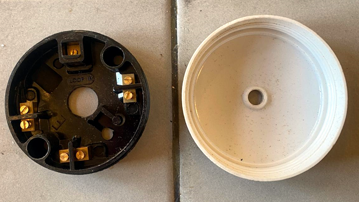

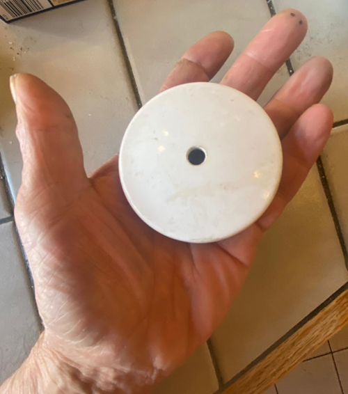

This is the smallest 'rose' that I seem to have on 'my shelf' - about 68 mm diameter and 18 mm 'high'. Although undoubtedly sold as 'a rose', it's not really quitre a 'rose' in the sense that we expect today - it's really '4-pole' JB with a screw on cover which has a hole in the middle - but would do the job.
but the hole in the middle is for the lid fixing screw so if you cover it with a fitting how do you fiit the lid or get a cable out to the fitting
I suppose one advantage of using a rose is that it would be very familiar to anyone who subsequently had to replace the light, whilst any other approach might cause them to 'scxratch their heads' at least a little :)
the green lighting connector i linked to above is effectively a ceiling rose connector with the appropriate number of terminals just a different shape and intended to be connected and put above the ceiling with a cable/flex to the light just as a rose has a flex to the pendant
You misunderstand. It is clearly intended as a rose in that the cover just 'screws on' (threaded around the perimetrer of the lid, as with a conventional rose), and that hole is for the cable to exit through (not for a 'cover fixing screw'). It only has 3 pairs of terminals (one pair labelled "E") plus a single terminal labelled "loop" and has a thingy to wind the outgoing cale around to provide some degree of 'strain relief'.
Yes, I understand all that but, as I said, being 55 mm x 22.5 mm, it would require a hole of at least 60mm diameter in the ceiling, which i was trying to avoid.
