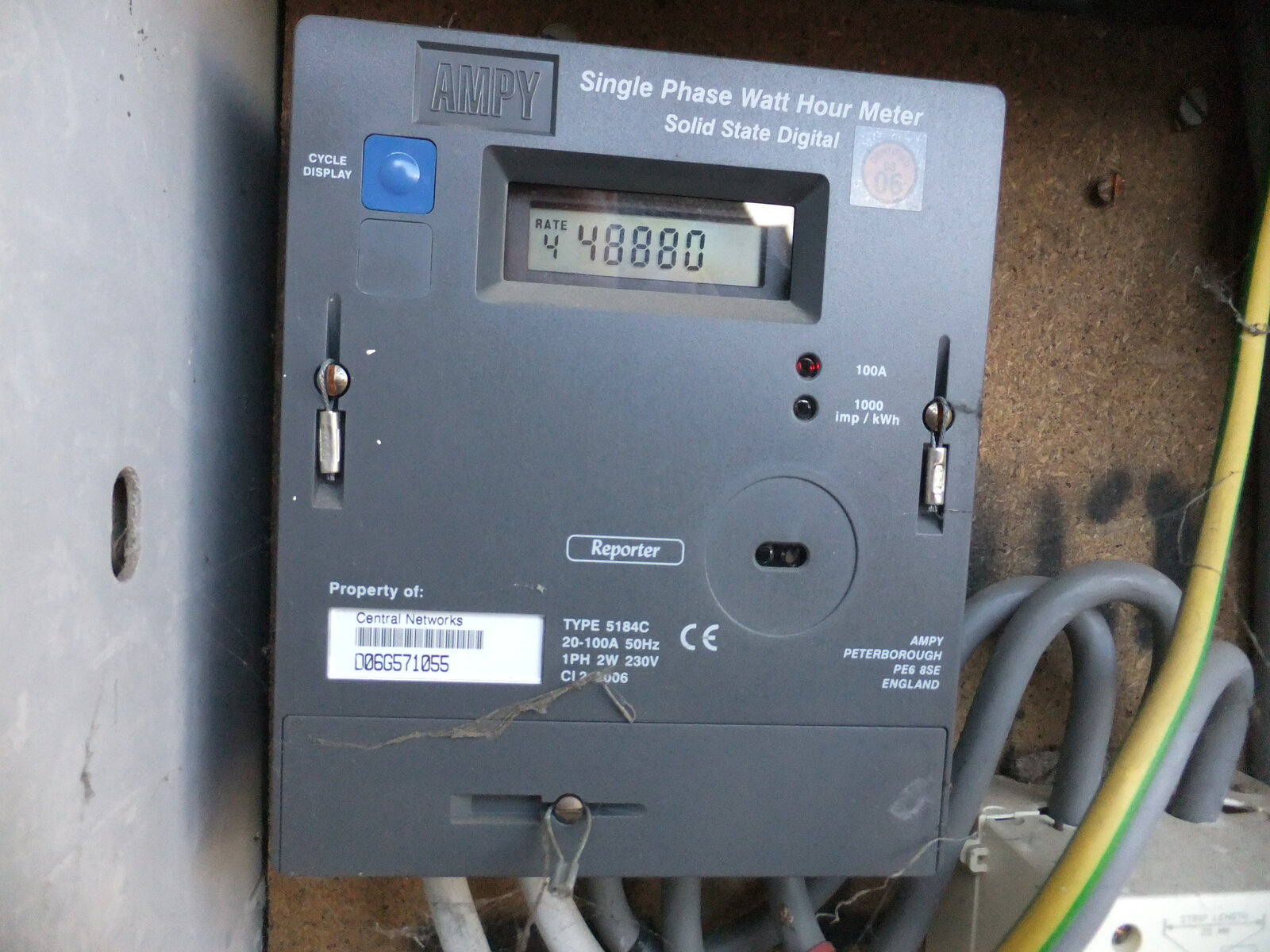

If it helps we have an AMPY meter, picture attached. After the END cycle the numbers start again with RATE 4, the one shown.
There is nothing to show which is DAY or NIGHT rate, we have always used the previous occupiers numbers and the energy company has never queried them. Can anyone please explain how this meter works/reads as I can't find it on Google.

Your not alone, I have a smart meter, it has a button to scroll through the multiple displays, and I have failed to work out what they all are.
It seems the installer should have explained, but failed.
