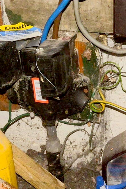

* I say "fitted" in the loosest meaning of the word. It was a mess, and whoever did it clearly had not been taught that terminal screws are intended to be tightened :whistle:

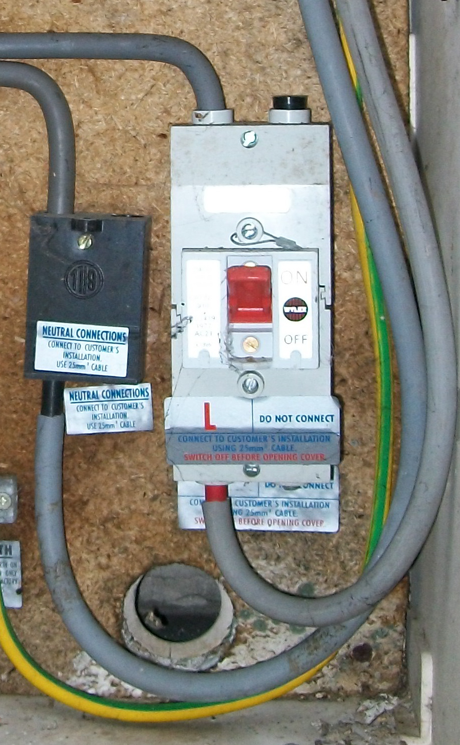

This is the set up with one phase disconnected - the space for the fuse can be seen - a dedicated 2 phase head.

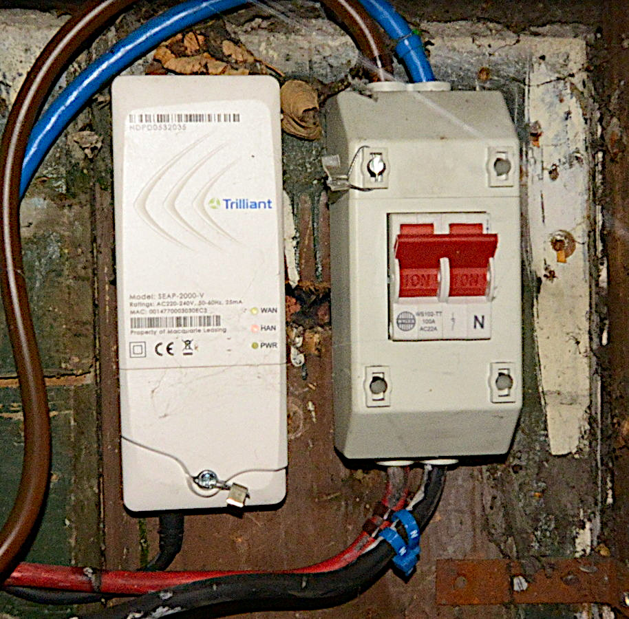

And this is the isolator just fitted to the smart meter when that was installed
Which shows another problem. An electrician that looked for CU upgrade wants to fit a new backboard.

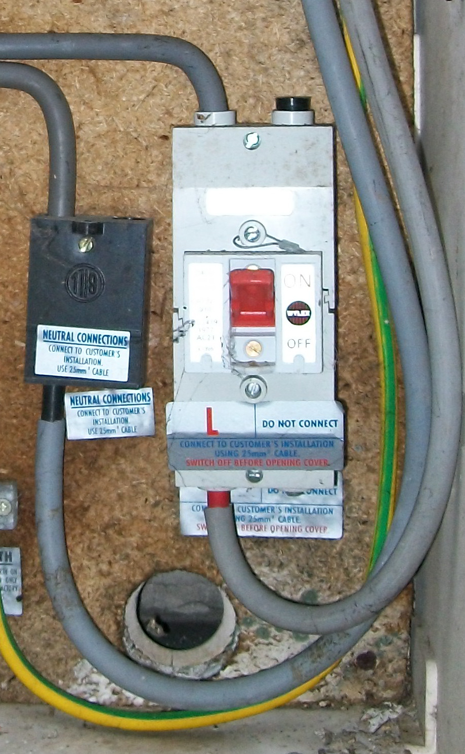

Curious isn't it. There's clearly different policies in place - and not just across different DNOs. In our rental properties, there are isolators with one pole marked "do not connect" and a separate henley for the neutral. While in our house and at church, both line and neutral are switched. Both in the same DNO area, but I guess this is a meter operator thing rather than a DNO thing.

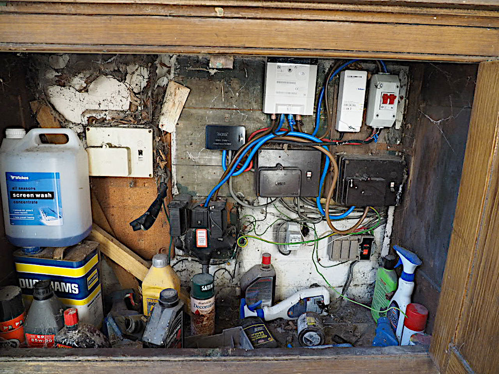

And if you're thinking that backboard shows signs of water damage, you're correct. From an early age we were taught that electricity and water don't mix - yet we insist these days on putting unsuitable electrical equipment outside, protected only by a flimsy plastic box that often ends up with the door flapping about.
Well he can't :p It's not his board to be fitting a CU on anyway, so if the DNO and meter operator are both happy with what's there, it's not for the electrician to be changing it.

That white thing next to the isolator appears to be the bit that does the coms back to base so the actual smart meter isn't that smart. The bottom of the meter display can just be seen
:censored: This what I am left with - economy 7 x2 disconnected by the suppliers some time ago.
o_O I have been told by the electrician that looked that I shouldn't put various things in the cupboard. From long ago as far as oil etc goes - an ancient Shogun used to tow a caravan and since then out of site out of mind but did add the screenwash a few months ago.

If you look at the top of the meter in the shot you can just see the start of the display, it's darker than the rest ;) I'd have had to lie on the floor to get it all in,
