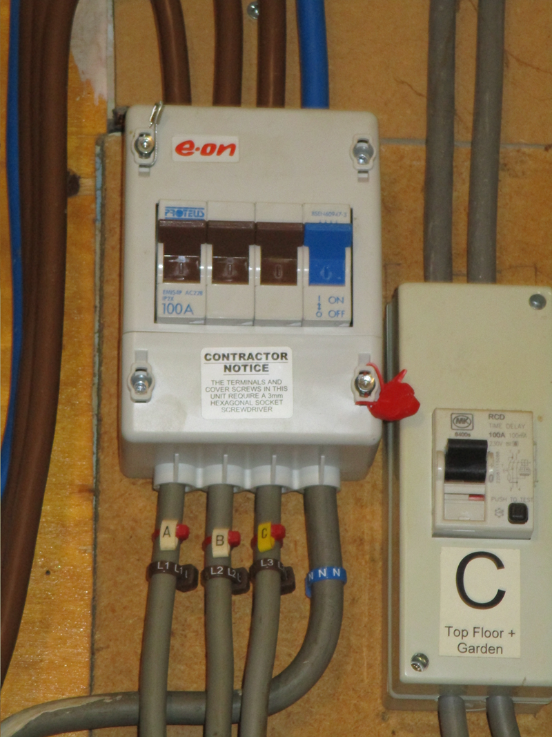

For what it's worth, when they installed mine, they put a 'proper seal' on the supply side, and a Mickey Mouse plastic one on the load side - I guess to discourage non-electricians from 'tampering' with it. However, it's clear than anyone could remove those plastic seals (and would be under no obligation to replace them with anything ...
Kind Regards, John
Edit: where did my piccie go? - I'll try again in next post
Second time lucky? .....
I like the notice on that, surely any self respecting bodger will always use an appropriately sized flat head screwdriver - you only try a hex key after you've chewed up your screwdriver and the screw head :whistle:
Yes, it is a rather intriguing label!
Kind Regards, John
BUT... it says 'socket'.
From that I'd expect to find a male hex head [like a nut] however the picture looks like it's a female hex head.
The Proteus unit I fitted had female Torx heads.
I think we can interpret it as meaning a "driver to fit a 3mm hex socket". Not well worded, but not "non sensical" either.
What is annoying is when faced with "imperial" hex socket terminal screws and you only have metric drivers with you. A 6mm hex doesn't fit very well in a 1/4" socket - there's a limit to how much torque you can apply, but fortunately that was enough.
Agreed - I was in no doubt as to what it meant (once I had looked at the screw head). However, as you will know (e.g. as per a current thread) there are some for whom the argument "we all know what it means" doesn't go down very well :)
