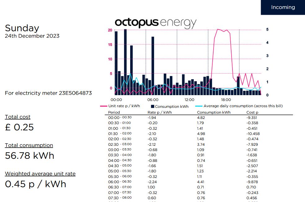

Fwiw, I averaged 15.86p /kwh hour on agile between 25Nov-24Dec. Thats without solar or battery storage atm, but with an electric vehicle and running the washing machine and dishwasher on the cheapest periods.
Best day was Christmas Eve when the winds were blowing, and I ensured the car was properly charged, caught up on the laundry, and cleaning and preheated the floor in the conservatory for the next day (Its got quite a high thermal mass, takes ages to heat up and stays somewhat warm for quite some time) Still supprised that I magaged to use 56.78kwh though!

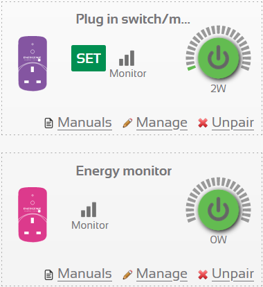

But electric it is so easy to see in real time what I am using without a smart meter, I have two computer linked plug in units 1704018569235.png so I can see what each appliance is using, at moment looking at the heat pump tumble drier, and how much power per month used seems around 18 kWh used this month. I also have one not linked to PC, and I have a couple of clamp on meters, plus the ones fitted for the solar panels and the iboost+ so I can see how much I am using without any smart meter, can't clap my hands to turn lights on/off as in the smart meter adverts, but hey google will turn them on/off with voice control. Not sure I want to turn lights on/off by clapping hands, and I think that function is an outright lie, I don't for one minute think once fitted I can turn lights on/off by clapping hands, it just makes me wonder with such out and out lies what the real reason for smart meters is? And what the ASA is doing allowing the advert.
