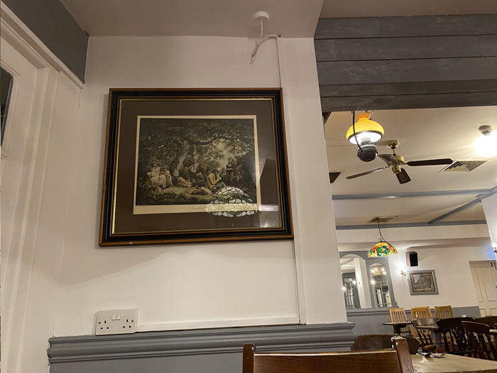

Hi folks. I realise the the person who would probably have most interest in this does not appear to be any longer with us, but ....
.. I recently stayed in a hotel which started life as an 18th century coaching inn. Whilst sitting at my table in the restaurant, I found myself just adjacent to what is shown in photo below. I suppose it may not be 'as it seems', and the cable in surface trunking may be related to the fact that the building is listed, but the (double) socket is certainly in a location which (in contrast to the situation in a loft) is probably quite likely to be used by a cleaner to plug in his/her vacuum cleaner.
Any comments? :)
Kind Regards, John
Is there another floor above? Could be a spur from the socket above.
Bodgery we find nowadays, oh it never gets old! Diy Dave might have been there.
Yes. It seems to me you are just guessing. :)
Sure, guessing about some things. However, as I've just written, there is no guessing involved in observing that the socket appears to be supplied via (seemingly quite 'thin') flex which is emerging from a ceiling rose.
Would you regard what we see (not guess) as 'acceptable'? I'm sure that there are some who would point out that a ceiling rose is not 'rated' for even 13A (if a fused spur from a sockets circuit) let alone 20/26A - and that before considering the adequacy(or otherwise) of the flex.
Kind Regards, John
It does seem like the ceiling rose is feeding double socket. However the ceiling rose may be fed from a socket circuit.

It could be - but you are usually the first person to comment about the 'rating' of ceiling roses, aren't you?
Anyway, if it really were being fed from a sockets circuit, why the ceiling rose, and why flex?

Probably ... but how coded, I wonder? It wouldn't surprise me at all if it had been like that at the time of the last several EICRs/PIRs ;)
As a matter of interest, how would you (or others) code it ... (a) if it is coming from a lighting circuit, (b) if it is a fused spur from a sockets circuit and (c) if it is an unfused spur from a sockets circuit (in all cases assuming that the flex is 'adequate' - which I'm not convinced is necessarily the case)

a/ If it's on a 6A circuit why would it require any code?
b/ correctly sized fuse for the cable why would it require any code?
c/ if the flex is the correct size for the OCPD why would it require any code?
Well, unless one can successfully argue that the 'design current' represented by a double socket is 6A or less, the situation would be in violation of 433.1.1(i). That's why I find it rather odd that the regs explicitly allow BS1363 accessories to be connected to a 'lighting circuit'.
One might expect that, n a hotel, the lighting circuits might well not be 6A, but even 16A would be questionable if the 'load'were a double socket.
If we're talking about a 13A fused spur, then eric would presumably point out that ceiling roses are not ';rated'; for 13A.
Similar to (b), but worse. Ceiling roses are certainly not 'rated' for 20/26A.
