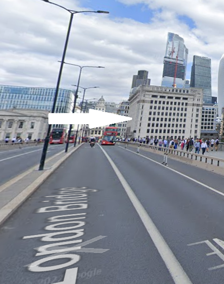

Apologies I didn't give the whole details.
M&E contract awarded to a major British company, I can't remember who but along the lines of N.G.Baily, Laings etc, they subbed out the electrical work to a less well known British contractor who in turn used an agency to secure the tools guys, they seemed to be of all nationalities. The instructions being to use trunking and conduit. The job was installed with a 'backbone' of steel trunking but mostly rigid and flexible plastic conduit and flexible cable, not singles.
