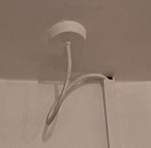

Socket for vacuum cleaner from lighting circuit?!
The ceiling rose could simply a neat way to conceal the cable entry or exit from the ceiling. It may not be connected at all

I considered that possibility, but it would seem unlikely. They would only have had to increase the length of the trunking by about 1 cm for it to reach the ceiling, where there is actually a hole (which has not been 'made good' - see photo) - and it's very unlikely that, in that position, it was a pre-existing rose which they used as a 'grommet'. In any event, that wouldn't explain the use of flex - would a 'proper electrician' use flex to wire a permanent socket?

If it was from a socket circuit surely it would have a box and blank plate with a spout and yt2 from that.

It could have been done in all sorts of ways, but what I appear to be seeing is not one of the possibilities I would have expected.
Given all that we have heard from our 'absent friend' about ''vacuum cleaners in lofts', I though this was rather interesting - because I can't really think of any reason why they would have installed a socket in that location other than for vacuum cleaners or suchlike!
Flex is as valid as any other cable. Regs allow its use as fixed wiring.
I have seen many a socket fed with flex in supermarkets.
