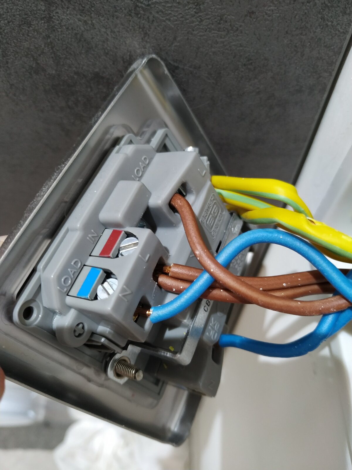

So we have been careful to run one appliance at a time. However, after doing 3 loads of washing / drying today the 13amp FCU failed and tripped the consumer unit. Can it be replaced by 20Amp double pole. Or best for someone qualified to look into it?
I couldnt remove the fuse out of the old FCU. Hacking away with a screwdriver the plastic looks to have melted, so presumably it has ruptured.

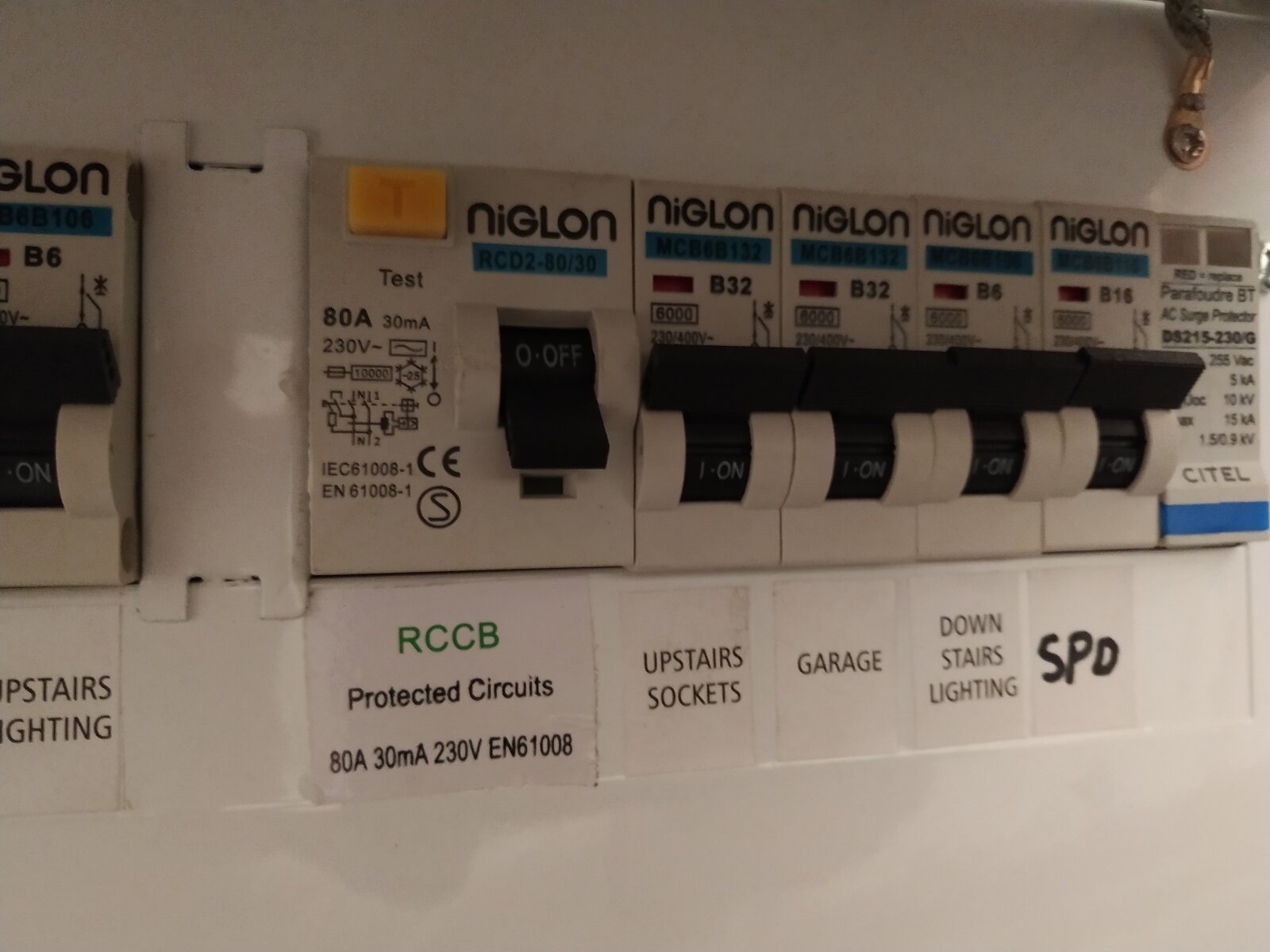

Do you know which circuit the double socket and FCU are supplied from, at the consumer unit? Could you post a photo of it, the double socket, the FCU, and anything else you think relevant?

Picture of the double socket, FCU and consumer board. Not sure which circuit it's on, but it trips the switch to left which is down.

The one which is down, is an RCD. Which means either the live or the neutral, on any one of those circuits to the right of the RCD, has a leak to earth of greater than 30mA. The cause of which, could be absolutely anything fed via that RCD - the wiring buried in the walls, the accessories (sockets, switches, ceiling roses etc.), or anything plugged in. It could even be an accumulation of leakages, of several sources. So likely you can look forward to some fun, tracing the cause...
Your best way forward, is to plug a low wattage table light, or similar, into that double socket, turned on, into which you plug the drier into, and simply work out when the light (and it's socket) goes off - and decide what you were switching on, or off at the same instant it went off.
