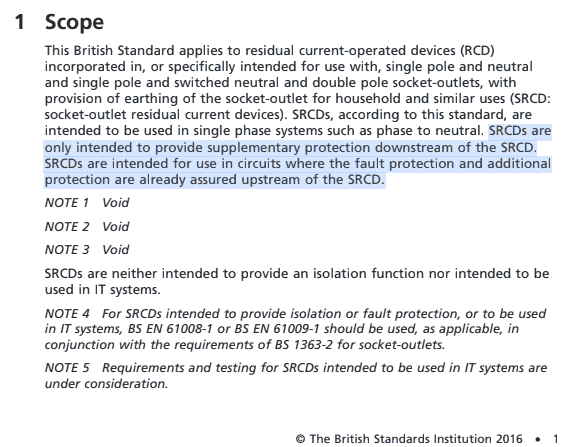

Found it :)
The suggestion (from flameport) was that the Standard for RCD sockets appears to require that there is also additional upstream RCD protection (which, as he says, would essentially make nonsense of RCD sockets). He wrote:
RCD sockets make no sense at all, as the standard for them requires that they have upstream RCD protection.
... and then ...
Scope from BS7288:2016
Fault protection (MCB/fuse) and additional protection (RCD) required upstream of the RCD socket outlet.
Not intended for isolation either.
That part is included in the preview at https://shop.bsigroup.com/ProductDetail/?pid=000000000030337151
