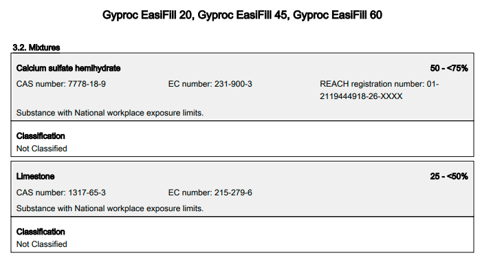

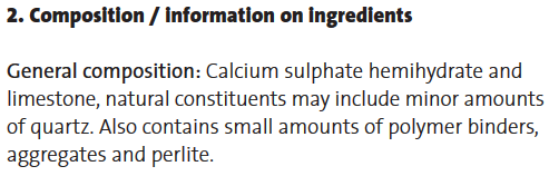

I briefly had a look at the specs for Gyproc Easi-fill and Toupret interior filler earlier (as I believed that was the recommendation) and the only apparent difference seemed to be:-
Not a lot... From my schooldays I hopefully recall Gypsum is Calcium sulphate dihydrate and some other components to provide some strengthening (plaster of Paris being almost pure Calcium sulphate dihydrate which is a fast curingplaster but relatively soft). As a youngster I used lots of POP and that did not disolve in our aquariums. Again from my schoolboy chemistry (which I'll admit I dropped out of prior to my O levelsas it really didn't interest me, so don't claim to be an authority) the difference between hemi, mon, di hydrate is they contain half, one, two atoms of water and the. Primarily the difference between the 2 fillers is the amount of water and the selection of hard components but no sign of cement which I believe is something like calcium alumina.
However afteruse:
seems the Toupret is a soft product when cured. I've never knowingly used this but agree completely with
... having probably used every plaster-based product under the sun in my time for such purposes,
Including copious amounts of Easi-Fill
I don't think I've ever come across any plaster-based product that one could'indent with a finger' once it had set!...
Nor have I ever come across one which I could wash away once cured.

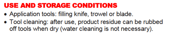

Continuing with the spec sheets
Easi-Fill:
that I believe just about describes all plaster ploducts to some extent, there is no comparable section in Toupret.

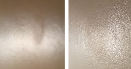

An issue with using a cement based filler in a plaster based finish is the difficulty of doing any rubbing down and making it even when there is a difference between the hardness of the different materials.
An example being these filled holes by a proffesional decorator who also extolled the virtues of cement based products and rubbing down:
Looking 'head on' or feeling them one wouldnt know they are there but walking down the stairs the hall light provides the effect shown.

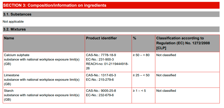

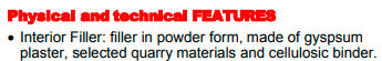

Now for clarification the TX110 spec sheet shows:
Indicating the internal filler and TX110 have a different base material.
