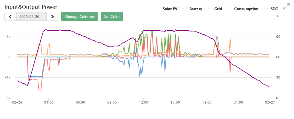

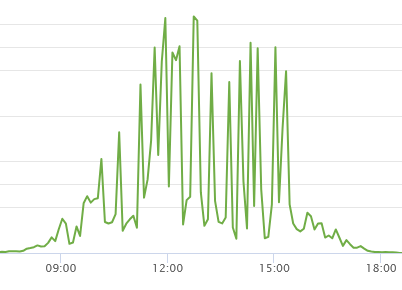

So a typical solar yesterday 1740653146864.png with all those spikes it is near impossible to run anything other than immersion heater with iBoost off solar alone, to use just solar it needs some method to smooth out the spikes, so with a modern solar system, the battery is an essential part, so my use v import etc is 1740653408376.pngthe purple line state of charge is the one I watch, as long as over 10% then unless I draw more than 5 kW then I will not use the grid power, but to do this needs an inverter designed to do it, my inverter holds back 10% for emergency, so with a power cut my freezers and central heating still works, and I also use off-peak as well as solar to charge the batteries, it is annoying to see 4.6 kWh exported for no payment, April my contract with British Gas ends and I will move to someone who will pay for export.

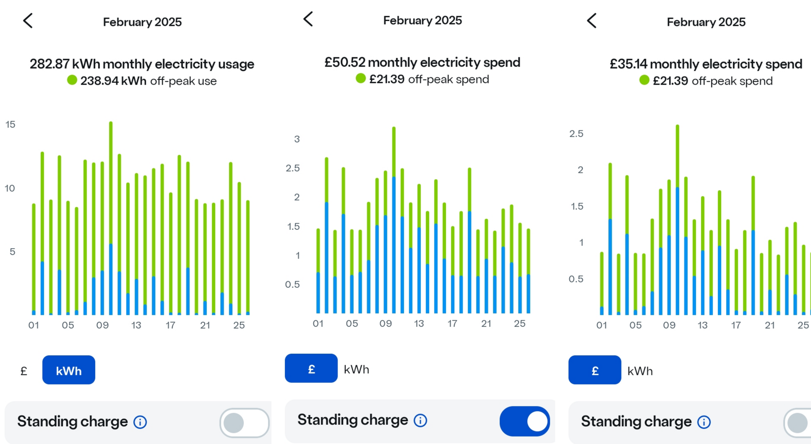

Here the smart meter helps 1740665434646.png this shows ratio between peak and off-peak, first the kWh, then money including standing charge, and final money without standing charge. It shows 60% of my electric cost was for off-peak power, and that's February, and no off-peak heating, and no EV charging, as summer arrives the percentage will increase, so the main gain I get is due to battery, not the solar panels.

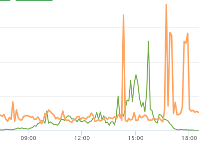

But yesterday quite good, but this

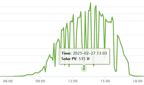

shows in the troughs only getting 535 watt, the peak was 5278 watt, but any equipment used during the sun shine without the battery will be using peak power. Here
on 22nd of February, my used did not match solar, the battery resulted in no grid power being used until 10 pm, but without it, would not have all gone to waste. Other days by chance it does match, but my tumble drier runs for around 2.5 hours at 600 watt, getting it to run when getting solar is not easy.
