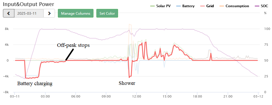

I have been looking at a report where someone went OTT with solar panel install, and I looked as one does at my own system, so yesterday
you can see I charge batteries for around 1 hour 20 minutes, and stop getting off-peak at 5 am, the battery state (purple) starts to droop, but rarely drops below 50% the inverter is only 5 kW so shower uses over that so uses peak electric, but if I could recharge battery at just 1.5 kW and only charge with off-peak to 70% it would be far better for both me and the grid.
But if the weather forecast could also adjust how much stored, it could be even better. However, the time taken to decide if to wash overnight or during day, one has to question, is it worth it?

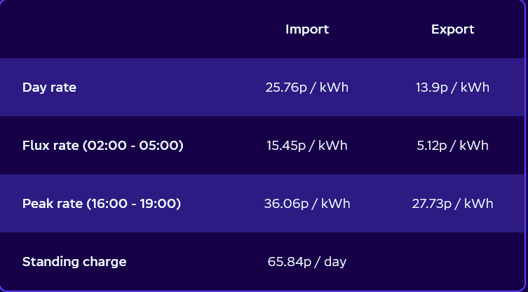

Not sure if it would help, for me rates are 1741865720173.png so the off-peak shorter (that's not a problem) but more expensive, 15.45p v 8.95p per kWh. The rest is split into two, 25.76p which is less than the 31.31p I pay now, and 36.06p which is more than I pay now, but that peak-rate is 4 pm to 7 pm and normally my battery will last to after 7 pm.
Where I will gain is 13.9p per kWh for export, OK 4 pm to 7 pm that jumps to 27.73p but most of the year, by then solar production has stopped, so does not really help. Tuesday as last day BG app shows,
7.31 kWh off-peak total 8.55 kWh cost £1.04 with £0.65 being off-peak, with standing charge £1.64. Hard to work out the flux cost, as not sure what used 4 pm to 7 pm. But midnight, 25% of battery left, so likely only the shower used peak power. As Excel is our friend
so because flex will pay for export, total for day 69p but if I had not exported it would have cost 47p more.
My tumble drier runs for around 3.5 hours, so in winter it will not complete within the 3 hours. So really not as good as it first seems, if I could get the export paid for with BG they would be better.
