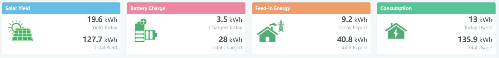

Only just had them fitted and as yet not sure what it will save me, however I can see what is being transferred.
Only been running for two weeks, so no idea as yet what it will save me, however when one uses power makes a huge difference, seems maximum in/out of battery is around 3.2 kW so showers need to be midday, and tumble dryer needs to start around 10:30 am etc. Not sure it is worth changing my daily routine to gain a few pence? But in the main it is the battery and domestic water heating which allow me to gain power, as a cloud will reduce output so setting some thing off like the dishwasher, washing machine or tumble dryer they need to complete their cycle, so without the battery at some point in the cycle likely we would be importing, only the DHW can alter to only run when there is excess. Does not need to be a big battery, but I have been watching the panels vary 600 watt to 4.5 kW in a very short time, so one could not hope to use only solar power without the battery.
My battery is always discharged to limit set by the morning, and I can't see it paying to have more battery capacity, it is the peaks through the day where it gains most energy for use, we do have a SCARTA type display, but it comes from a server in china so there is a delay, I can make a cup of coffee take it upstairs for my wife, and then view the display and it is still showing the kettle being on.

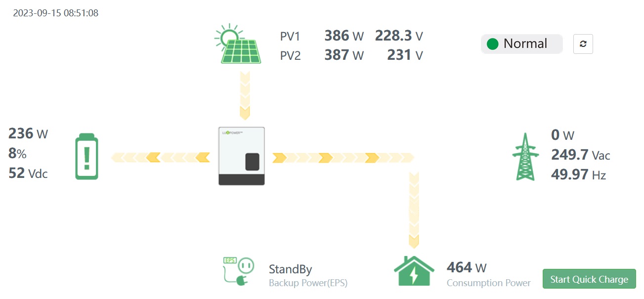

However without it I would not really know when to switch on tumble dryer on, looking for around 20% on battery before I start the cycle. Had some days where the solar is rather low, but had problems with the DHW to start with, it was switching on at 9 pm which was clearly wrong, and it needed the setting tweaking moving from 100 watt to 200 watt storage offset.
I have phoned the installers a few times to get it all set as I require, I can see that being a problem with a new user who can't phone the installer for advice. I do wonder now after your post how one would get on without the links to the software to show you what is going on. The software I am using was from the inverter manufacturer. It seems I have a dongle in the inverter and I gave the router log in details to the installers, which is also a good point, I need to know how to change setting if I ever change router, didn't consider it until your post.
