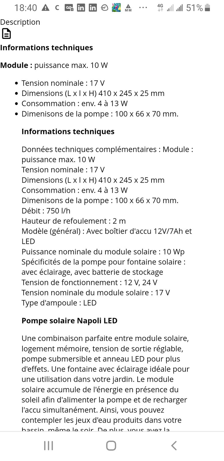

It looks like the solar panel is 10w, the pump uses 4 to 13W, the power of the solar panel is 10Wp (whatever that is). I can't find anything on the battery.
Google translate of the linked device suggests it's a 6V 3.2 Ah lead acid battery.
The solar panel is 8 Watts (peak), 8.64 Volts and 0.926 Amps.
See the data sheet from a typical battery of that capacity. https://www.tayna.co.uk/industrial-batteries/leoch/lp6-3-2/
