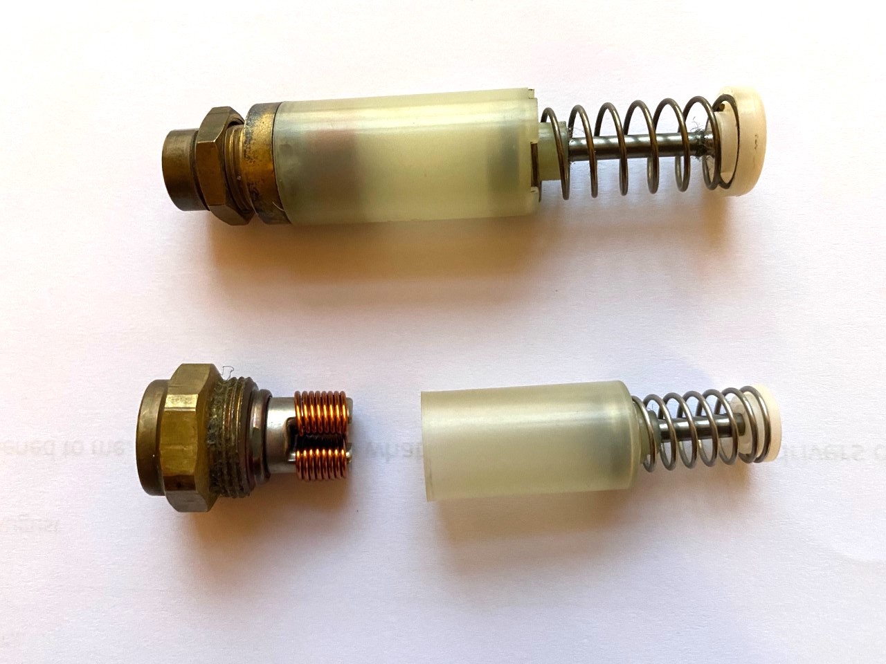

You seem to be still missing it - Why would such a tiny current, need just a few thick turns of thick wire on the solenoid? The solenoid I investigated, an extremely high number of turns and extremely fine enamelled copper. It had failed due to shorted turns.
Harry,John,
Your experiences may indeed be in seeing solenoids with many turns of thin wire. On dismantling a pair of gas valves my findings were very different. For some reason I decided to keep hold of the solenoids (maybe to test thermocouples at some future date) but no matter. I dug into my box of bits and, as you'll see from the attached photo, both (slightly different sized) solenoids comprise only a total of only 16 turns of fairly thick wire.
Thanks, but I certainly remain puzzled as to how they might work. Over to John..
I suppose it depends on what one is trying to move in order to latch the (manually opened) valve . If it is (which is really all it needs to be) a tiny (light) pin, with minimal friction, then I suppose it takes very little energy.
Also, on reflection, I'm not sure that the number of turns is necessarily a crucial factor, since that cannot increase the power (mV x μA) available from the thermocouple.
... so, I don't really know :)

The magnetic flux created by the electrical power from the thermocouple does not pull in the valve mechanism.
The mechanism is "pulled in" mechanically by the person pressing the button which opens the gas valve and also closes the magnetic path by bringing the magnetic faces into contact with each other .
When the magnetic path is closed it requires very little magnetic flux to keep the magnetic faces in contact with each other.,
Quite - that's what virtually all of us have said. Power from the thermocouple obviously would not be enough to actually operate the valve mechanism
The mechanism is "pulled in" mechanically by the person pressing the button which opens the gas valve and also closes the magnetic path by bringing the magnetic faces into contact with each other . .... When the magnetic path is closed it requires very little magnetic flux to keep the magnetic faces in contact with each other.,
Interesting. That's a little different from what I envisaged. I was thinking that current from the thermocouple was used to move a small 'pin' or suchlike which 'jammed' the mechanism so that the valve remained open when one removed one's finger from one button.
If what you suggest is correct, then I see one weakness (potential problem) with the approach. In order to 'fail safe', and to ensure reliable/safe closing of the valve when no current was coming from the thermocouple, there presumably has to be a reasonably strong spring to close the valve when it is not be held (manually/mechanically or electromagnetically) open - and I would not have thought that the thermocouple would be able to generate enough magnetic flux to 'win' in a fight against that spring.
What I've just written could be consistent with the fact that it usually takes quite a bit of manually pressure on the button - although that could be due to a fairly strong spring in the button mechanism, not the valve mechanism.
