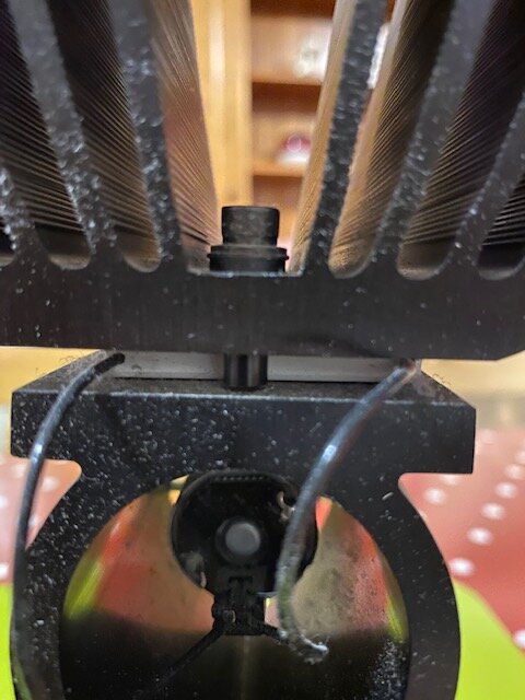

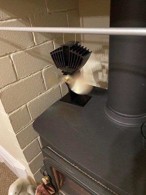

The above two images shows a thermocouple fan sitting on top of my woodstove. The differential heat between the lower and upper sections of the fan generates sufficient power to run the fan motor.
Thanks. Interesting - what sort of power are we talking about, I wonder?
Kind Regards, John
I suspect the unit is fabricated from several 10s of thermocouples wired in series such that we have a multiplicity of connections such as :
A-B + B-A + A-B + B-A + A-B etc
The fabrication problem of course is ensuring the A-B couples are on the hot side whilst the corresponding B-A couples are on the cold side since, if A-B + B-A saw the same temperature, the nett result would be zero volts.
