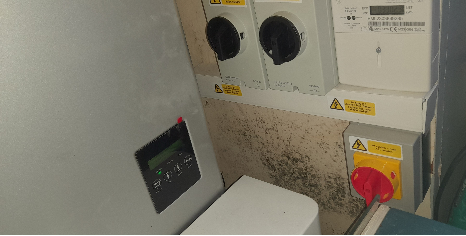

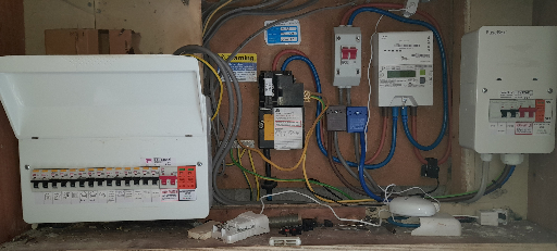

We do tend to consider our one homes. 1724502313409.png1724502374051.png So I have 7 isolators, one built into the inverter first picture on left. Most of house isolated with the one in consumer unit to left second picture, 4 sockets and 1 FCU with the isolator under the inverter.
To go turning off isolators rather than the RCBO could easy mean you have not turned off the required circuit. The important thing is to test for dead.
