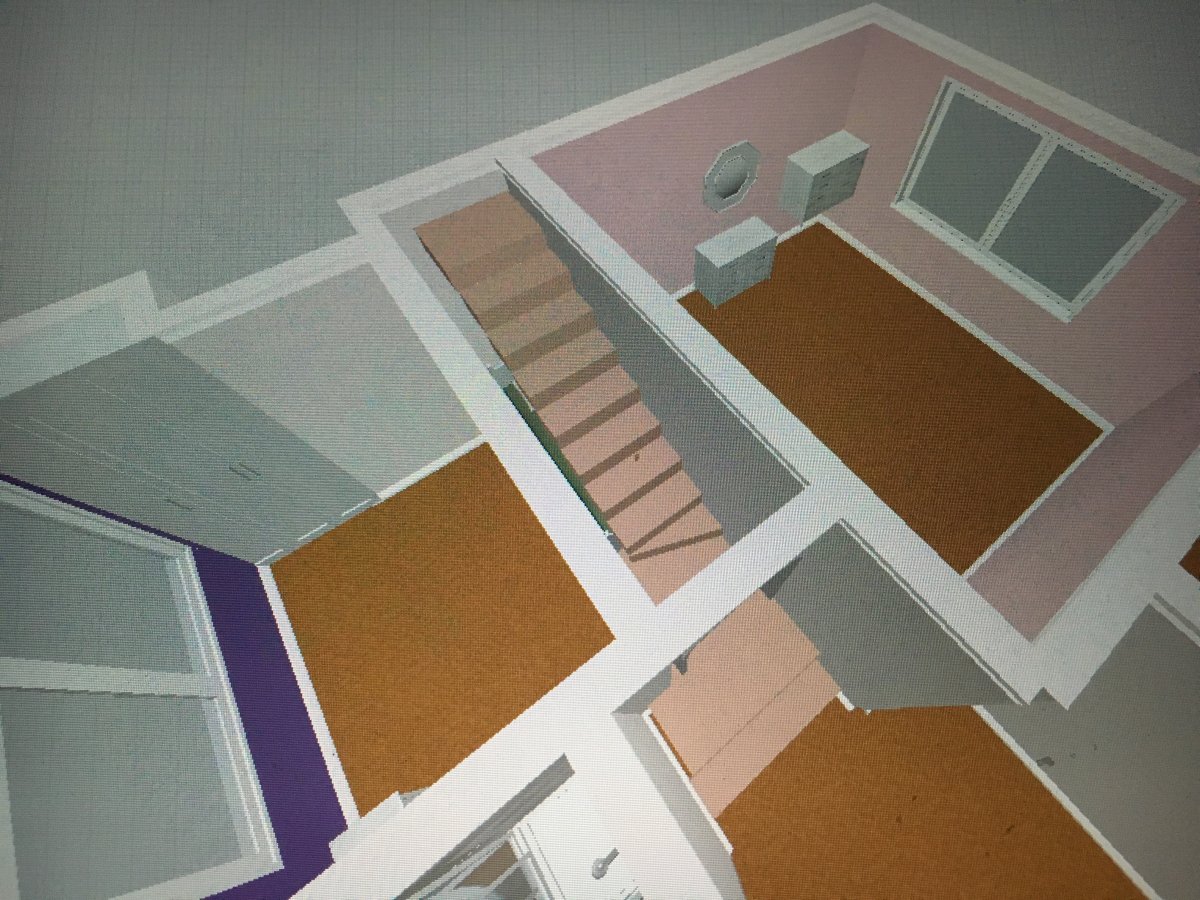

Space saving stairs
This is just my iPad model so it doesn't show the winder but if it gives you more insight

If the winders are at the top, then a narrower (600) winder staircase might not be considered safe.
Yes that's my feeling ..... I want it to be practical too. It's going to be a double bedroom up there so furniture won't be small.
Why's that then?
Why's that then?
Because if the stair was 600 wide, the centre going of 4 winders might be down to about 150, which is a bit small, particularly near the top.

But if we saw a scaled plan of each floor + vertical section, it would be easier to come up with suggestions.

Thing is, we're an inquisitive bunch and if someone presents us with a query we like (need) to know all the relevant info before we can really answer, there are some on here who will just pop their little comments in here or there and we can answer what we can with the info presented thus far but not can't really offer anything really meaningful so to do your query justice some more info is forthcoming as mentioned already like a layout of both floors and a floor to floor height and maybe a better photo of the chimney etc. I'm not necessarily suggesting anyone is going to come up with some lightening solution that you've not already considered but hey you never know, this is a free survey and at least we can understand and appreciate the issues more.
