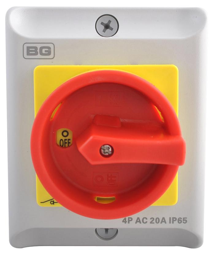

Hi,
This may be slightly over the top, but could it be worth considering a 2-pole isolator?
Something like this:
https://www.sparkswarehouse.com/col...ducts/bg-cprsd220-rotary-isolator-2p-20a-ip65
They are significantly 'beefier' than a standard switch, and easy to turn on and off.
Edit: although it wouldn't be a straight swap, cable glands and a fused outlet would have to be considered.
