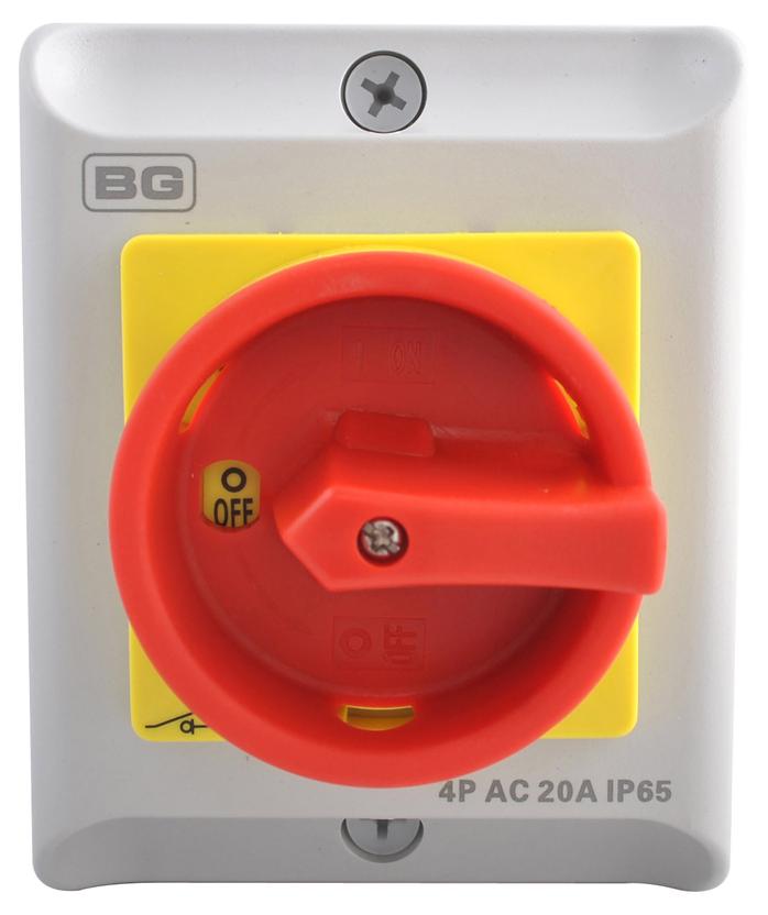

This may be slightly over the top, but could it be worth considering a 2-pole isolator?
Something like this:
https://www.sparkswarehouse.com/col...ducts/bg-cprsd220-rotary-isolator-2p-20a-ip65
They are significantly 'beefier' than a standard switch, and easy to turn on and off.
Edit: although it wouldn't be a straight swap, cable glands and a fused outlet would have to be considered.

But that isolator will also arc if switched of under load.
Yep, most will.
Unless intrinsically safe, and even then, only when designed as part of an IS system.
However, I would bet that the isolator would last a good deal longer than a cheap switch from Wickes!
...and you would definitely not see the sparks in there ;)
I may be wrong, but there seems to be a more positive 'break' in the contacts (and a greater travel distance), when turning a rotary isolator, compared to flipping a switch.

Yep - The contact is broken by a very positive spring action. They are not dependent on the operator flicking the switch, the operator winds up a spring, then the spring reaches a point where the spring flicks the contacts suddenly open. The are much better at dealing with inductive loads, such as motors, where there is even more tendency to arc, than a resistive load.

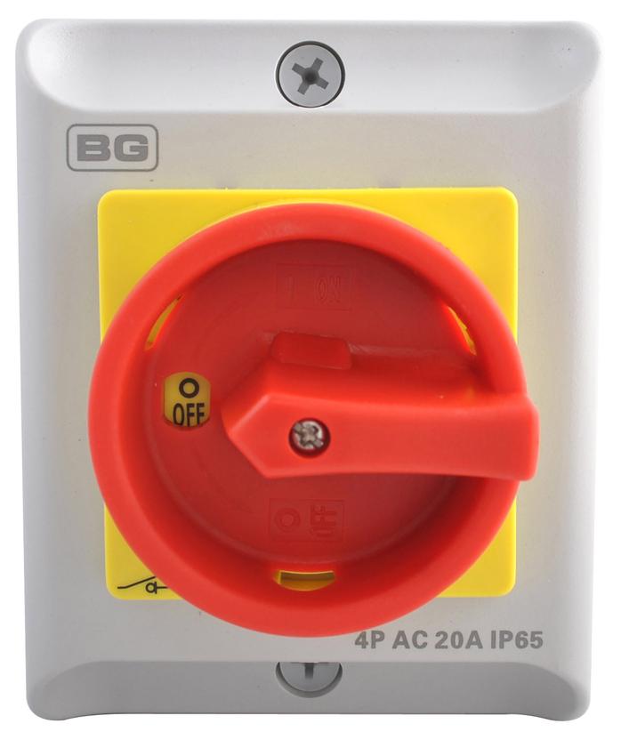

Would it be more confusing if this has a cable going to an immersion heater:
as opposed to this:
...and as we have said regarding isolators;
Have you tried flicking the switch of a cooker switch?
The action normally requires more force and is far more positive, than with a standard switch.
