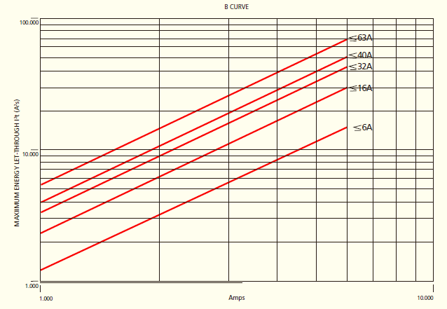

I also do wonder a little about the extent to which manufacturer's I²t data really is empirically determined for each and every of the protective devices they manufacture. The below comes from the technical data for MK Sentry MCBs. For genuinely empirically-determined product-specific data, the curves are incredibly linear throughout the range 1kA - 6kA, implying a precisely linear inverse relationship between current and disconnection time within that current range - which I find a little 'suspicious'!
In passing, I would also note that the figures as 6kA imply disconnection times ranging from 0.39 ms (for B6) to 1.9 ms (for B63) - whilst I have to assume that those figures are probably roughly correct, I have to say that I'm actually surprised that (given inertia of parts etc.) anything electro-mechanical can operate quite that fast! I would also add (since it is a 'pet hate' of mine!) that MK (who should know better!) describe I²t as "energy" - which it isn't!
However, of most practical importance (and relevance to this discussion) is that even if an electrician took the trouble to seek out that information, the curves only start at 1 kA, whereas I presume that an awful lot of installations (like mine) will have a PFC less than that - so back to 'guesswork' (or, at least, {not definitely valid} extrapolation).

Isn't the graph only linear because it has been drawn like that by adjusting the axes divisions?
In a sense, that is true (even though both axes have log scales). However, my point was that, no matter what axes one uses, to get a series of 'perfect straight lines' (with whatever axes one is using) is not what one really expects of empirically-measured data. However, maybe I'm too cynical!

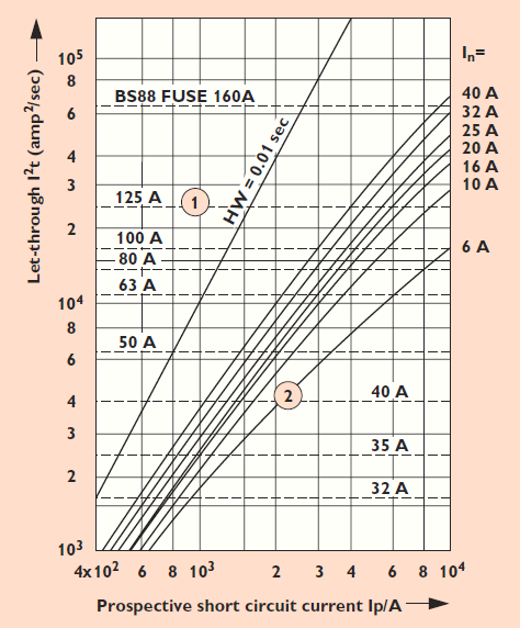

... also, there is surprising variation between mnufacturers., The corresponding curves below from Wylex indicate an I²t of about 40,000 A².sec at 6 kA for a B40, whereas the MK curves give a figure of a bit over 50,000 A².sec.
Is it really the case that there is such a big difference in I²t (hence also in the results of adiabatic calculations) for B40s of two different makes? If that is true, I would regard it as a bit worrying.
[ Note that although (unlike MK) Wylex don't (incorrectly) call I²t "energy", they have the units totally wrong ("amp²/sec", rather than the correct "amp².sec")! ... and I'm not too sure what "Ip/A" in the x-axis labelling is all about, either ]
I would also repeat a comment I've made in the past that, at least in mathematical terms, it's rather odd to plot I²t again I - it would be far more logical to just plot t against I (as in the BS7671 MCB curves).

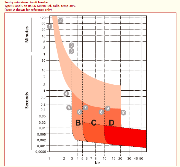

Having thought and looked a little more deeply, I am now even more inclined to think that one should be careful not to over-interpret what a "manufacturer's data for the specific protective device" actually is ...

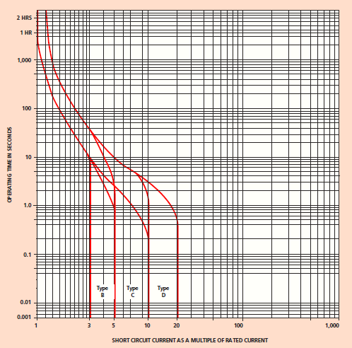

... if you look at the two t/I curves for MCBs below (one Wylex, the other MK), or the corresponding curves in the Appendix of BS7671, it is fairly clear that what one is seeing does not relate to the "specific protective device". Rather, it is merely showing (at least in terms of magnetic trip) what is required by the product Standard - e.g. magnetic tripping at 3In - 5In for a Type B (BS7671 just shows the 'worst case' upper figure, but MK and Wylex show both). This data clearly has not been derived from testing of the products concerned (beyond confirming that the products comply with the Standard). The "manufacturer's data" is, therefore, essentially 'generic'.
If that is the case for those curves, I wonder if the same may also be true for the manufacturer's I²t ones - i.e. are they perhaps not showing how the actual product performs but, rather, are reflecting some requirement (e.g. for a certain maximum I²t at peak rated current - i.e. 6kA ) in the product Standard (does anyone know if there is such a requirement?). If that were the case, then the "manufacturer's data" would, again, be essentially generic.
