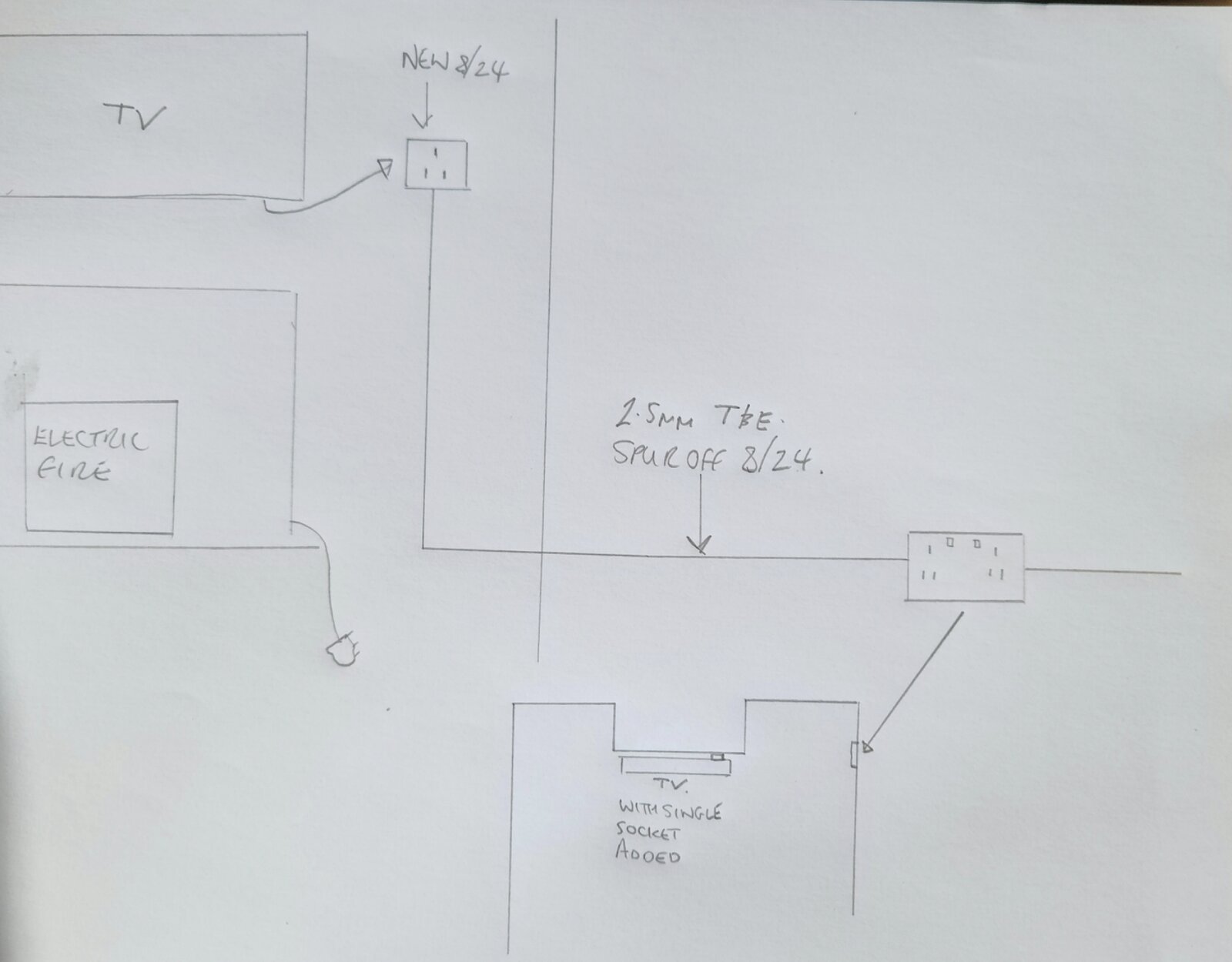

Spur off Double Socket.
I wouldnt have a clue where this original twin is fed from (to put in the unswitched before it)!
You don't need to know.
You fit the unswitched FCU where the existing twin is, and still keep the existing twin.

I suppose the easiest thing to do here is change the new spurred off single to a twin and get the new fireplace flex up the chimney breast void and plug it into the twin with the TV also plugged into the twin.
Or even hardwire the fireplace into the back of the twin but my concern would that it would leave a spare socket which if used I would have 1) TV Plug 2) fireplace hardwired through back and 3) a spare socketon the twin which could overload?
Where the 2.5mm from the existing twin goes through the side of chimney breast would it be worthwhile putting an FCU there for the new twin, I need to put something at this point anyway as I have a hole for the 2.5mm (just above new skirting).

My understanding has always been - only one unfused spur, from any point on the ring - as per @PrenticeBoyofDerry post.
I think you (and PrenticeBoyof Derry) must have imagined that. There isn't any such regulation, and certainly hasn't been in other recent editions of regs. You surely must have seen the many discussions here about getting four conductors into a socket's terminals when originating two spurs?
Even the 'prohibition' of an unfused spur from a ring final feeding two single sockets is just 'informative guidance' in an Appendix of the regs, not a ';regulation'. Electrically speaking, there is nothing wrong with two single sockets being fed (from anywhere) through Method C 2.5mm² cable.

Not sure I agree with that. ... 18th ed AMD 2 pages 555 & 556
Quite apart from the fact that those pages are 'informative guidance', not regulations, where on those pages do you think it says that one cannot originate two spurs from the same point?
"Informative guidance" as you put it would show this if it was a reasonable idea. ................... but doesn't
It also only says use 4mm² for an unfused spur to two sockets on the 4mm² radial diagram.
Do you think that means the same is not allowed on a ring or to more than two sockets?
