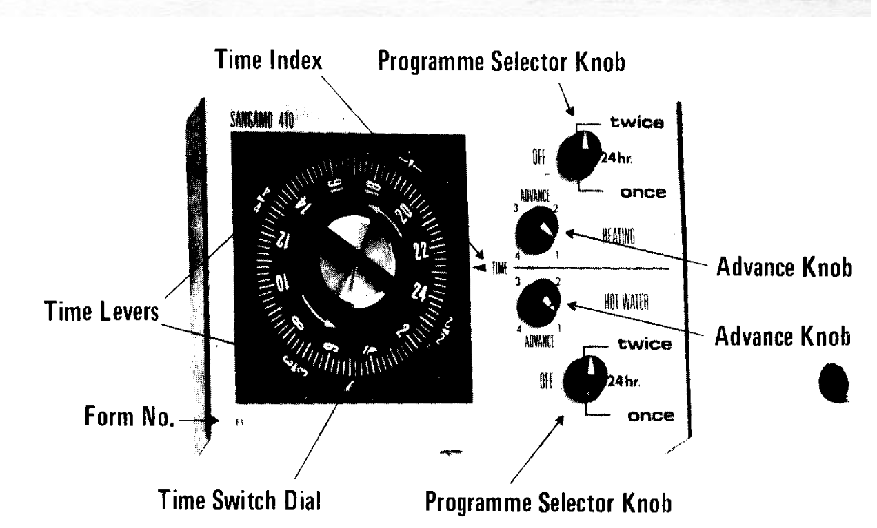

The current controls are an ancient timer Sangamo 410 F4 with no thermostat (room or HW) with gravity HW and pumped CH.
Even if I can't persuade my mother for a new boiler (one part depends on how compelling the gas prices make the payback) then she would consider a new programmable controller to optimise the efficiency for the 65% back boiler.
The ideal would be a "simple" one with thermostats for heating and HW that would also work with a combi (or other boiler) in future.
I think I've researched the pros and cons so am not blindly going for a combi.
The anxiety around any new "gadgets" is not to be underestimated - and that even extends to staying somewhere nice while any work is done!
I've had Drayton Wiser and Tado and they have had issues which she would not be abe to cope with (even though I normally favour solutions that can be remotely controlled).
Tx again for all the info.View attachment 278740
Sounds to me like you need to let a heating engineer look at it. If you go for combi the HW outlet on the combi will need connecting to the HW outlet pipe from the cylinder somewhere (not necessarily near the cylinder), likewise for the CH outlet into the heating circuit.
With heat-only or system need to connect to the cylinder primary and to the heating circuit (after a diverter valve).
How straightforward any of that is depends very much on the house layout.
