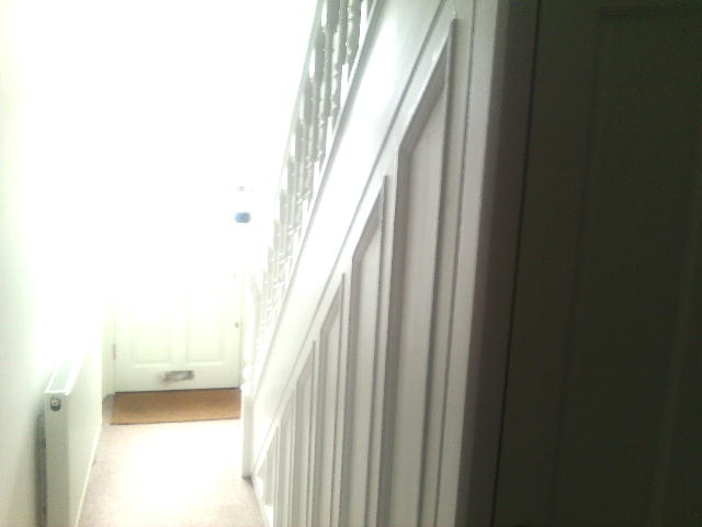

Just a little update for anyone interested. I only put one top coat on it and it looks great. I have been cracking on with getting other things done. Got under stairs wall plastered (got a pro for that!) and trimmed. and ive now got the mist coat on all the walls. Wew, im all painted out.
We will be carpeting stairs.
This is the new plastered wall. Still need to obv paint wall and paint trim, which is just all pre primed MDF stuff. Also the door is either going to be painted white or stained in the dark. Not decided yet. Will prob decide once walls all painted. I am thinking prob white, as the other doors will be white, so might look a bit odd in the dark.
Anyway I am prob gonna go make a thread in projects or something if anyone is interested, as the rest of work I am doing isn't just on this staircase.
Looking superb, personally i would paint the big post and the hand rail in white as well, and the under stair door in white.
Its rosewood though, not black. It is dark mind you, but its exactly what I wanted in the end. Personal preference!
You made the rght choice; all white staircases were an 80s fad. It hurts my eyes!
