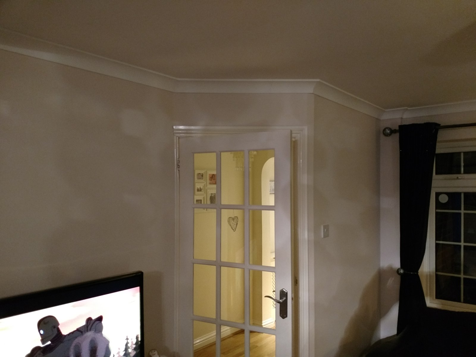

Moving the stairs back was going to be my first suggestion, but that would mean moving the door to the living room backwards as well.
It is probably the neatest solution but like you mention the hall way stud wall and door would all need moving and we are looking to put a downstairs toilet that would be accessed through a door on the right of the hallway. The stairs moving back might prevent that. Oh and the cost of a new staircase and installation

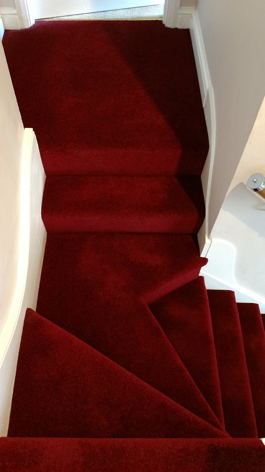

Yes they haven't had the build started above the garage yet but the stairs and landing are completed. Probably moved the stairs 4 steps towards the front door as well as taking a corner out of the box room to provide the head room.
All seemed to work but they didn't have a hallway enclosing the stairs.
Stairs aren't that expensive, and you're better off with the "best" solution, rather than the cheapest. You can move the stairs back, bring the stud wall along with it, and put the door into the living room at the front, and your living room will be larger. You should still have space at the front of the hallway to fit the door for the toilet. It could look less of a bastardisation doing it this way, than having the new room at a lower height to the rest of the property. It will also allow the bedroom door to be set in it's proper place.
If think you may well be right. I suppose my difficulty is I see potentially little jobs as massive ones because most DIY jobs are massive to me ha ha.
Just seems a lot of work and hassle to me. The under stairs cupboard also needed reforming across the road due to the changes.
The stud wall and entrance to the hallway are attached.
I have also attached a photo of another neighbour that had their extension done in the 80's
The last picture shows how creative you can get, but as Woody pointed out, you can't get straight into the bedroom, so in being creative, the created another problem. Moving the stairs back, is the most sensible option, but why are you worried about it; yes it'll cost a bit more, but it's the builders doing it, not you - I hope.
