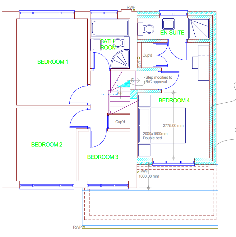

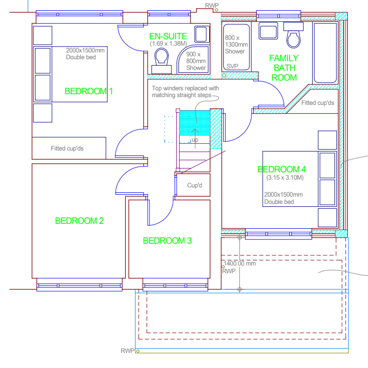

Because that would restrict access into the lounge. But it's an interesting concept. Far easier to just raise the stairs, and shift the door to the lounge.
Does a trampoline and a hole in the floor above comply with building regs?;)
