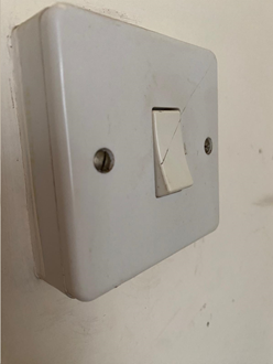

Until yesterday, I would have said that I don't recall having seen a toggle or lever switch in UK which was 'down for off' (although I gather that is the norm in US and elsewhere). However, yesterday I was in a neighbour's house and found myself confront with (in their downstairs loo!) a brass toggle switch that was 'down for off'!

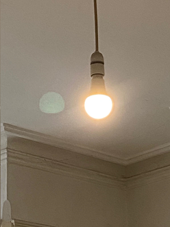

On the other hand, I'm fairly sure that I have fairly commonly seen (in UK) rocker switches with "press bottom for off". By purely fortuitous co-incidence ... I am not at home at the moment, but these photos show the light switch and light in the room I am sitting in ;)

Who knows? I'm 'assuming' nothing - I merely said that I had not uncommonly seen it - but goodness knows whether it was done 'on purpose' or not!
Hang on - there is one way that I can get some insight into the probable answer to that question .....
not totally conclusive (because of the two 'exceptions') but all but two of the 1-way switches in this house appear to be 'that way up' - so I imagine it was essentially 'on purpose'. The house was rewired a bit over 20 years ago.
