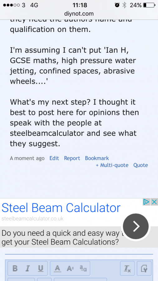

As part of a loft conversion I calculated 3 steel beams using www.steelbeamcalculator.co.uk
Building Control just visited and said (to my missus, I'm at work), that although the beams look right, they need to see the calculations. She handed him the print outs from the online calculator and he told her they need the authors name and qualification on them.
I'm assuming I can't put 'Ian H, GCSE maths, high pressure water jetting, confined spaces, abrasive wheels....'
What's my next step? I thought it best to post here for opinions then speak with the people at steelbeamcalculator and see what they suggest.
And look what just popped up on my screen:
Building Control are not allowed to demand the name and qualifications of anyone who submits structural calculations.
Their job is just to check the figures as submitted, which is done either by their own in-house engineer (who is usually part of the Building Control team) or occasionally by engaging outside engineers for more complex jobs.

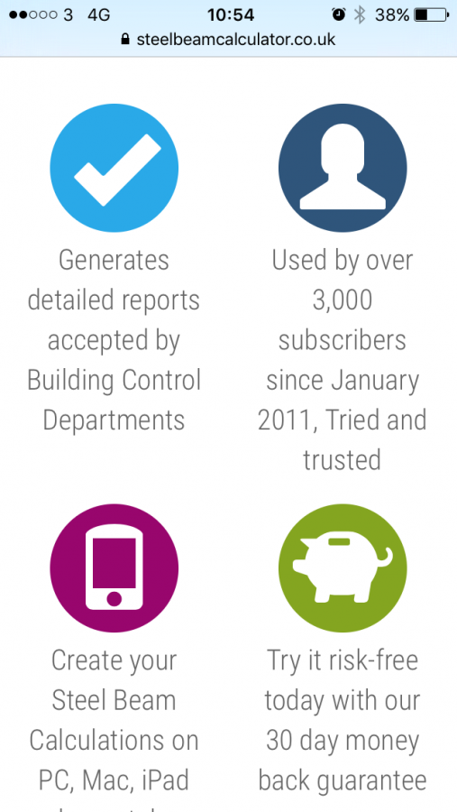

I wonder if the name of the website and qualifications of the guys running it would be enough? I doubt my missus even knows the name of the website so she wouldn't have been able to tell him.
The website does claim to satisfy building regs:

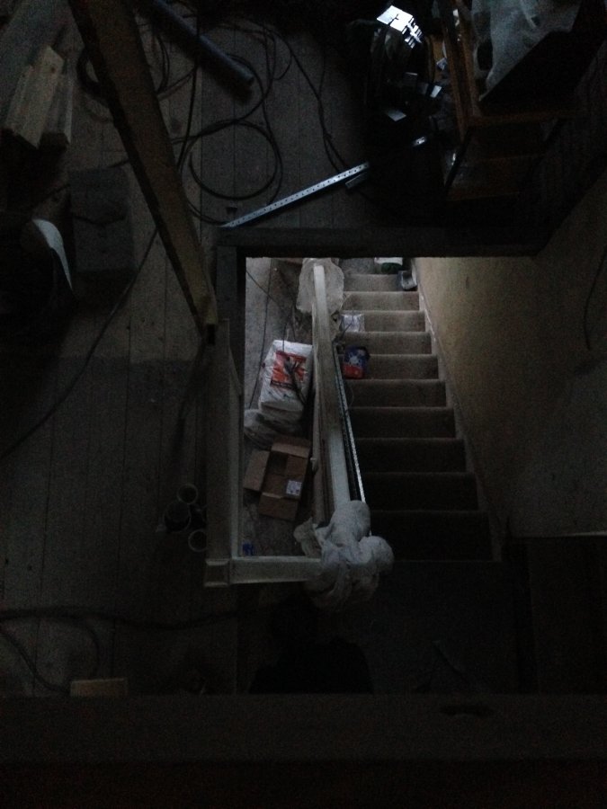

The only other thing he wanted were fire casings on all the internal doors.
One good thing was that he said it wasn't a problem to mirror the landing opening at the top of the loft stairs:

Lol's, Just figured out you photo angle 1990. Thought I was viewing the stairs through a cupboard from the bottom to the top! My early morning coffee has now kicked in and I realise you are looking from above.
I did wonder how that bag of plaster was hung there.:whistle:
