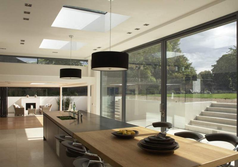

noseall,
I understand you would have prefered my 10m 'yawning' aperture to be half filled with brick. What would I have done with that brick wall - hung a few pictures on it? I want my garden to be the picture.... and I wanted to add a wow factor to the house. In essence it is more of a modern conservatory.
There is nothing impractical about it, it's not 10m of folding doors - only 5m of sliding glass. The rest of the glass is fixed. You seem to have no problem with it if the fixed glass was replaced by brick? Do you think the image below - something similar to what I am doing is is "bonkers, impractical and resembling a car showroom window"? I beg to differ..
There should have been no problem with building it.. it's not exceptionally difficult. The structural engineer made a mistake and I now I need to find a way of rectifying it.
As they say, beauty is in the eye of the beholder. You may not like the look of it, but I love what I will have once the issue is rectified and certainly don't need your condolences...
