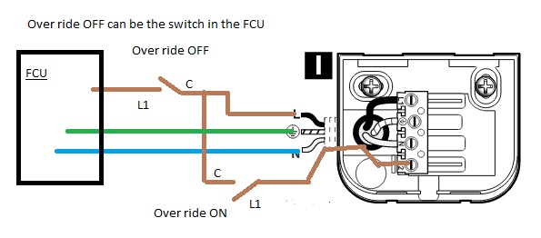

Thanks that all makes sense apart from where does the switched live go? On my understanding what you have explained above will just turn the light off and off (ie just supply power to it or not)?

Ok thanks but I'm still unsure how just wiring up the standard LNE through a switch will give me the three modes of On/Off/PIR. Sorry if I'm missing something.

Nope we've already concluded that this lamp doesn't have the override (quick switch on and off) function. That's the whole issue.
Just looking at Bernardgreen's diagram - if I interpret it right you need 3 core and earth - N and Earth (out terminal) as normal then the two remaining cores go into the live out terminal - call them PL and SL.
You then have a second switch through which the incoming PL, N, E run to and terminate in a terminal block . The incoming SL goes to the switch Com terminal.
From the second switch you have the 3 core and earth with the outgoing PL, N, E connected to the terminal block before running to the back plate LNE.
The outgoing SL connects to the switch L1 and then onto the L2 at the lamp back plate.
If I have that right you could accommodate both FCU and switch in a grid switch formation. FCU on alone with give you normal PIR and override when both switches are on.
In Bernards diagram. Ignore the box marked lamp.
The box marked PIR is your combo PIR & lamp.
In his diagram, brown is L, black is N and the purple wire is the L2 connection. Do not forget the earth too.
So you need 3wire+earth cable from the switch to the PIR/light.
Ok cool. I think I get it now. I need to buy a two gang double pole switch to make this all work. I'll buy a ip rated one so I can put the switch outside.
