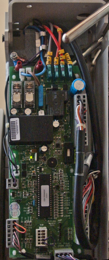

My mother hardly uses the stenner stair lift so no idea when the fault happened. I came to change a toilet and thought easy way to take the old loo down stairs was on the stair lift. It actually went about on meter before stopping.
First thought was maybe not been on the charging station so wound it back to station. Week latter still not working so time to look further.
Removing front cover I found the replacement batteries fitted at last service had smaller spade connectors than original and the so called engineer had pushed on the connector with the spade between the insulator and connector rather than the correct metal gripping part.
Quick bending with pliers and now good connection to battery. But still stair lift not working. Tested voltage on battery 27.4 volts power off and 27.6 volts power on and disconnect and getting 29.6 volt so clearly now charging.
Wound the chair off station and tried all safety switches wound back onto station removed power unplugged battery re-connected battery and switched on power and at last it worked.
I ran the chair about one meter from the charge station twice and back again and all seemed to work but decided to leave on charge before further tests if you have ever tried to manually wind the chair you would realise why I don't want it to fail.
It seems likely it was simply a bad connection on the battery but rather worried easy enough to carry the loo down stairs but to carry my mother would mean calling fire and rescue service.
Clearly I will once given time to charge re-test the chair for the whole run but rather worried about it failing without first any warning lights. The green all well light went out but yellow power light was on it would seem the fault latched some relay to stop the chair being used which is totally unacceptable except at the charging stations.

At last found a wiring diagram. Seems three relays control the motor RLY1 and RLY2 change direction and any fault will only show with the direction selected. RLY3 however controls both directions is activated when either the other two are activated and is controlled by the Power Relay Controller.
It seems likely the problem is to do with the RF link with the leg. How I could test the RF link not sure it is something I am not happy about relying on an RF link.

It seems there are 10 LED's which should show what fault has happened had I found these before getting it running again maybe they would have shown where the fault was, however not running again so no idea what caused the failure.
Some info is helpful minimum voltage is 20 below that LED 2 lights and maximum current is 18A above that LED 3 lights. Some are less helpful LED 5 means RMU has tripped still not worked out what the RMU is. I can find a RMU sense switch shown together with slowing sense switch. There are so many options where when using the option a link is removed and a poor connection would stop the chair.

The diagram is better than nothing but it is still a problem in that one has no idea what stopped it. The panel is to the right when facing the chair and to the right is the bedroom wall so near impossible to see the array of LED's which it seems should show the fault.
My reading of the circuit diagram suggests what appears to be a short circuit route from the battery positive pole to the negative pole via the second-from-the-left vertical circuit leg.
Thanks. May not been what you intended, but pointing out the two LED's is a real help. When it failed no green LED when running there was so two switches the Ultimate limit switch and the Safety Gear Switch seem to control that green LED.
So what I think happened is the Safety Gear Switch stopped it. Then I manually took to back to charging station and in doing that I activated the Ultimate limit switch so on switching the battery isolator switch back on it still did not work.
So now I need to work out what is the Safety Gear Switch and how did my running down the track activate it.
This it would seem is the only bit I am now interested in.
However on returning to my mothers I found it went to bottom of stairs without any real problem but getting it back up was another thing.
There is a line of LED's on the main board to show the fault normally hard to see. But with cover off it proved to be the battery at fault. I would get a few inches at a time and each time it failed the warning beeper to say parked off charging station would sound. Most times it would require the isolator switching off and on to restart but as the distance decreased then just releasing and re-pressing the up button was enough.
Fact it travelled further on the flat rail than inclined does point to battery failure. (Voltage below 20 volt) First battery fitted 03/04/07 which was changed 03/03/11 we assumed failed because not parked on charging station. Second set which have now failed were defiantly on charge and show 27.4 volt until loaded but first set seemed to have lasted 4 years and second set have lasted 4 years so it would seem the batteries have a 4 year live span.
