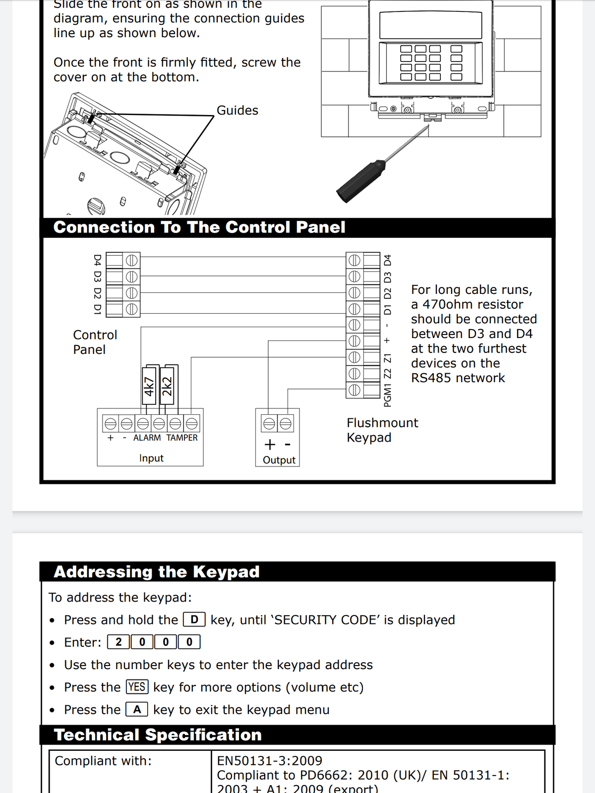

Greats worked a treat. I see the panel/keypad comes with 2k7 and 4k7 resistors but also came with 4 476ohm resistors what are they for
Handyman jo yes your right it defo helps but there is absolutely no mention of it in my manual (latest edition)
