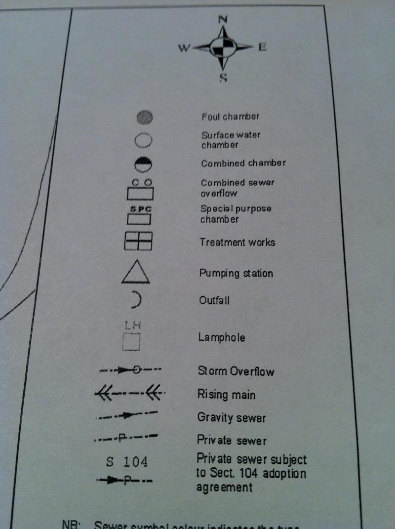

I have a document in the house showing the water directions etc.. from when we purchased, ill take a photo of this and post it tomorrow.
The only problem is im sure the lines are meant to be colour coded (the doc i received is black and white) so may not be a great help,
The drains layout diagram will certainly help a great deal. I'm sure the more experienced posters will be able to understand it.

Wow! That does illustrate a lot, if the pipe that you have uncovered is the combined drain.

First off, and everything I say is assuming that we are talking about the correct pipe, 'cos I do have some doubts, this is a private sewer and the responsibility of all users to maintain it, and that's a lot of properties. Just 'cos it's in your garden does not make you solely, or even majorly responsible.
You could even have a strong case against all your neighbours for not maintaining it when they suspected it was broken.
If that is the combined drain pipe, I would have suspected some foul smell at the bottom of your garden. Also, it seems woefully shallow depth and diameter for that kind of drain.
The kind of test that I would suspect a professional to undertake is identifying where the drains run to, especially yours and your neighbour to your left, as seen on the plan. This would probably be done with dye and checked at the end of the pipe that you found and at the combined chamber indicated further down the embankment.
It also appears that the bypass road was not constructed at the time of drawing up the plans. Is that correct? Although I doubt it would have impacted on the drains layout as this plan was obviously available.
I do not think this is connected to the waste, as you can see on the map it shows a clear / white triangle i opened this and could see water passing through when i looked at the blue pipe i had found there was nothing passing through this pipe.
My complete guess is that the pipes join somwhere after the blockage or broken pipe.....

It's a combined sewer system that you and your neighbours have, that means all foul water and surface/storm/rain water all goes down the same system. If there was a blockage/leakage/overflow into your garden the smell would be horriffic by now and you'd have a deluge. It would be overflowing down the embankment.
Dare I say it, but this plan is a red herring. :eek: Well, it's a bit confusing 'cos I suspect that the real drains are deeper and larger. (And why an inspection chamber was not incorporated at the four way junction in your garden, only the installer knows).This isn't the kind of pipe that would have been used in the system.
