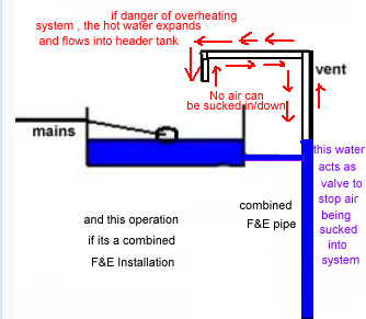

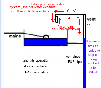

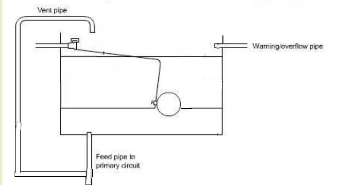

Odd , not seen that combined F&E before done that way - the only combined F&E I have seen is the pic I posted above , where the vent pipe hangs over the top of the header tank
And older systems fed and vented like this:

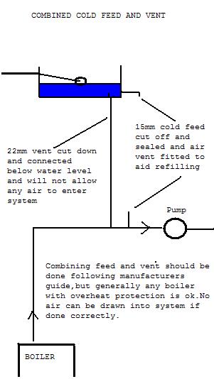

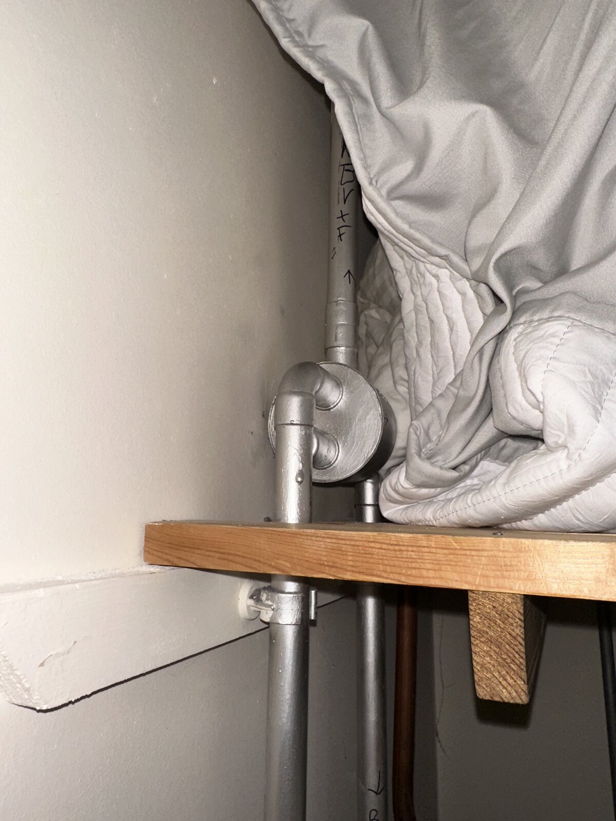

Thanks to John, I am fairly confident that the aerjec is the cause of the problem. It’s definitely piped incorrectly for a combined feed and vent. The boiler flow is supposed to go into the top valve inlet and then drop into the bottom valve outlet, with the cold feed inlet capped off (because it’s part of the vent pipe)… but instead the boiler flow is going through both inlets and going straight back out the outlet… so nothing can aerate. This must be why air is getting trapped.
On the basis there is no separate cold feed, I think it’s fair to assume I just need the “aeration” setup only… and therefore it has been plumbed incorrectly!
Where will the cold feed be?. if you are installing it as a deaerator only?
The cold feed will be the vent pipe! Combined feed and vent.

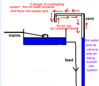

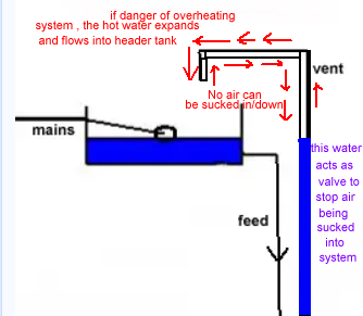

this is how I understand feed and vent (this is not combined F&E) to work , it acts as one way valve so it wont suck air in through the vent pipe - but it will expand when it needs to and release into tank if boiler overheats:

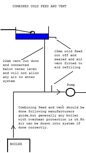

Well, one of us is confused, you suggested using the aerjec as a deaerator only, and you posted the attached schematic, item 5, it shows the cold feed as a separate item, doesn't it? or are you going to install it as originally designed, item 4?.

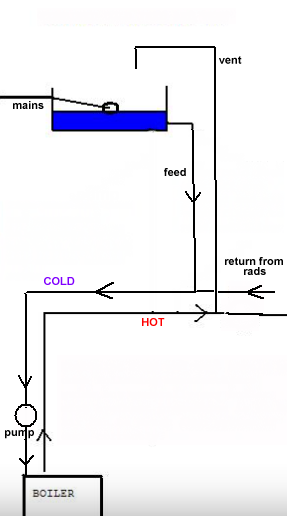

Thats the much vaunted VCP system where, from the boiler, you have the Vent, Cold Feed (no more than 150mm away) and Pump, these systems have also given problems and were "cured" by converting to my system, schematic shown in post #11, above.
I assumed as it was a separate pipe, it could just be disregarded, as it doesn’t exist on my system!?
This is my current aerjec. The pipe you see leading out the top of it is the combined feed and vent. This is the pipe that goes into the bottom of the F&E tank.
There is no other vent pipe or indeed any pipe that goes into the loft, except the cold main, to refill the tank.
