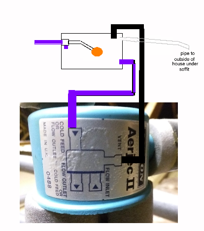

This is my current aerjec. The pipe you see leading out the top of it is the combined feed and vent. This is the pipe that goes into the bottom of the F&E tank.
There is no other vent pipe or indeed any pipe that goes into the loft, except the cold main, to refill the tank.
nah, that dont sound right at all then to me - I would branch off your pipe at the bottom of the tank to another pipe going above your F&E tank and bent over the top to make a proper combined F&E system then ... plus also safer if boiler should ever overheat, the water then will just boil up the vent pipe, go over the curve, into the F&E tank and fill that up and then exit outside the property by pipe just underneath the eaves and out into the back yard
or if you want to keep your air seperator thingy you could plumb like this:

OK, so are you going to modify the bottom pipe from your existing set up to feed the pump, ie, flow from boiler into the top (side) of the aerjec and the aerjec bottom (side) pipe goes to the pump?.
Correct, that’s what I was thinking, thanks to your help!

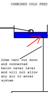

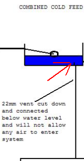

fascinating that though because if you have got a system where you have a bent over pipe over the top of the feed tank its end is always open , not covered by water so as water heats up it expands and also pushes air out through the hole , so the air would escape through that way , just same as if you were boiling a kettle the air and heat escape safely but if you were to block a kettles spout then where would the heat and air escape it cant .
So if the OP system is like this
where the F&E pipe is at bottom of tank and covered by water then what does it do just bubble up inside the tank under the water when it needs to expand or let air out?
Yes, remember the vent has the same level of water in it as the cistern so any air will have to bubble up, one way or the other, I have a isolating gate valve on the feed to the cistern ball cock and on the very rare occasions that I have to partially or fully drain the system to renew the odd TRV, to refill, I just crack this valve open, my theory is that the water trickling down one side of the 22mm cold feed will allow the displaced air to VENT up the other side of the (open) pipe, I never have the slightest problem with trapped air afterwards apart from venting the rads as per normal.
