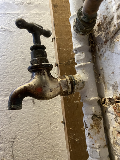

Hi there. I'm trying to get to grips with a largish late Victorian house I have inherited, which has been largely 'neglected' for decades (essentially since WWII - hence about 80 years!). There is very little plumbing. What there is (including wastes etc.) is primarily lead, with some ';iron' and literally just a few inches of copper here and there.
The entire plumbing (and heating!) system obviously will need to be re-done from scratch, and I will address that in due course. In the meantime (whilst I am 'saving up' to do the proper work!), I wanted to do one temporary thing. In a 'scullery' beyond the kitchen (close to the rear door of the house) there is a hand wash basin with a functioning water supply (the room is supplied in lead, changing to 'iron' at a stopcock beneath the basin.
Below the sink, downstream of the stopcock, there is something which I think probably qualifies as a bib tap, attached to an 'iron' Tee. For a start it's dripping a bit, and I'm not confident that it would/will be easy to get it apart to replace its washer. However, I haven't even tried that yet, since I would really like to change it (as a temporary measure) to a modern hose-union bib tap, since it's proximity to the back door would make that useful.
Below is a photo of the tap, which I have cleaned up a bit in an attempt to see what I'm dealing with. I personally can't be sure whether the tap has a male or female thread but I had assumed that, either way, rotating the tap anti-clockwise (as I look at it) would get it off. However, so far no amount of brute force has succeeded in achieving anything at all, and I'm a little reluctant to get too violent with it!

Yes it will screw out
May find some heat usefully
Looks to be standard !/2 in bib tap
Modern equivalent will screw strait back in.

The thread will be standard 1/2 inch bsp same as new one,s,try unscrewing but support the tees you don’t pull the other joints , heat will help

If you replace it for a modern bib tap for use with a hose in the garden, then it’ll need to conform with water regulations, so an isolation valve and double check valve. If you’re just filling buckets then as long as you can maintain an air gap, should be satisfactory. Regards undoing it, use a decent spanner, grips or footprint wrench.

The spanners I've tried so far have, at least to my mind, been 'decent' enough, and I've tried with an ~18" steel tube over it. Needless to say, access is not ideal, and anything longer than about 18" would probably be problematical - but we'll see. I suspect (hope!) that heat might be the answer.
Kind Regards, John
If you can turn the supply off first, you can try various methods, such as heat, de-rust/penetrating oil, longer tube on spanner etc.
Then if anything breaks/snaps you don't have to worry about causing a flood.
Probably sealed with hemp and paste which has set like concrete. It will go if you get enough leverage. I would put a decent stilson wrench on the tap body. That vertical pipe isn't going anywhere so have your weetabix first and go for it

Nope, regulations state its own isolation valve and any check valve should be fitted inside where practicable. A tap which incorporates a check valve is only allowed to be fitted: If it is a direct replacement of an existing tap where a check valve can not be fitted on the supply pipework iirc. What you are doing (temporary or not) could be seen to contravene the regulations - obviously, only if someone from your water authority sees it or there’s a backflow into the supply.

As I said, there is a practical/access issue with a pipe longer than about 18" - there is a wall very close on one side of the tap and the basin (with it's pipework and waste) very close on the other side. However, I'll see if anything longer will fit, but am putting my greatest hope in heat.
Indeed so.
I'm not sure that would help, the hex bit of the tap is intact, and I'm getting a very good 'connection' betqeen it and the spanner.
That was my thinking - but I'm probably going to try a bit of heat as well as the Weetabix!

Wd40 if its having a hard time to get out.
I can (and will) certainly try - although, as I've said, I'm a bit sceptical.
That tap looks like its been painted dozen of times
I got that 'gleaming brass' very easily with just some 'brass cleaner' and gentle use of some wire wool - I see/saw no signs of any paint on the tap. The pipe and fittings have, of course, had dozens of coats of paint over the decades.
