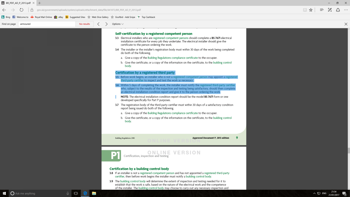

There are two classes of people, and only two, who can certify to Building Control that the work complied with Part P:
  1. ...
  2. A registered third-party certifier
So if you did appoint a registered third-party certifier before work began - and note that "work" includes the design, why are you not asking them these questions? After all, you are paying them.

So if you did appoint a registered third-party certifier before work began...
And BTW, Curlew - if you haven't yet appointed one, you really need to crack on. Not only must you do it before you start the work, if that route to compliance is to work, there aren't very many - you might find it hard to find one.

He's using a registered 3rd-party certifier - what I meant was the OP should ask him these questions.
