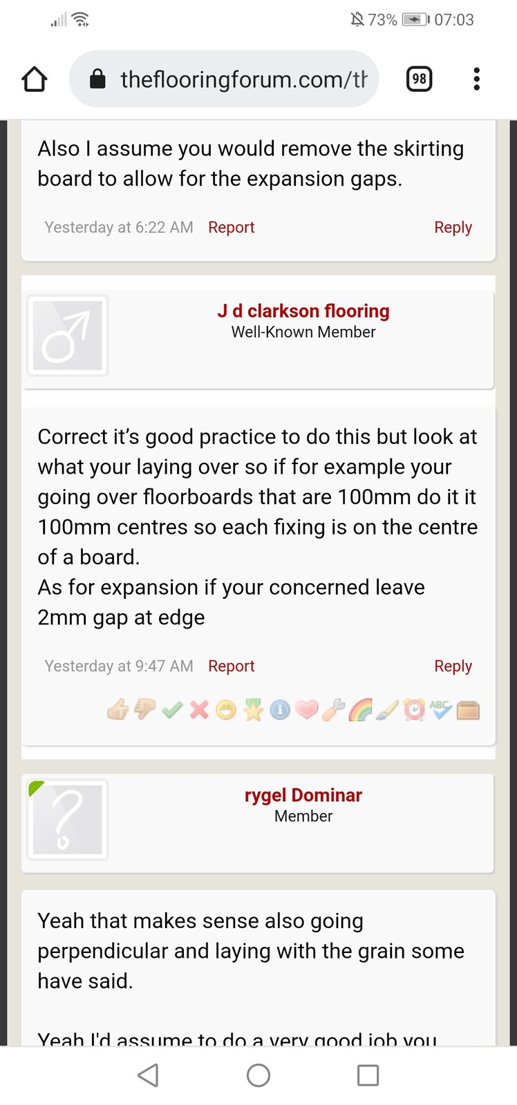

Can you explain this a little bit more how would I know if the screw os pulling the sheet good enough.. I assume jack off you mean like some kind of lift or height difference between the then 2 ends/edges of the ply sheet. And tight refers to the sheet being flat but it's been a very long time since woodwook for me as its not my trade I've forgotten most of it lol.
Also someone else said this.
"Correct it’s good practice to do this but look at what your laying over so if for example your going over floorboards that are 100mm do it it 100mm centres so each fixing is on the centre of a board.
As for expansion if your concerned leave 2mm gap at edge"
"Center the board " as in floorboard or the ply sheet guess both obviously i would need to measure my floorboards width to know.? Right? ObviouslyI need to know then width of the floorboards and ply to choose the correct screw as I'm sure hitting a pipe or electric cable isn't much fun lol....I don't think they have done this either just looks they used what ever nails they had and what ever length.
Also I lay the ply sheet going in the same direction as the floorboards or joist?

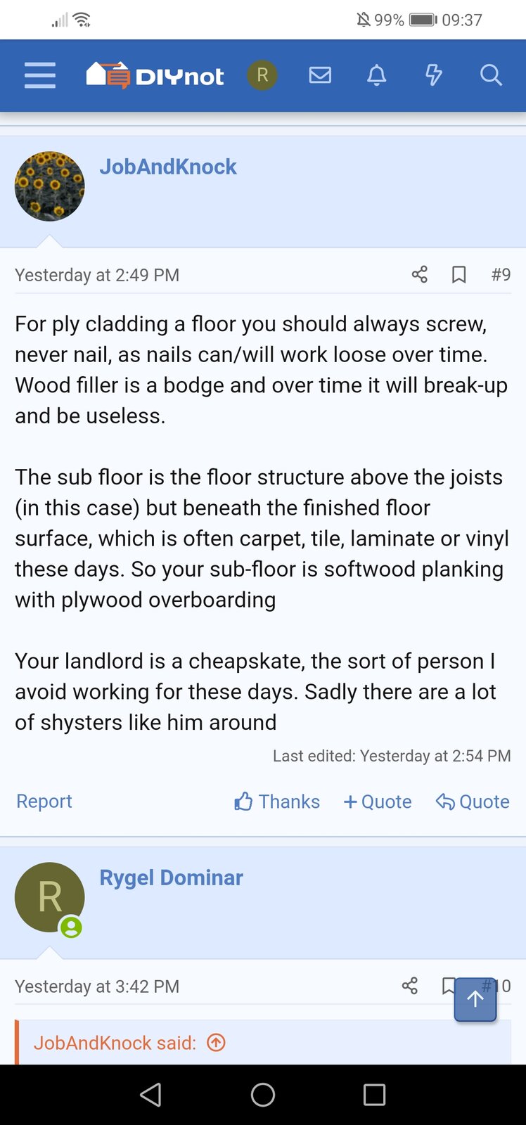

Really? The standard is 150mm. Never seen a proper tradesman do anything other than that. And in any case, why the centre of the floorboard? Why not the centres of the joists? (which might make more sense - see below) How do you achieve that with random width boards? (they do exist) That "100mm" is an arbitrary measurement, when the idea is to have overboarding which is fixed down consistently, regardless of what is beneath it
That would work well with vinyl or lino, wouldn't it? (it wouldn't) The "expansion gaps" would telegraph through the finished flooring as a series of unsightly lines. The fact is a pre-existing floor in a dry, heated house doesn't expand or contract much, neither does plywood, so there is no need for the gaps in plywood if you fix it down correctly - if you were installing an engineered floor over a concrete sub-floor on a ground floor with an 18mm plywood over board then you'd have a different set of considerations. But you aren't. Sounds like someone is confusing the two, or is thinking about timber frame houses in the more humid states in the USA - but I'm in England, and I as this is a British forum I assumed were, too. And why 2mm? Again, a pretty arbitrary measurement. Why not 6mm or 12mm?
No, you need to know the thickness of the plywood and the original floorboards to calculate the length of screw needed. So, 12mm plywood + 25mm floor boards = 37mm - nearest screw length is 35mm (screw lengths go up in 5mm increments from 20mm to 60mm for most manufacturers), and floor overlays are normally screwed down with 4.0 or 4.5mm screws (and sometimes 5.0mm), so you'd need 4.0 x 35mm screws or 4.5 x 35mm at the rate of 9 x 17 screws, or circa 150 screws, per sheet
If your screws (or for that matter nails) are too long you risk piercing any services running beneath the floor - messy if it's water, potentially lethal if it's electricity or gas. Didn't your other source mention this tiny little problem?
No, always at right angles to existing flooring, be it plywood or floor boards, and you lay the boards so that any end joints don't end up directly above joints between floorboards. The plywood should also be laid in a "brick pattern" with the ends of the plywood boards not making a straight line, but staggered, like the bricks in a wall. This may require that you have a circular saw to cut the sheets

Wood filler is a bodge and over time it will break-up and be useless.

Yes, because it will break-up over time, It's an absolute bodge job
I know it wouldn't thats just common sense it wouldn't have anything to stick to the confusion seems either when laying hard wood or tiles take the skirting off then the gaos hidden or what the Americans do is just have ply as a main walking floor like we do with floorboards again doesn't help when your trying to learn but it's my only source but don't you get mad again lol if any of thats wrong i obviously think your advise is worth listening to as I'm taking time out of my day to ask you. And I alsi appreciate you don't have to answer so thanks.

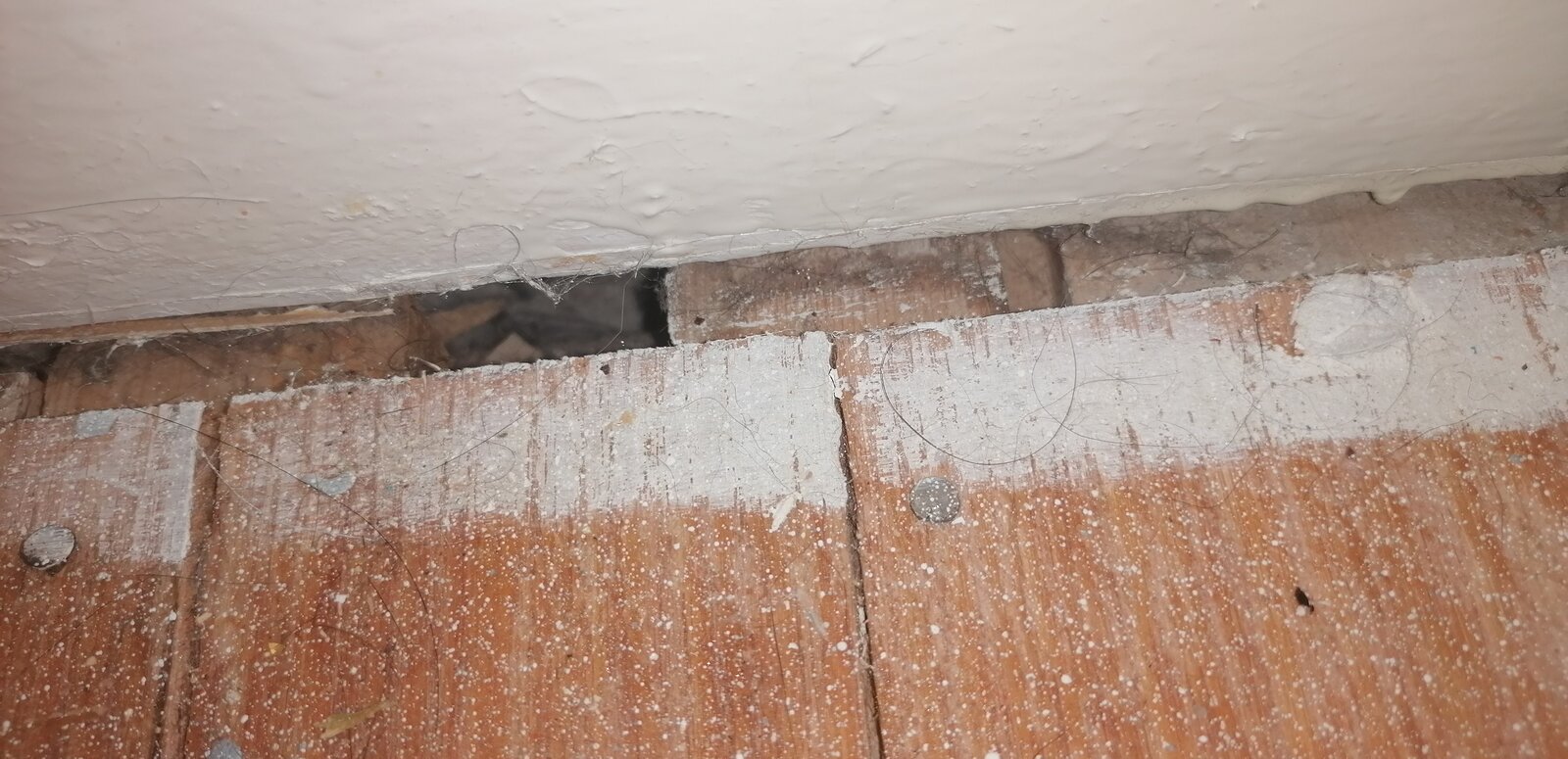

Gaps at the edges and between sheets with make the lino telegraph show through and leave water traps etc.

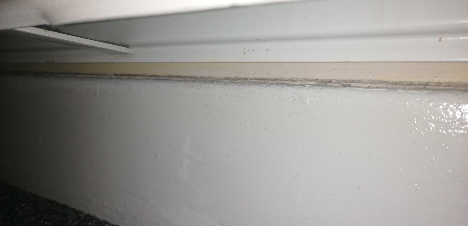

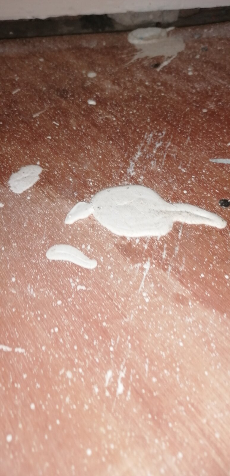

You can see with the ply sheet meets the skirt all the stuck in hair to the sheet and skirting its like that all over

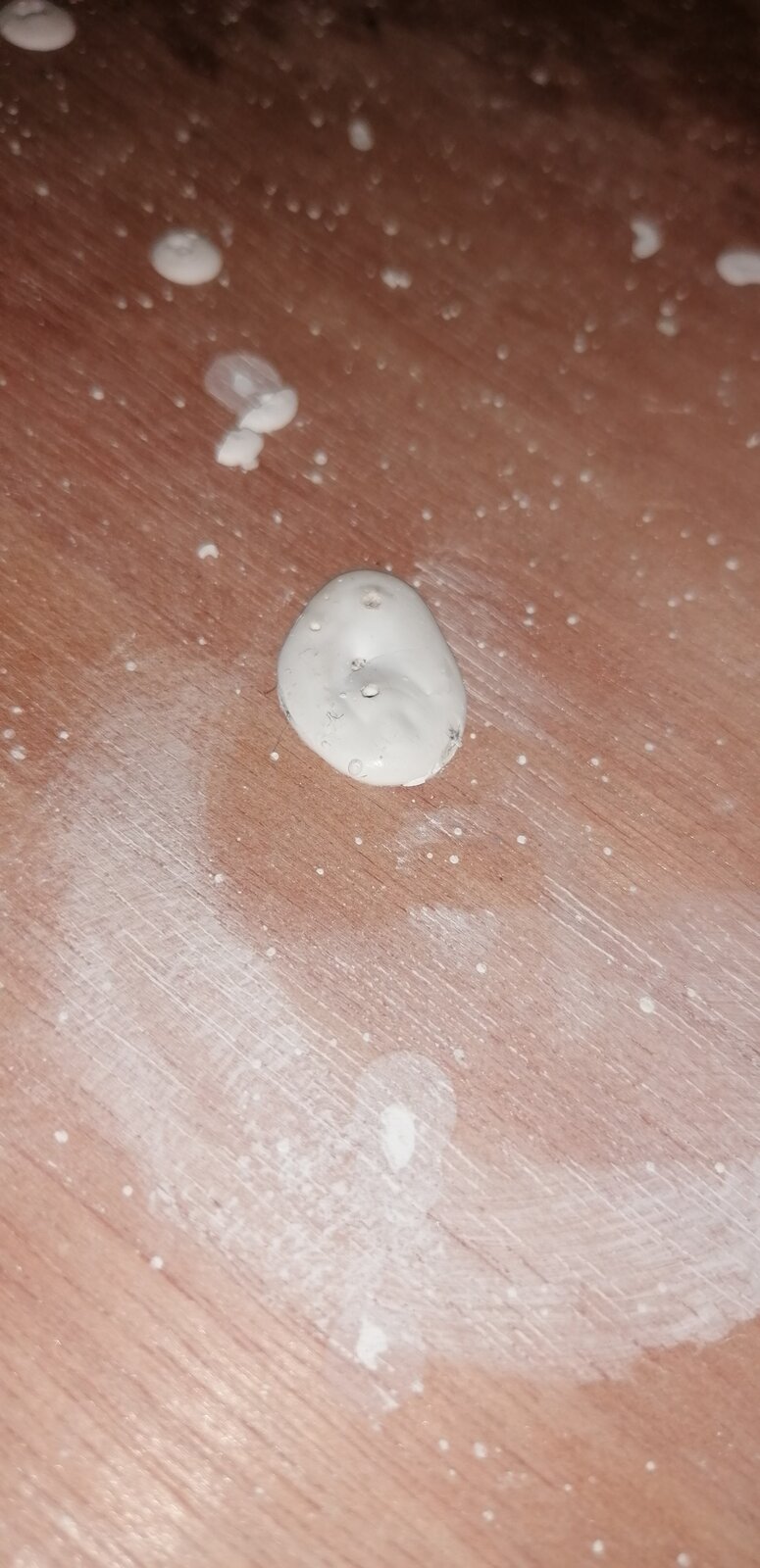

Yeah well I have debris and loads ( even have paint splatter on the ply great for flush lino right) again you said they need to came close to edges and were the sheets meet as it will telegraph and show through the lino. You'd think they would know this i think that assumption is fair if your employed in that position.
I would see an optician for an ear infection lol but jokes aside it will be a case of shot the messenger but if the roles were reversed lol peoples double standards are amazing don't you think.
just like say dyed paint splatter and random nails/screws

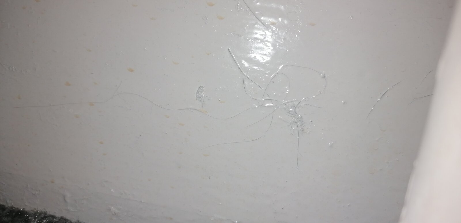

and loads of hair stuck to the ply and skirting boards this is never done from my experience and I'd always hover as a brush doesn't get it all up.
You should see my paint job hair stuck everywhere to the skirt paint all over the toilet basin etc I digress lol seems the quality of work goes down hill if they know they can get away with doing it half arsed how doesn't prep wall for paint and sand and clean glossed doors or skirting boards.
If i went to say a new fancy build to compare or a homeowner home to compare I bet you the standard of work is 100% better. And the only difference between the 2 is (money) bricks are bricks paint is paint but the standard of work would be totally different.
When you get hair all stuck to it and can see the old colour still coming through even then getting it all over the fixing and fixtures how that was signed off i dunoo and it would off stayed signed off if I hadn't said anything.

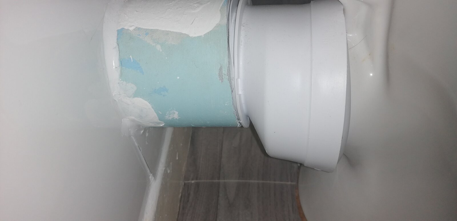

In the pictures with the radiator just a few to give you reference because they either didn't want to bend down or thought no one would notice they just stopped paint the skirt and behind the radiator lol also gloss os peeling due to not being prep'ed also I think they've used a water based gloss on oil based as its going yellow already the main paint is some cheap water downed while emulsion as i can even see the paint lines lol.
If it was me paying the invoice I wouldn't of not at that standard of work. I don't think many would if it was there home lol and I will be hated because its fhe truth lol Orwell lol but why does there such a massive difference in quality between say soical and some homeowner one a owner has more control over who they choose. Again walls are walls paint is paint it's the quality should be universal.. Not like say del boys 3 wheller compared to a ferrari a wall is a wall you'd think.
