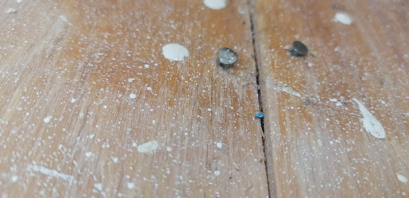

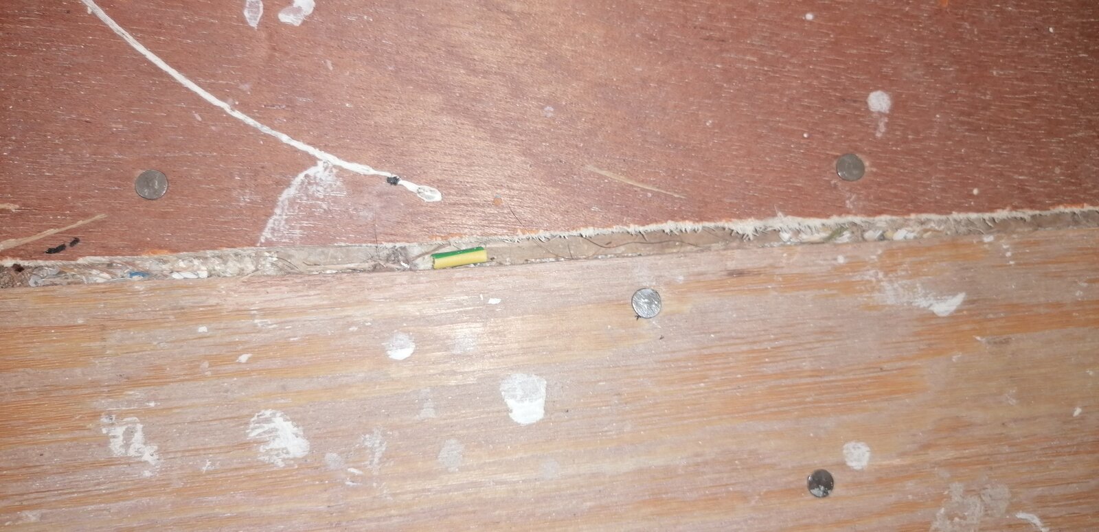

Now the white goods have been moved it just gets worse more nails that have bent but just hammered down anyways again look electrical wire and screws and hair so much bloody hair defo they cleaned prep'ed the surface this is why I'd brush then hoover then hoover again but again I've hot high standards thats just me. I'll just hoover but it obviously needs to be re done before they lay the adhesive /after and i between works.

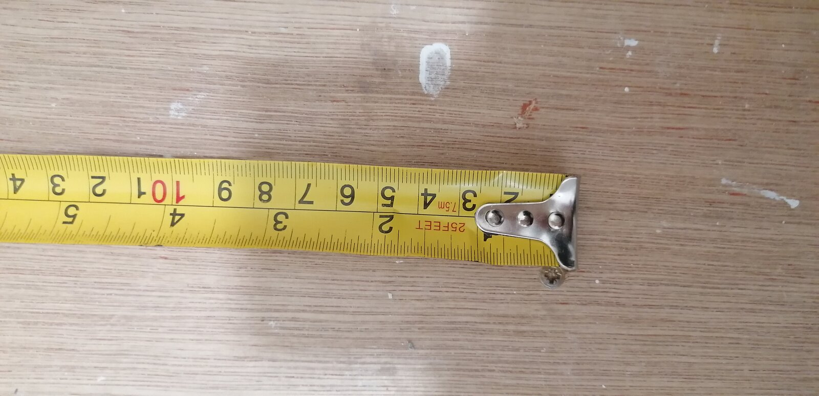

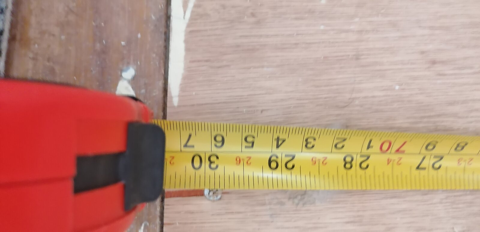

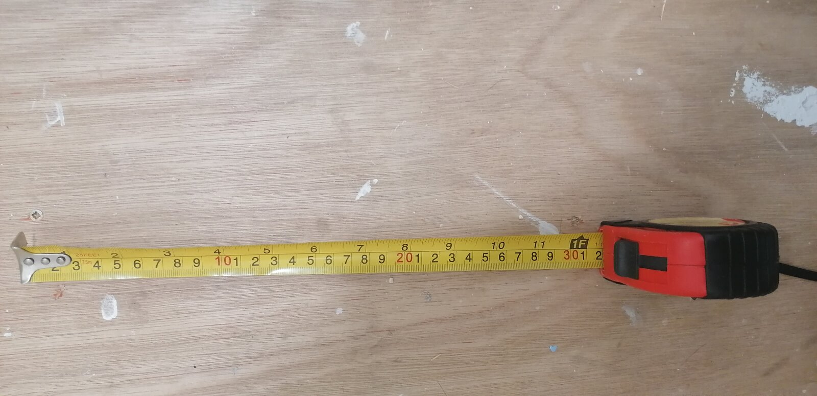

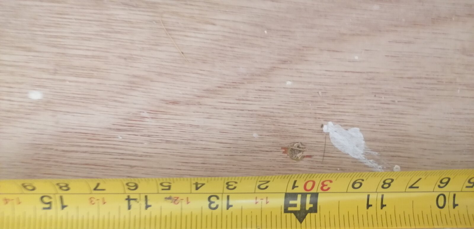

Again knock bathroom doesnhave screws but no 150mm intervals look just a example first at 0cm then 31cm then 76.5cm

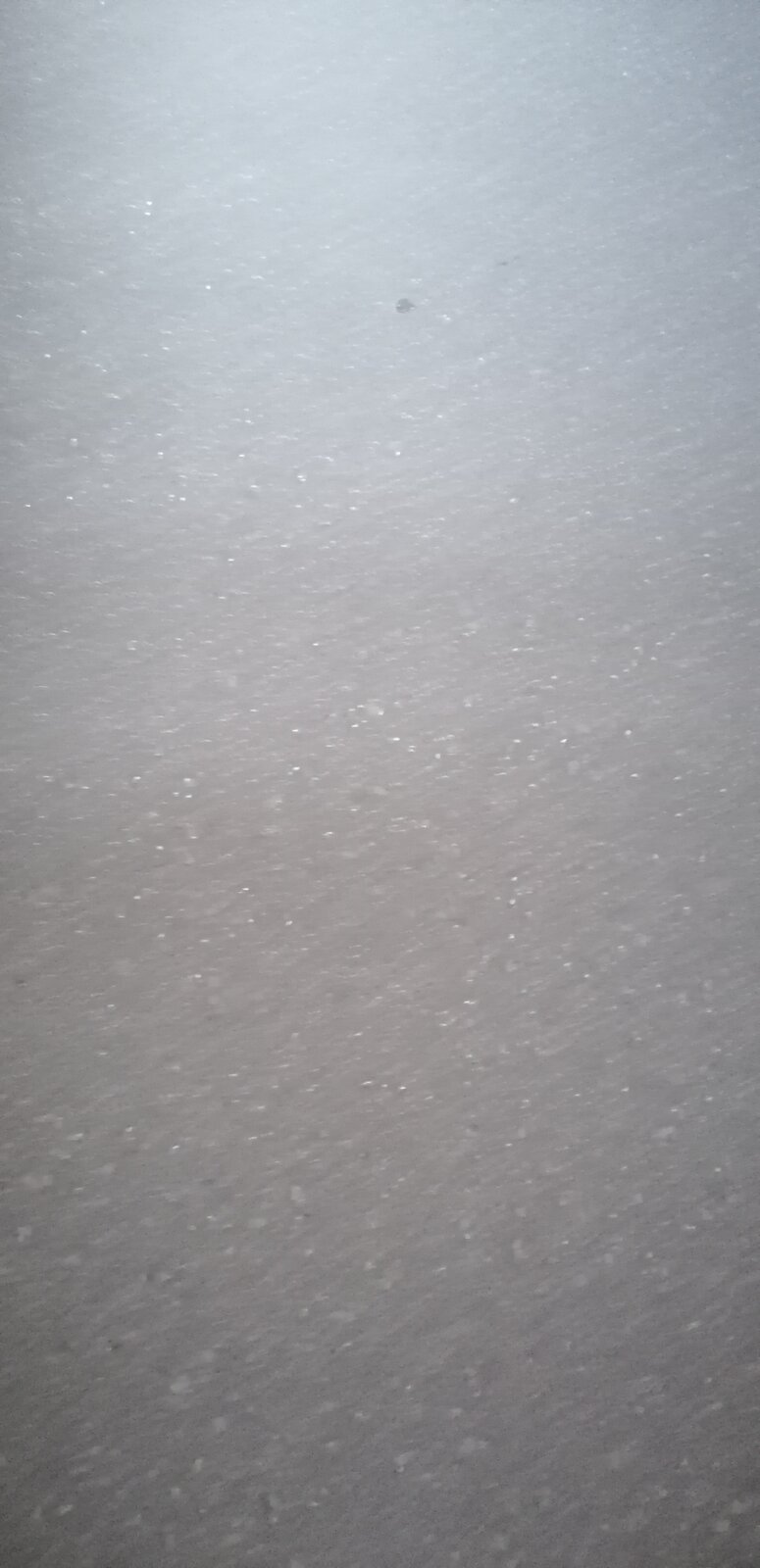

I've found information that confirms first that I can use self leveling compound on ply.. So check
Can I then lay vinyl ontop of this... Checked.
"Because the self-leveling compound creates the equivalent of a concrete subfloor, your new floor type must be one that uses an adhesive or mortar for placement. Laminate, vinyl or another layer of ceramic tiles are all compatible flooring types, as are glued-on hardware floors."
My Apologies I had to check as I was advised I couldn't level out the slope with a compound.

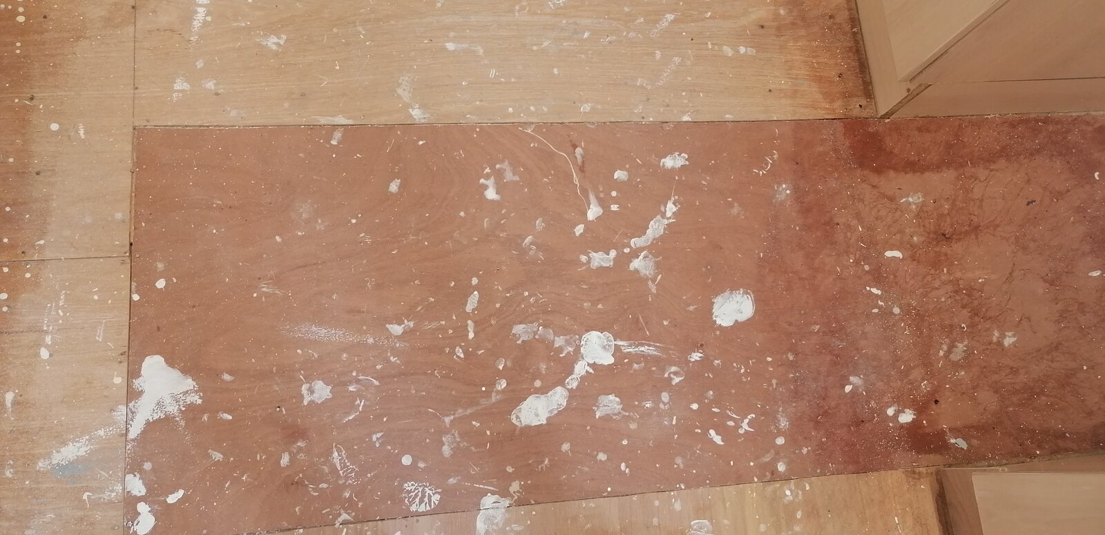

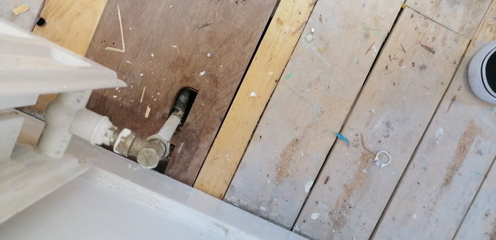

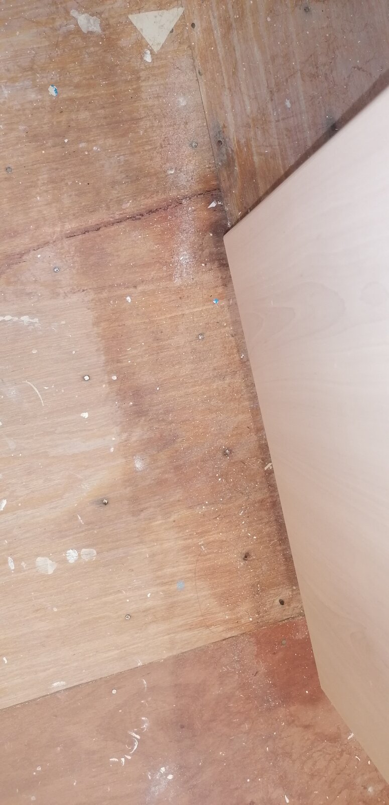

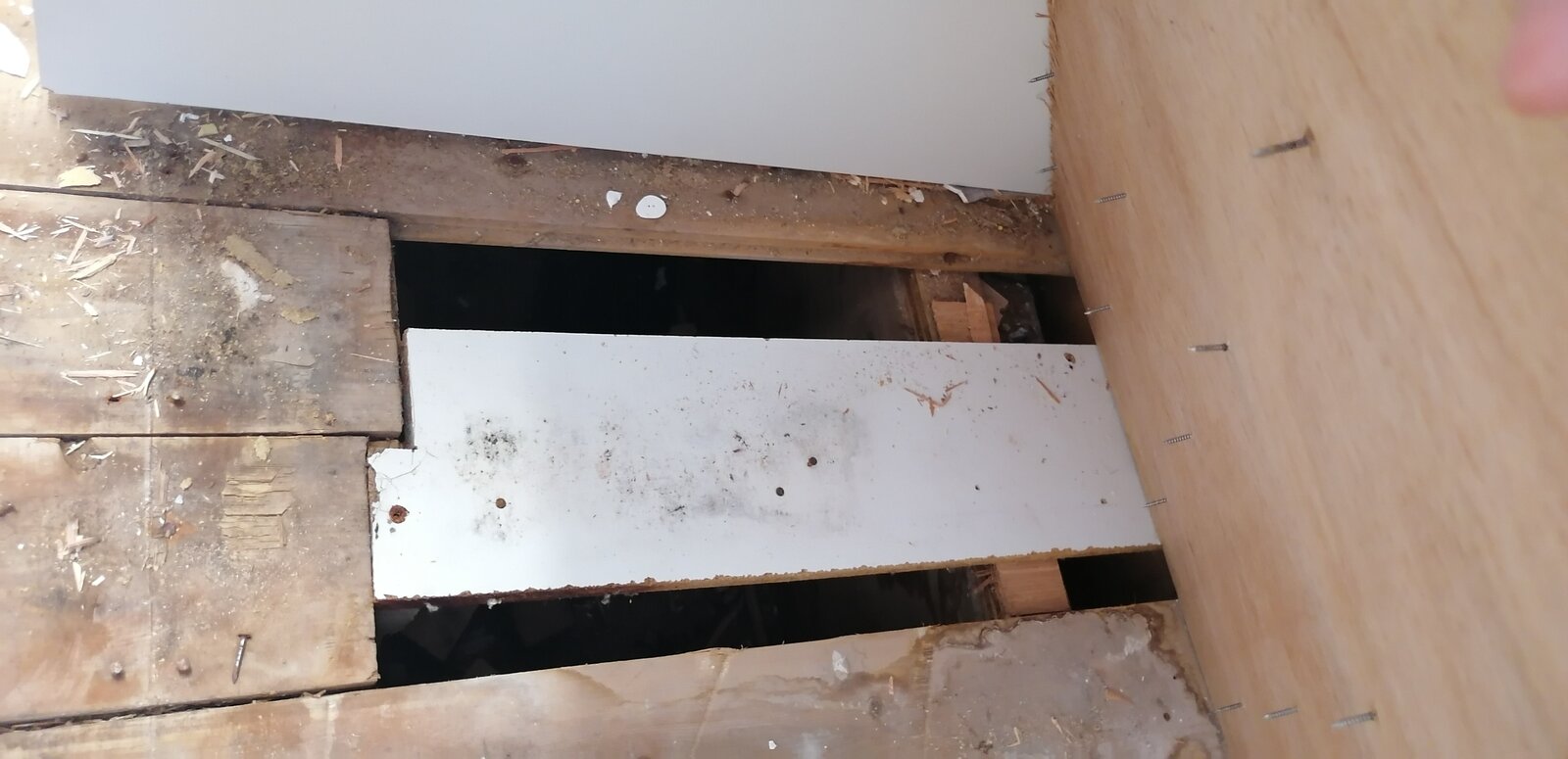

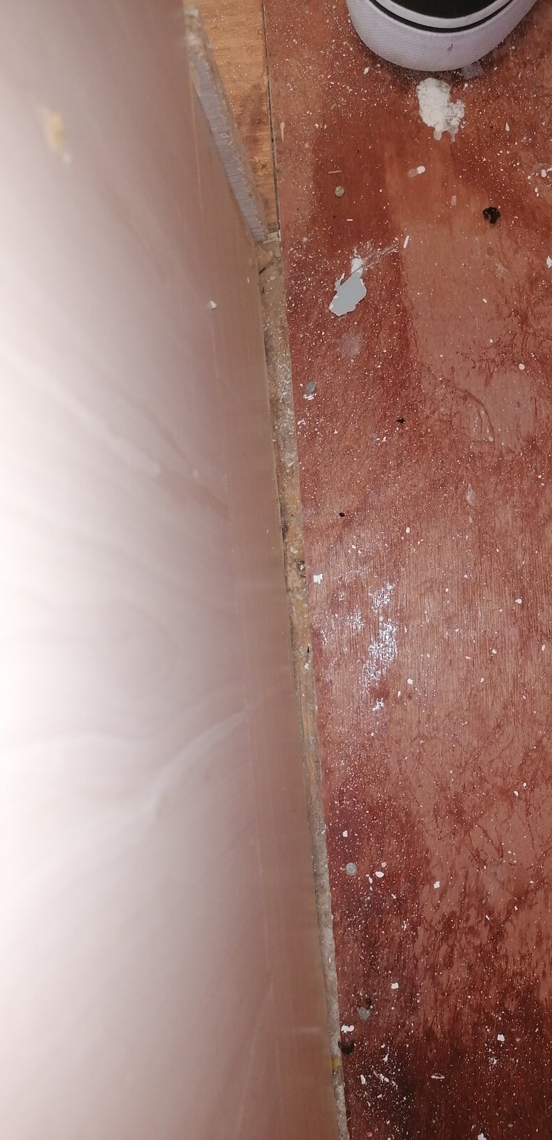

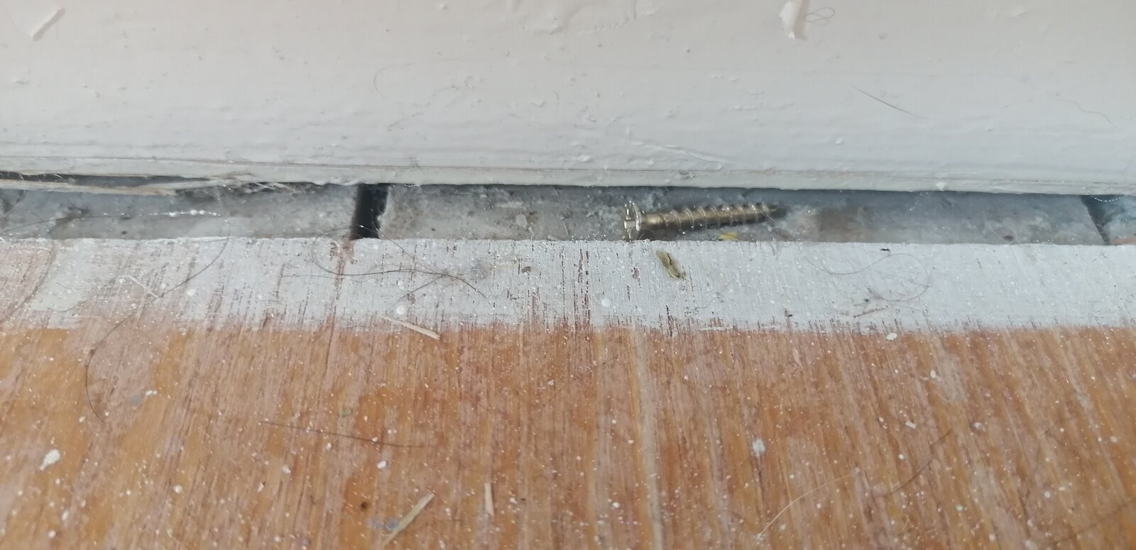

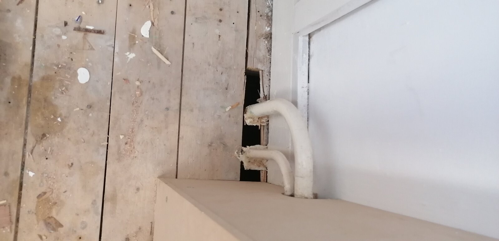

So you asked for some pics after okay after the guys were given the okay to lift the ply the floorboards were/are a mess.... You would have thought that would have called the job off so it could be fixed as obviously all the issues are going to effect the vinyl flooring once down and also just floor safety. Nope!
Also so things don't fall through it. But guess they weren't a just told to carry on. Their work is okay with the orders they had.

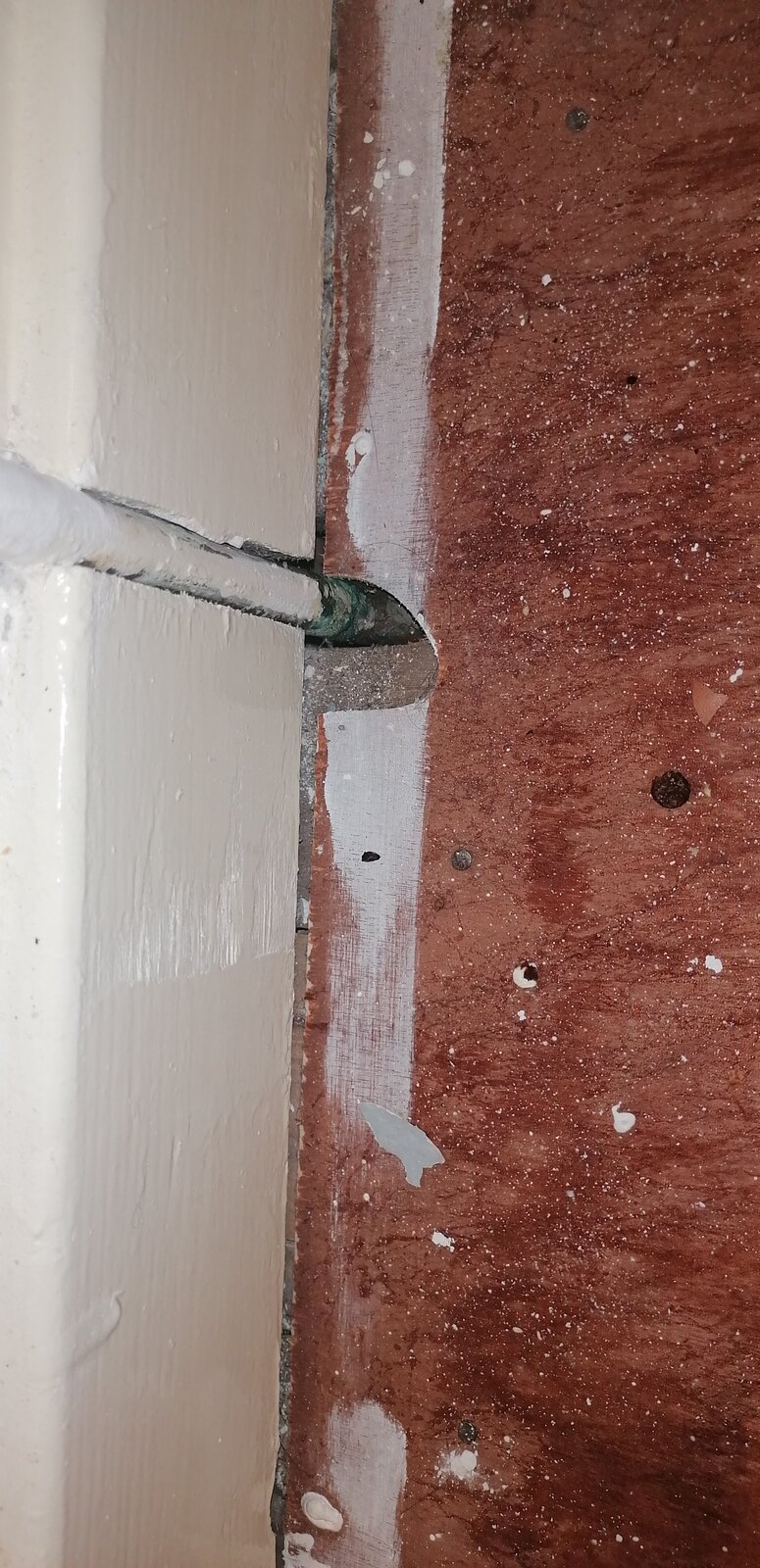

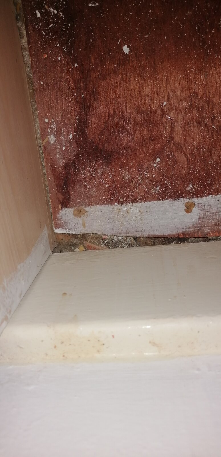

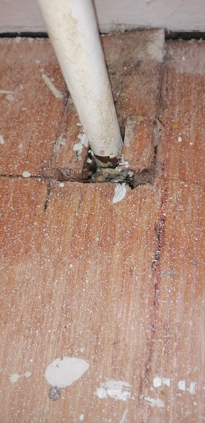

I had some issue with holes around pipes which having no floorboard the ply had nothing to stick to to sit round around the pipes guess the guy had never heard of a profile gauge or even paper lol jokes aside. So the ply had nothing to stick/screw to so a make shift filler was made.
I also have dips due to having having no ply at all underneath by my kitchen door which has created a dip.

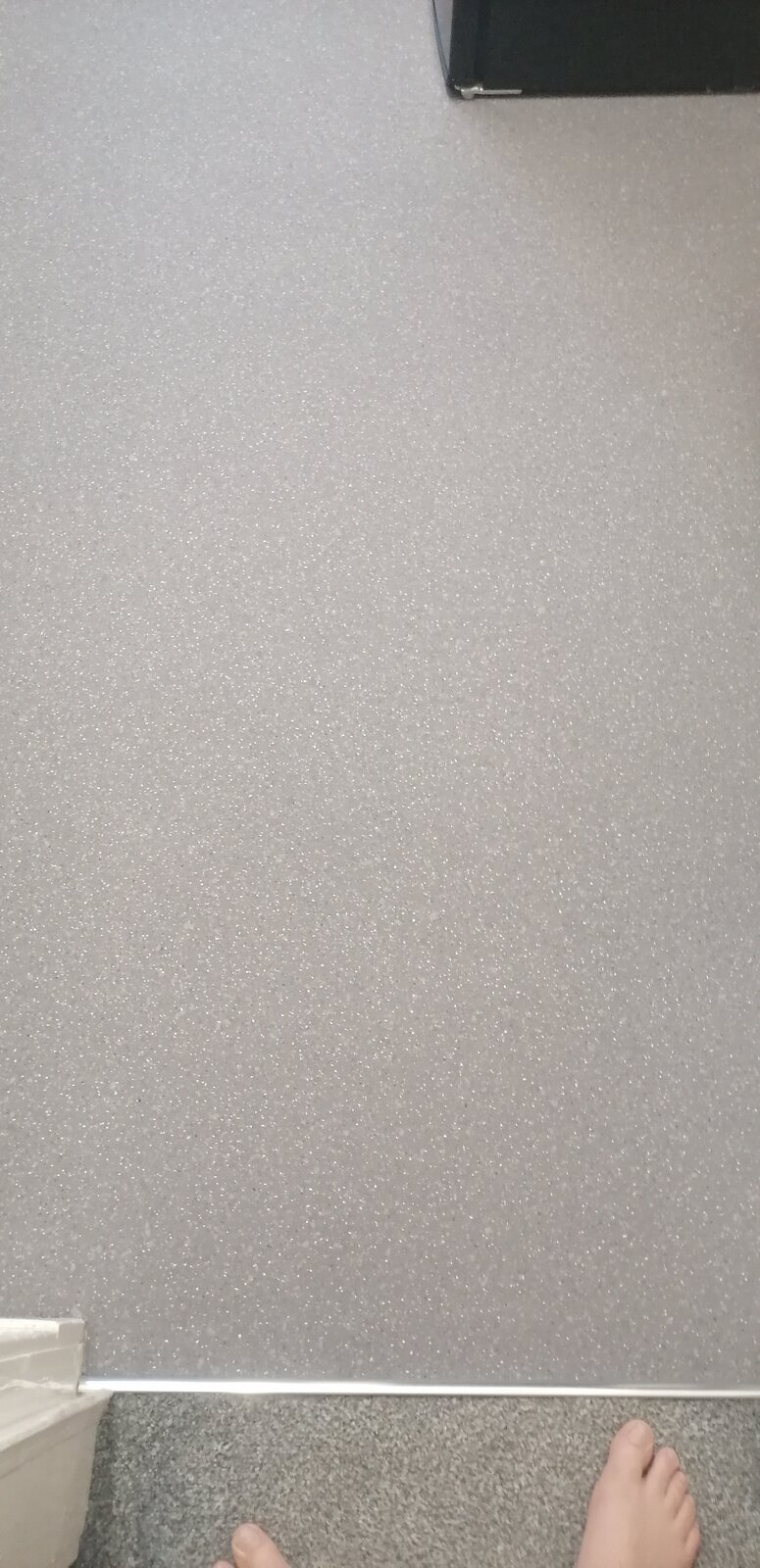

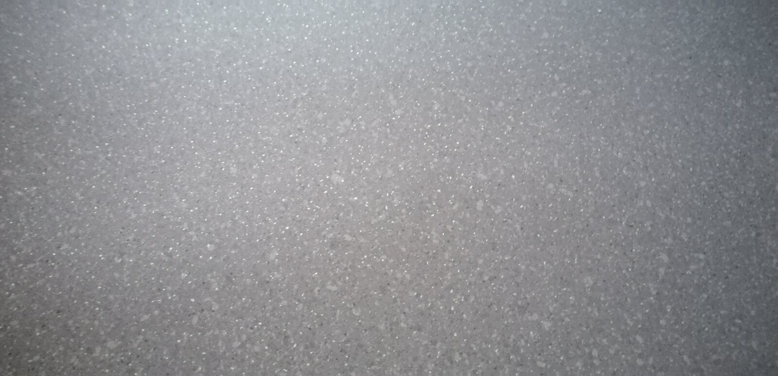

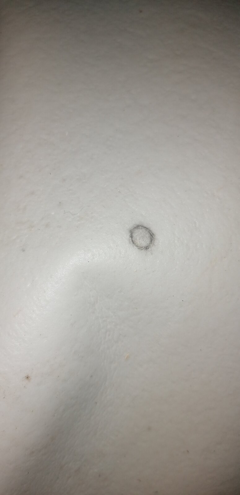

All of which has created telegraping which you can see in pics 6/7 those lines aren't shadows thats the ply outlines I can see outlines of the sheet and the floor bumps aka telegraping when the lights off.

But they had terrible subfloor/floorboards to work with and no my landlord wasn't going to pay to fix the floorboards that are still a mess just now hidden ... It's a very different standard when your soical they just want to patch over it... So it looks good on the surface...
They gave the go ahead for the pervious works that made the floorboards a mess all work gets inspected after remember so....
They said okay/signed off on the floorboards missing like that and I don't know why the floorboard is overcut like that by the pipes.
Seems who ever laid the work for the CH pipes made one hell of a mess and didn't know how to use a jigsaw I had some kind of cheap cabinet chipboard as a make shift floorboard it crazy how that held the weight of a 68kg washing machine with its concrete block inside. Lucky it didn't land on someone head below but guess there is still time

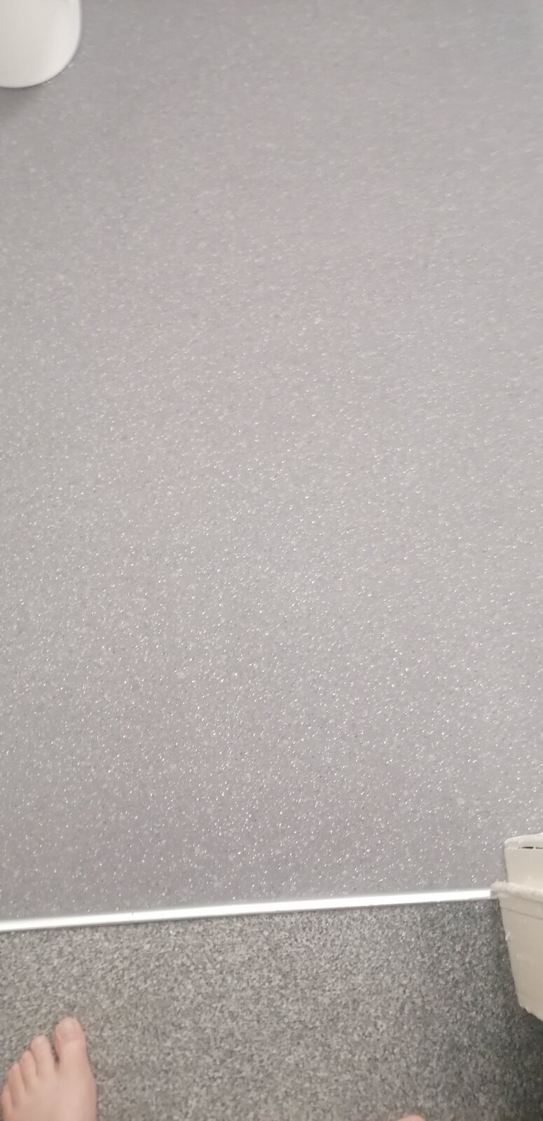

As per your request before after...
