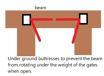

This may be over kill but if the gates are heavy then a simple concreted hole for the post may not suffice to keep the post vertical.
Also consider that when the gates are open their weight will be pulling the posts in a different direction
Under ground buttresses sounds very scientific.
What are these, would they be spikes?
running a concrete "sill" or beam between the two concrete bases for the gateposts (preferably with reinforcement) will prevent them leaning together under the weight of the gates when closed. A wooden lintel between the tops of the posts will do the same, and will reduce the tendency to rattle in the wind. It is not, as people often think, just an ornamental feature.
The concrete spurs in the diagram are to prevent the posts leaning backwards under the weight of the gates when they are open.
If you are laying a concrete entry or drive, tie it in to the concrete post fill with reinforcement, and it will do the same. It needs to be a monolithic structure.
