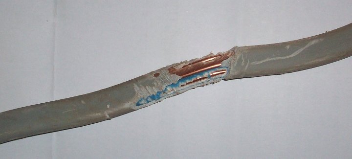

Getting my bathroom redone has turned out to be a cursed project. Every few days something else goes wrong.
The new pipes that lead to the bath taps started leaking overnight, dripping through the ceiling below. Fortunately ? the floorboards are still partly up so I could see where the leak is. Conveniently there are a lot of electrical cables directly under that including this one that has been chopped at some point. Not by me!
Surely if it were live it would have already caused a problem, right? Especially since it surely got wet last night?View attachment 309754
To me the wire looks like it’s been chewed by a mouse or rat.
I'm pretty sure it hasn't been chewed. There's nothing else to suggest rodents anywhere. We had rats in a previous place and it was really obvious they had been in there, not least because they made such a racket.
It doesn't really to me- it looks as if it has been roughly cut, either deliberately with pretty blunt tools or accidentally with some sort of saw or suchlike. Either way, 'the other end' ought to be somewhere, but it sounds as if it might be hidden from the OP's sight.
With rodent damage, one almost inevitably sees 'teeth marks' along the nearby bits of fairly intact sheathing, not just a 'ragged cut', and I've personally never seen a case in which a rodent has nibbled through the conductors as well as the insulation and sheathing.
This is more typical of rodents ...
Kind Regards, John
Yes, when we had rats before it was really obvious. You could see the tooth marks.
In any event I finally was able to go out and buy a voltage detector and none of those cables under there come up as live. I'm not sure I trust that completely when it comes to the better insulated ones but the cut one doesn't set it off. So I think they must be left over. Obviously I'm not going to go cutting into any of them just in case but it seems that it is ok.
That's certainly 'promising' even though, as you say, it does not actually 'prove' anything
Yes, as said before, it's almost certainly 'OK' - but, again, there is no totalcertainty of that.
