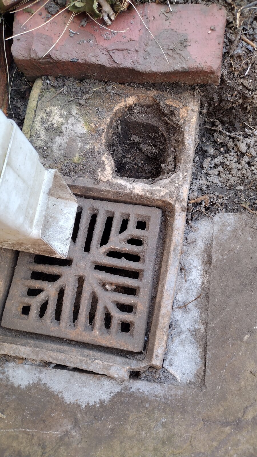

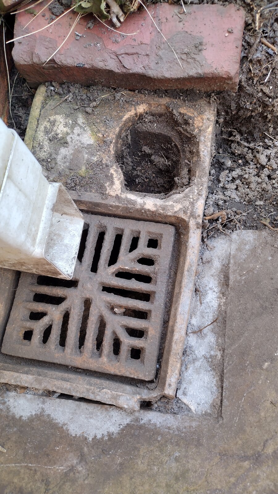

Been clearing the front garden, and I noticed the front guttering down pipe was draining onto vegetation. I investigated further and under this vegetation was a gutter which is completely blocked with soil. I've managed to completely clear around this drain, got the cover off and removed around a foot and a half into the drain, but there is still alot of soil. The only thing that drains into this is the front gutter down pipe so I assume this is just surface water drainage. Is there an easy way. To remove the remaining soil, or is it just hard graft. It's likely been like this for a long time and we've never had any water ingress issues. Any advice

As said above, the soakaway drain has reached the end of its useful life. Probably a decade or two ago. They can be prolonged with a trapped gully at the end of the RWP.

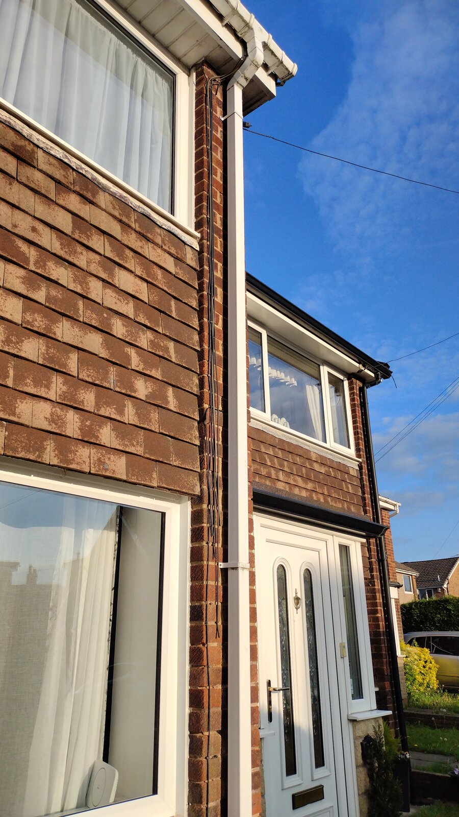

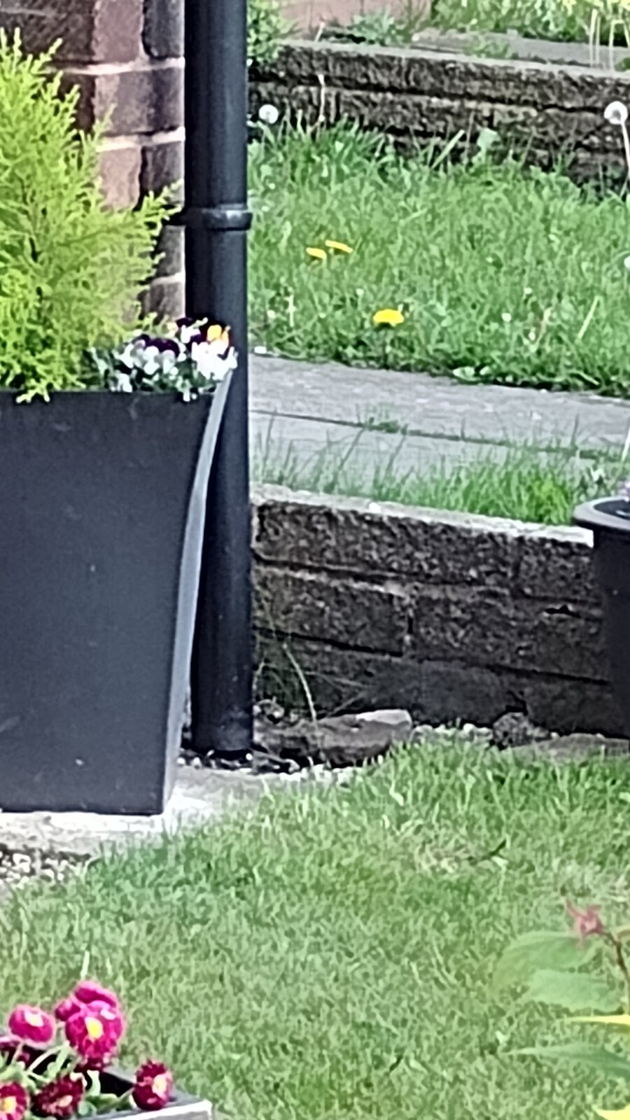

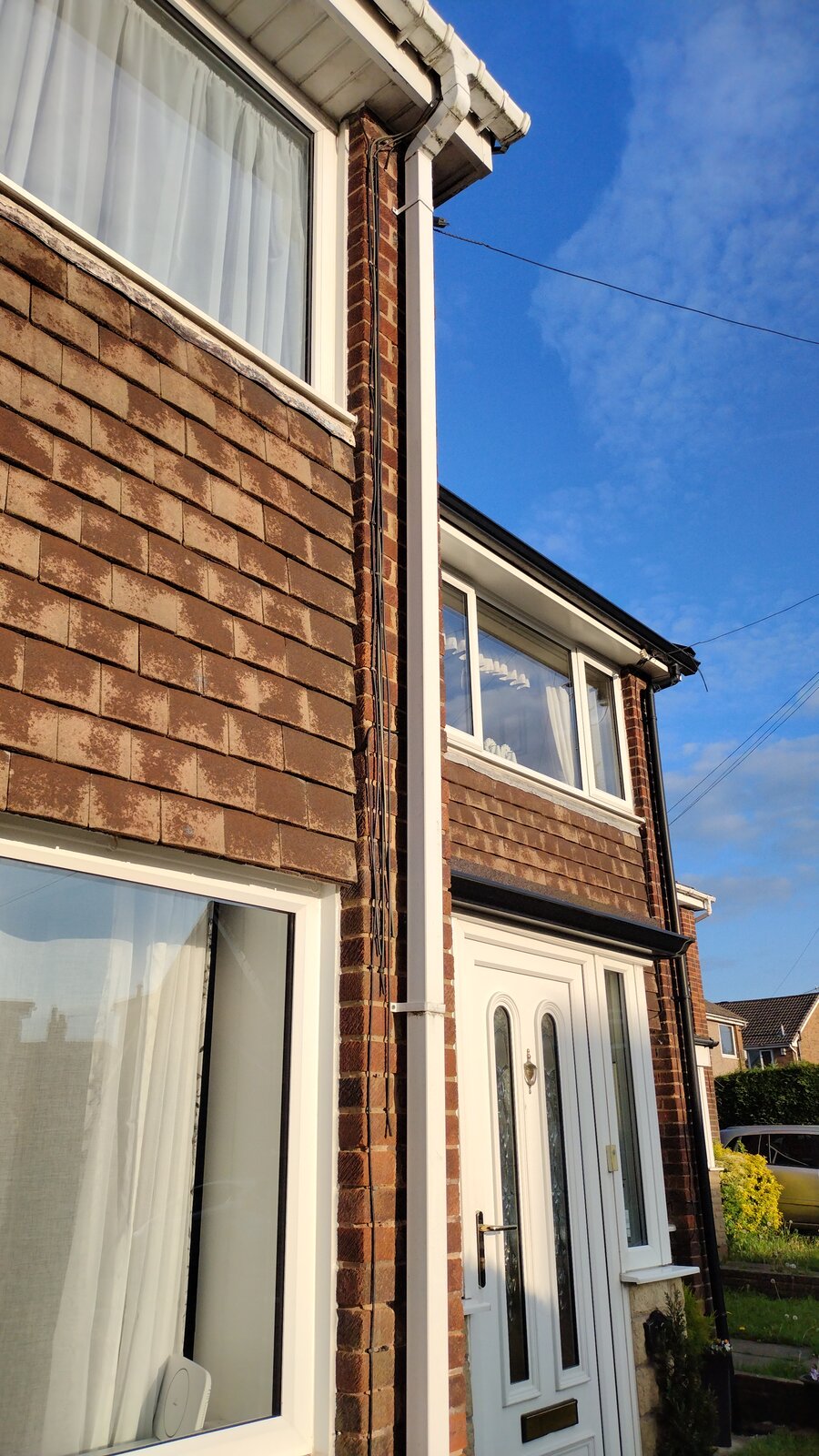

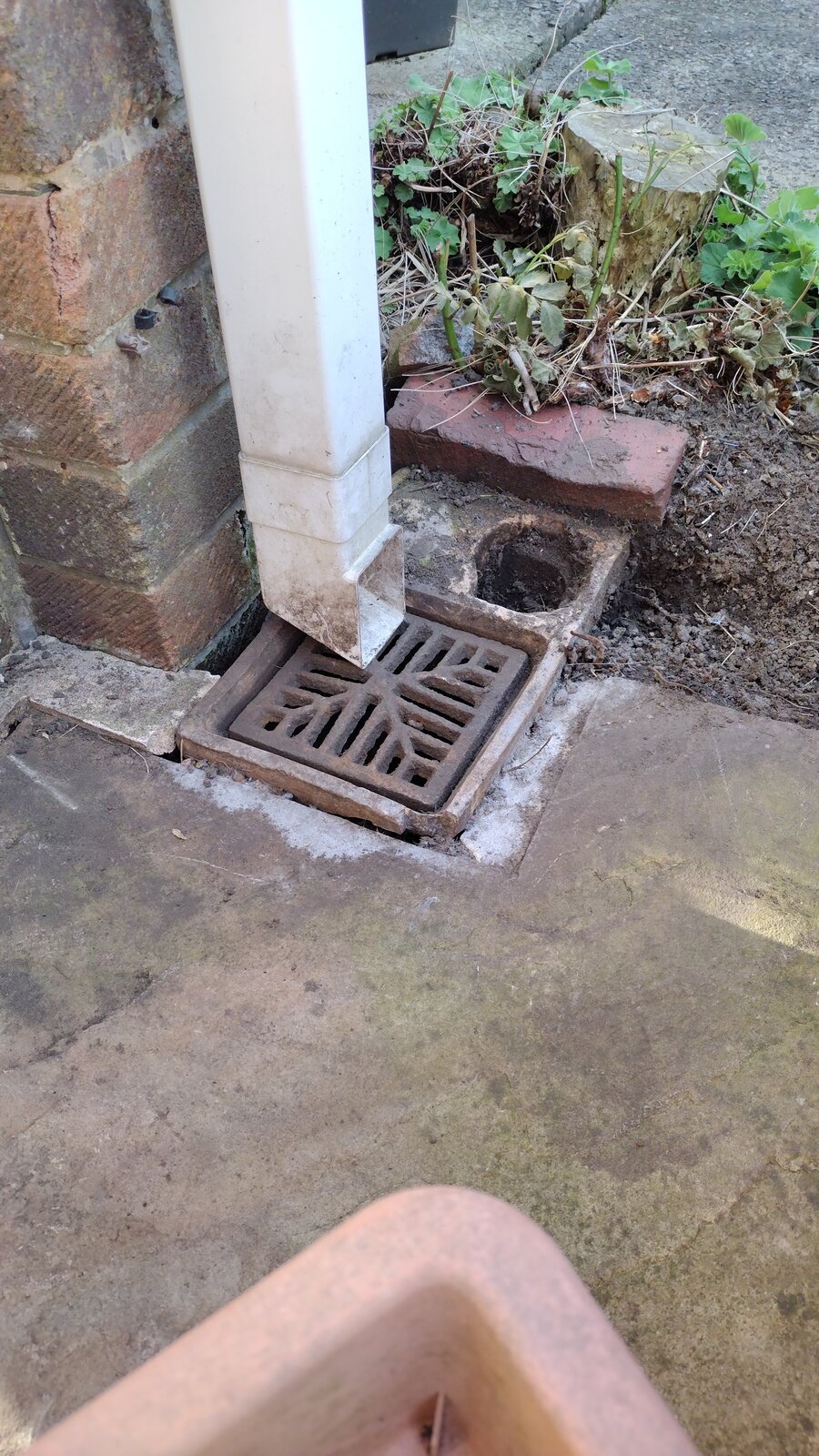

I've attached some images. Where the grate is was completely overgrown with plants growing out of it. I've cleared all this and cleared around a foot and a half down the drain. We have never had any issues in this area with damp etc. I assume it drains into the street drain or into the garden somewhere. I presume it's my responsibility and not the water companies, but would the water company know what it was and where it goes. As I've never had any issues in the nearly 20yrs of living here what's next??

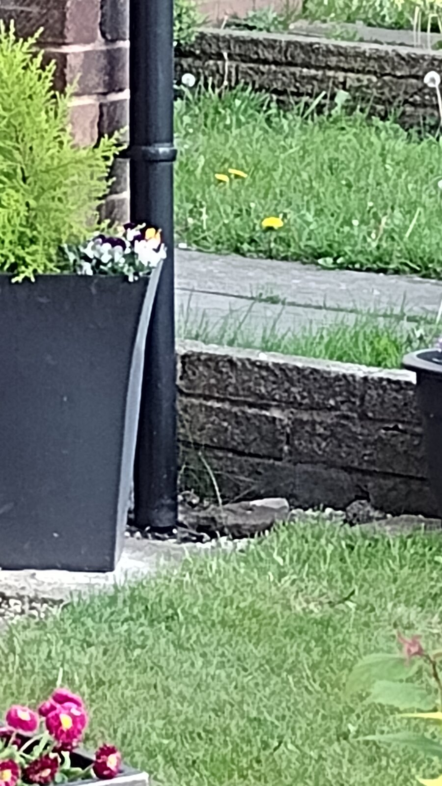

House was built in approx 1974. The black drain is next door. Would they drain to me
We are a small row of terrace houses (4)

I'm not quite sure why the previous posters are assuming it is a soakaway, house of that age would typically run into a mains in the street. It's not unheard of for a drain to fill up with crap off the roof etc especially if poorly maintained as is the case here. I would get some drain rods and start having a poke about. If it only serves your property it will be your responsibility https://draindetectives.co.uk/blog/who-is-responsible-for-drains/ , if you speak to your water company they will send you a map of any drains they have mapped though water company drainage maps are notoriously inaccurate but see what they say. You can also speak with your neighbours, they may be more savvy as to what's what ....

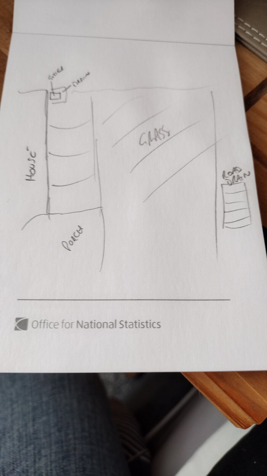

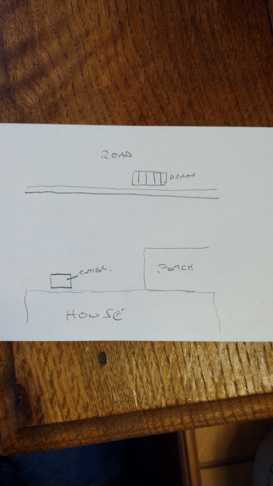

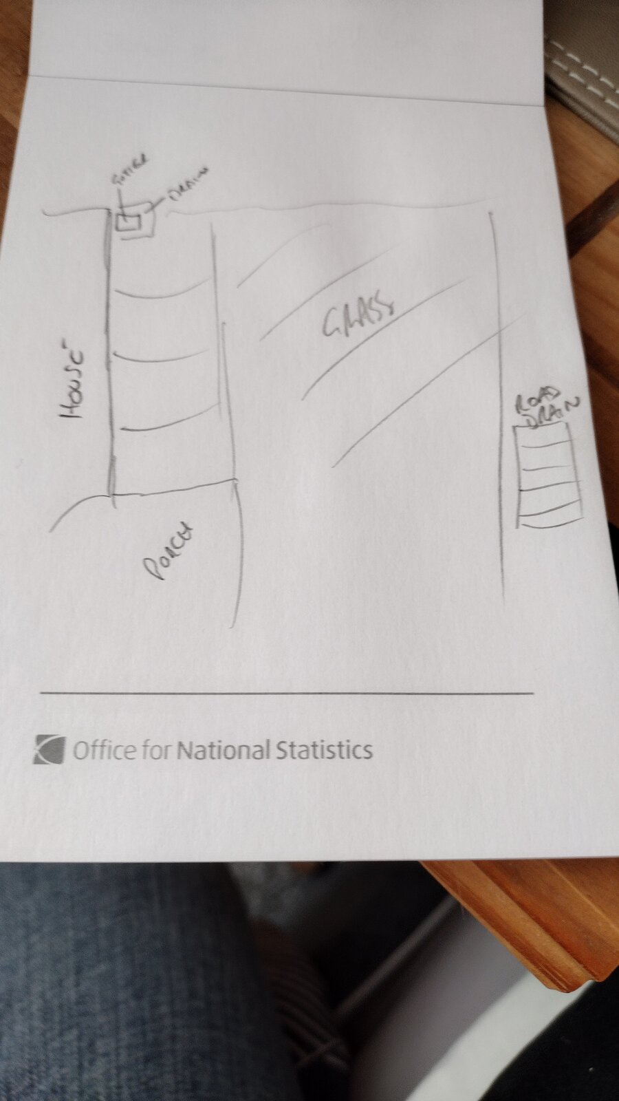

On the boundary between my garden and next doors are alot of bushes, possible they have infiltrated in??? . I've had a read regards soakway, not sure I have one as garden completely dug out a good few years ago to lay now turf and paving, nothing was said. The main surface water grain runs along the kerb outside the house as on the diagram. I had assumed that the gutter water was just draining through the soil. Any ideas of easy ways to get rid of soil, as I'm almost up to my elbow now. I'll contact United utilities.

Does the drain, where you have has your ar down, appear to head directly towards that manhole cover, which you describe as a 'road drain'?
I suppose. It's not directly opposite. Posted a picture
