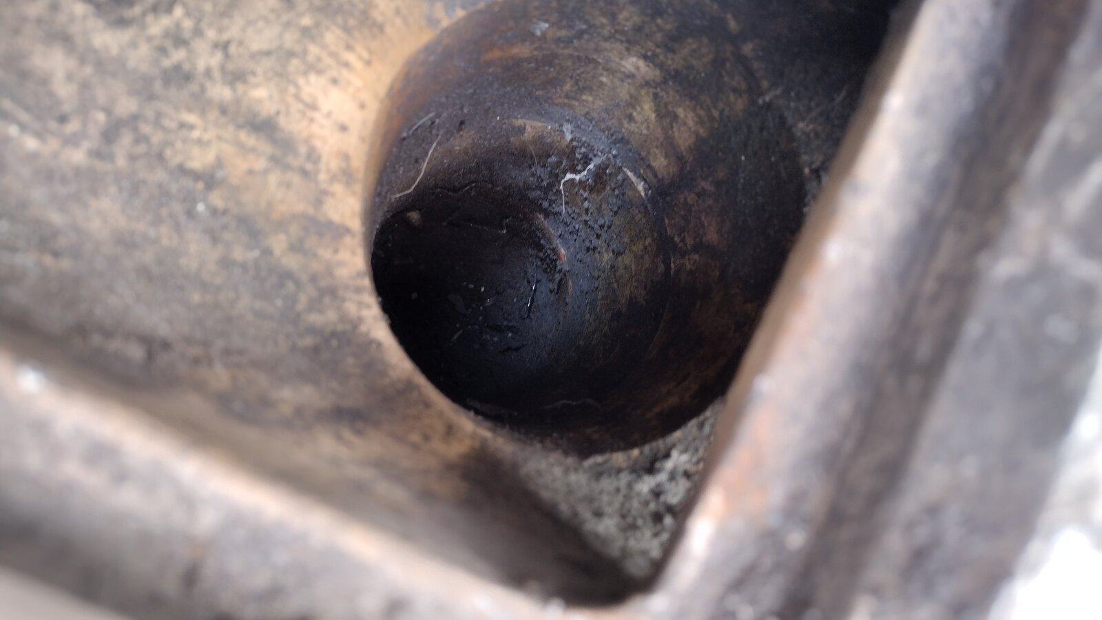

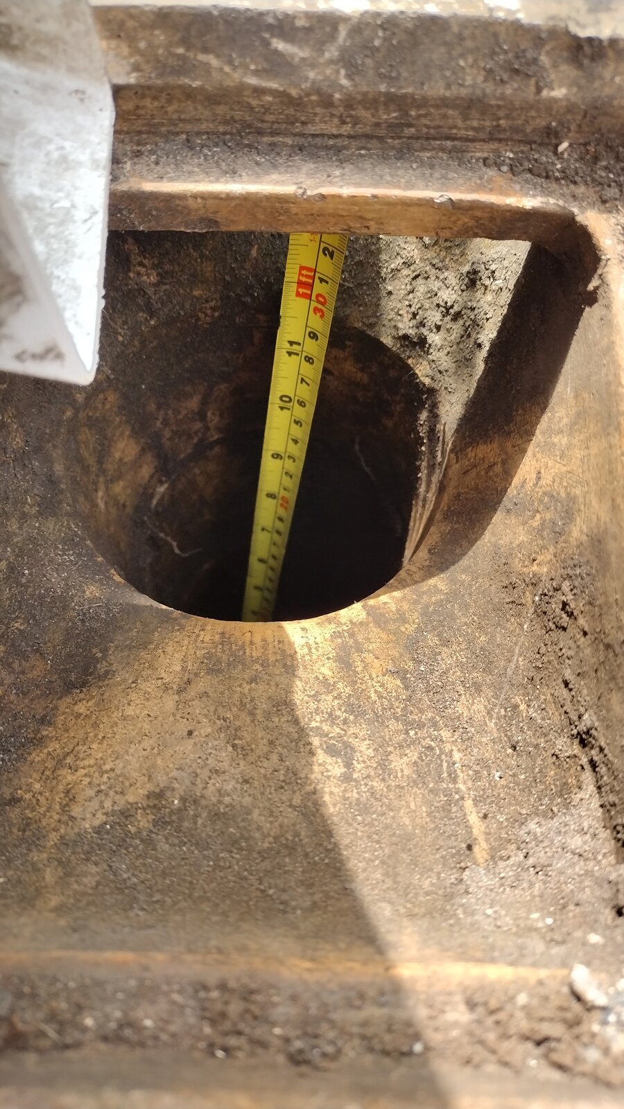

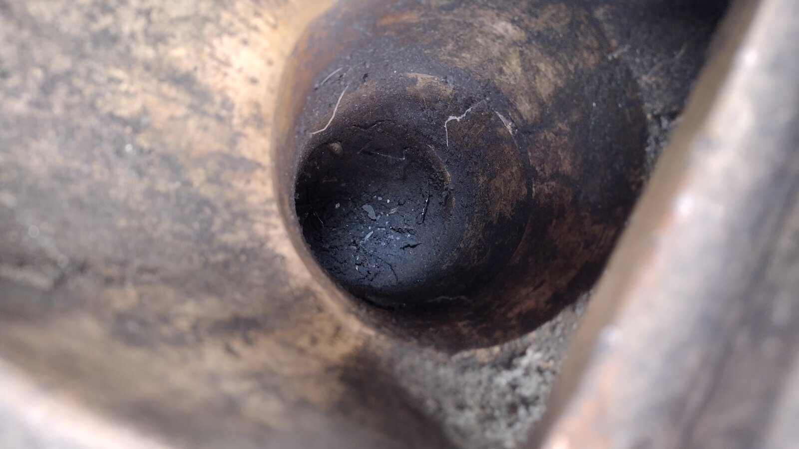

That seems to be the case. I'll post a picture of the inside of the pip tomorrow. I was scraping out lots of gravel at this level I've got to.
Would agree with freddiemercurystwin that a surface water pipe is unlikely to be more than 2.5ft down. Are you saying the down pipe is still going down or stops at / near the surface ?

Thanks. I've attached some photos. Rather embarrassing but it's not 2 1/2 ft, but it seemed like it when I was digging it out.... So far down to the gravel its just over a foot down. It's still going down. I'm going up have to get something or some rods to see how far it goes down, and try the council. I do have the deeds and plans for the house but nothing obvious is marked on.

Ahh you mean you've been digging down inside the pipe/gully? You need to dig down on the outside to see where the pipe goes as (obviously) you can only dig so far down the inside.

The grate is surrounded by paving stones secured in place with concrete. Will be a pretty major task to get all these up to check where it runs to. I would have thought I would have come across the exit whilst digging down this far by now inside the pipe. I'll try rodding down further to see if I actually hit the bottom, or does it keep going down
I can see three options:
1. You give up and leave this as it is.
2. It is a blocked (probably dead) soakaway - fixing this will involve digging some of those up.
3. It is a blocked drain - fixing this will probably involve digging some of those up.
Why? The horizontal section of a pipe is very unlikely to be a huge distance down but it may start to turn from vertical to horizontal just another couple of inches down.
BTW, what are you using to dig out the hole. I would use an auger, something like this
I asked if neighbours gully looked like yours then could probably find out something about the layout by putting a drain rod down their gully. Have you done that?
