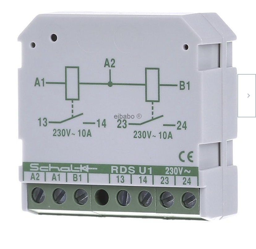

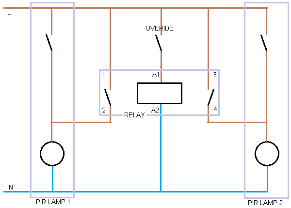

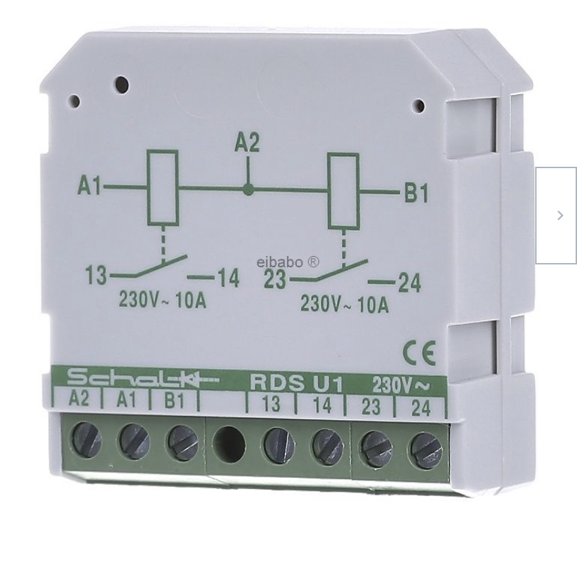

Thanks for diagram, so A1 live A2 neutral… is B1 not used? Are you able to draw on this photo easy for me to understand? Thank you
I believe it is, just trying to understand wiring, for the relay shown. Thanks
